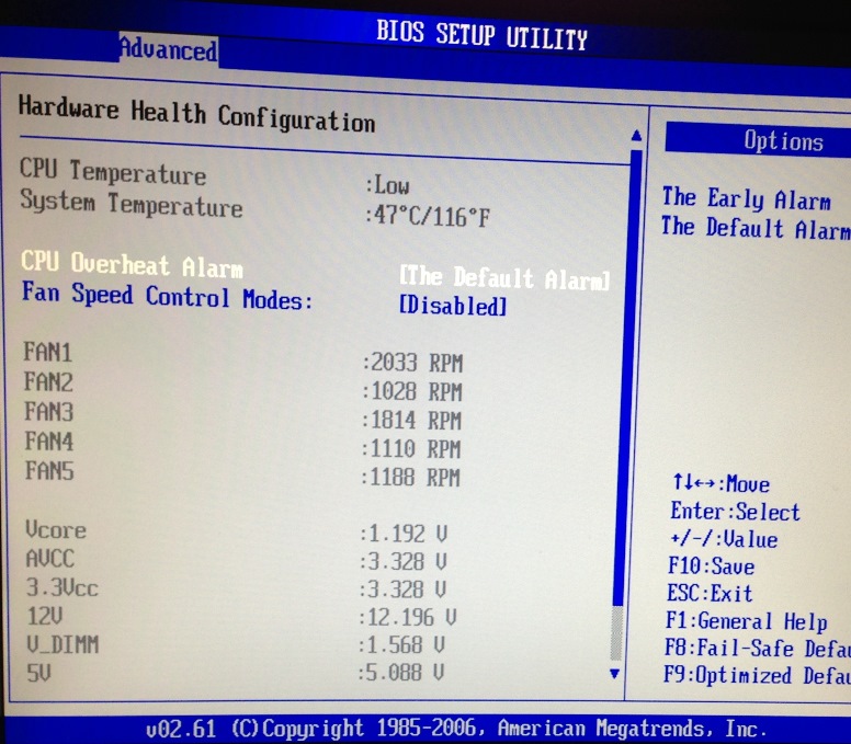

I can build us a proper functioning sensors with the right voltage listed for 12V and 5V. But I need everyone with a Asrock B75 Pro3-M board to send me a complete list of their voltages as shown in the bios. Please send me a text if you have this motherboard and I will post the sensor file this motherboard. Thanks.
FOR ASROCK B75 Pro3-M!!!!
EDIT: Nvm, thanks to some fortuitous issue with my bios, I was able to see the voltage flip between two points. It seems this gave me enough information to deduce the correct scaling factor (info on how to calculate it is here, In my case it was jumping between two points so it gave me the first part of the puzzle). I am including the code below so you can copy paste, but also attaching the file if you just want to drop it in to overwrite it.
NOTE1: CPUTIN on motherboard is not the CPU temperature, its something else it seems. No idea what AUXTIN is. PECI Temperature it seems may be close to the CPU temp, but why risk it and not just get it from the correct sensor anyways. I have left those 3 temperatures  in the output anyways. Please remember to reboot for changes to take effect.
Edit2: Does anyone know how create a wiki page where we can put together the various configs? going through 165 pages is a bit complicated.

Switchblade, copy over your ourput from typing "sensors" (make sure its complete). Also take a picture inside the bios of the temperatures shown, along with the voltages shown in bios as well (if you see the voltage flipping around two values, make sure you let me know both voltages shown for every point).
Ok, here is the output from sensors command, about 4 minutes after the bios screenshots:

What kind of temp readings are you seeing?
Hi Switchblade
I finally got around to checking out my temperatures properly... at idle now I'm seeing CPU: 40c & MB: 34c
After transcoding a video for a few minutes in Plex I'm seeing them rise CPU: 45c & MB: fluctuates around 39c - 49c
I think its very likely these aren't correct... so well spotted! As I clearly hadn't taken the time to test them thoroughly enough!!  ::)
Ok, at least we have the same results.  The only difference is that my MB temp goes up higher than yours, and even goes higher than the cpu reading, which I also do not think is correct.
So how do we go about correcting this and getting the real readings?
Switchblade,
The cpu temperature is an issue because you dont have a general cpu temp sensor showing (the one youre trying to read is on the motherboard and those tend to not be very accurate, I know in mine it isnt right, but I have a general CPU temp as part of the first part of sensors so I used that).
I dont know if you could just create a new temperature by doing "compute temp5" and then doing an average of temp1-4 for the coretemp-isa-0000 (unlikely this would work), instead you may just set core0 (which is temp1 on that chip) as your CPU temp. It won't be perfect since its just one core youre actually measuring, but normally i think it runs core0 first before turning on others(I think). If theyre all running, they all go up in temperature. So under the coretemp you can just set: label temp1 "CPU Temp" and erase it from the motherboard side
For the voltages, did the voltage in bios stay the same all the time? never flipped a tiny bit? if so youre going to need some other ppl to contribute their voltages for the same board so we can find the right conversion factor.

Switchblade,
I didn't notice any voltages flipping, but I can take another look.  It sounds like you are expecting one of the voltage readings to flip back and forth, but which one are you expecting to do this?
As for your advice, I'm not clear on what you are suggesting that I change.  Here is what I have in my sensors.conf file,
