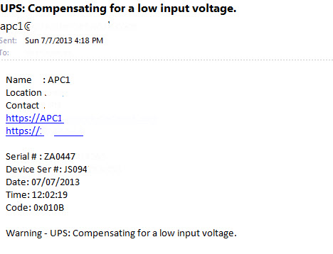

ConEdison here in NYC has lowered the voltage on everyone in my neighborhood since yesturday, because they cant keep up with the demand (heat wave).
My UPS are making up the differences to my electronic... so far the units are all holding up...
So I get these alerts all day long now  :D :
