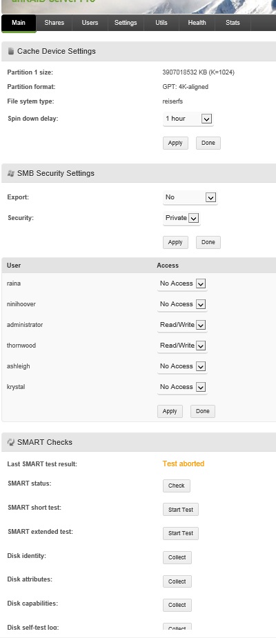

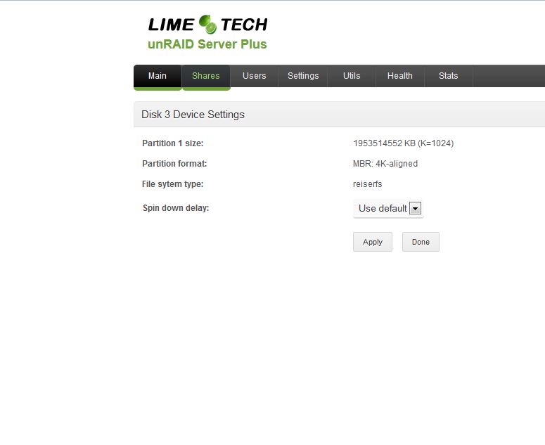

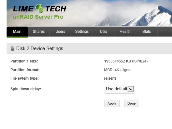

Hi I noticed that with simple features 1.0.11 we cant change the drive smb sharing parameters. it only shows in the cashe drive. on all others it just shows the drive format and that is it see pics.
With out Simple Features all drives look like Cashe drive.
Is there a setting that modifies this? or just a glitch? :'(
Its an issue with simple features at the moment seems like, i wanted to modify smb settings and i had to disable simplefeatures to be able to do it.  I hope now that we are close to a stable release simplefeatures gets updated.
Thornwood, I get this issue as well. SimpleFeatures 1.0.11 with unRAID 5.0 rc16c. None of my drives allow me to modify the SMB share settings anymore.

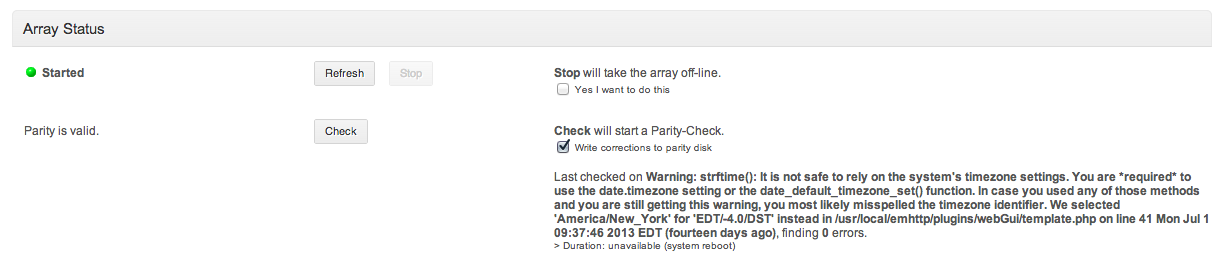

Can anyone explain why I'm receiving this warning on the main page.
I have tried the lm sensor setup but I still cant get simple feturs to show temps can some one make a quick step by step ..... I am going nutz :'(
X9sra is the motherboard.
^ 6 posts back
if I remember correctly, that can be aside-effect of installing the SF web plugin.

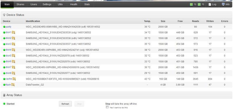

Hi Folks,
since i use unraid 5.0rc16c i have some missing things on the Main-Page:
Column "Used" is gone and "Total" also - can someone confirm this?
Is it a known issue or was it removed by the Developers?
Thanks for your Help
Zonediver
Hi Folks,
Zonediver
This is missing from mine, too, although I don't exactly recall what it looked like now lol. There was a summary row beneath all the devices, correct?
