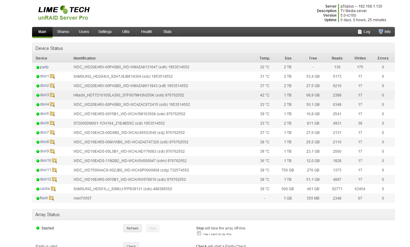

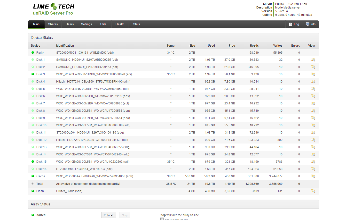

unraid 16B break the SF frontpage
no more totals
and the normal table is malformed now
see underneath
It looks like SF are broken, the web server not working.
I see this in my web server log
/usr/bin/tail -n 1000 -f /var/log/lighttpd/php.errors.log
[04-Jul-2013 14:21:34 UTC] PHP Warning: PHP Startup: Unable to load dynamic library '/usr/lib/php/extensions/curl.so' - libssl.so.1: cannot open shared object file: No such file or directory in Unknown on line 0
[04-Jul-2013 14:21:35 UTC] PHP Warning: PHP Startup: Unable to load dynamic library '/usr/lib/php/extensions/curl.so' - libssl.so.1: cannot open shared object file: No such file or directory in Unknown on line 0
[04-Jul-2013 14:21:44 UTC] PHP Notice: Undefined variable: string in /usr/local/emhttp/plugins/apcupsd/apcupsdctl.php on line 140
[04-Jul-2013 14:22:49 UTC] PHP Notice: Use of undefined constant color - assumed 'color' in /usr/local/emhttp/plugins/webGui/DeviceStatus.php on line 14
[04-Jul-2013 14:22:49 UTC] PHP Notice: Use of undefined constant name - assumed 'name' in /usr/local/emhttp/plugins/webGui/DeviceStatus.php on line 27
[04-Jul-2013 14:22:49 UTC] PHP Notice: Use of undefined constant id - assumed 'id' in /usr/local/emhttp/plugins/webGui/DeviceStatus.php on line 40
[04-Jul-2013 14:22:49 UTC] PHP Notice: Use of undefined constant device - assumed 'device' in /usr/local/emhttp/plugins/webGui/DeviceStatus.php on line 40
[04-Jul-2013 14:22:49 UTC] PHP Notice: Use of undefined constant size - assumed 'size' in /usr/local/emhttp/plugins/webGui/DeviceStatus.php on line 40
Installed openssl-solibs-1.0.1c-i486-3.txz ,now all good with the WEB server.
but still I have these error left
