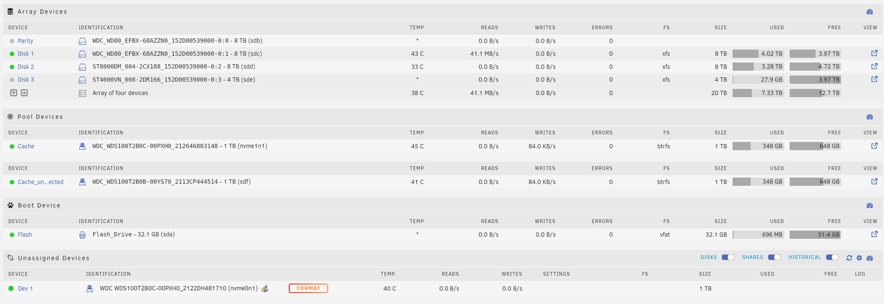

So i'm now restoring my appdata folder from a backup, and i can see its also restoring that folder to BOTH cache pools (screenshot)
So, what is the right way to do what I was doing? and how can i "unlink" these devices? Am I going to have to move all data and everything to the array, then delete all cache pools and move it all back again (as if I only had the one cache device and was replacing it? I have gone through that once before already)

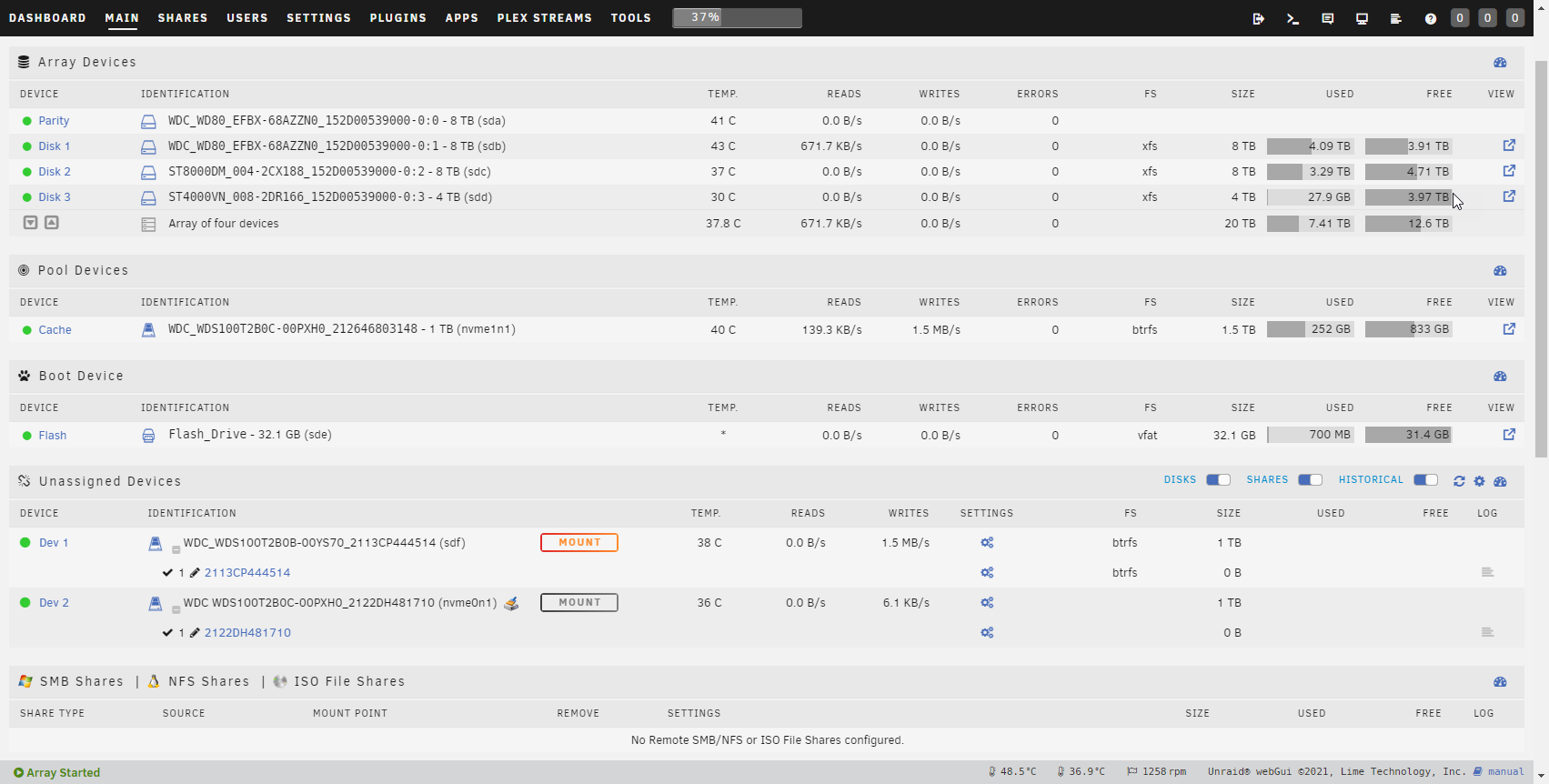

I followed the steps, added all three devices to the same pool and started up the array. Let it copy everything between the devices across the pool. stopped the array. Removed the sata SSD from the pool and started the array. Unraid complained the cache was unmountable and that i should format the cache (which i declined to do since that would wipe all data that i wanted to keep). So then reverting back, i made the pool only have the 1 device (the original NVME i wanted to keep) and restarted the array. Now when writing to the array i can see the old sata ssd also being written to in the unassigned devices. I have attached the diagnostics, but i think I'm going to have to just delete the pool entirely and start it fresh.
unraid-diagnostics-20220304-0853.zip
So, the result of deleting the pool and starting fresh is the exact same. Writing to the array sees data being written to both the NVME SSD and the SATA SSD in the unassigned devices section.
BTRFS is finding the second member and using it anyway, regardless of how it's assigned. If you don't need the data on either of the devices, run blkdiscard on the /dev device names. That will clear off all formatting and data on them.
