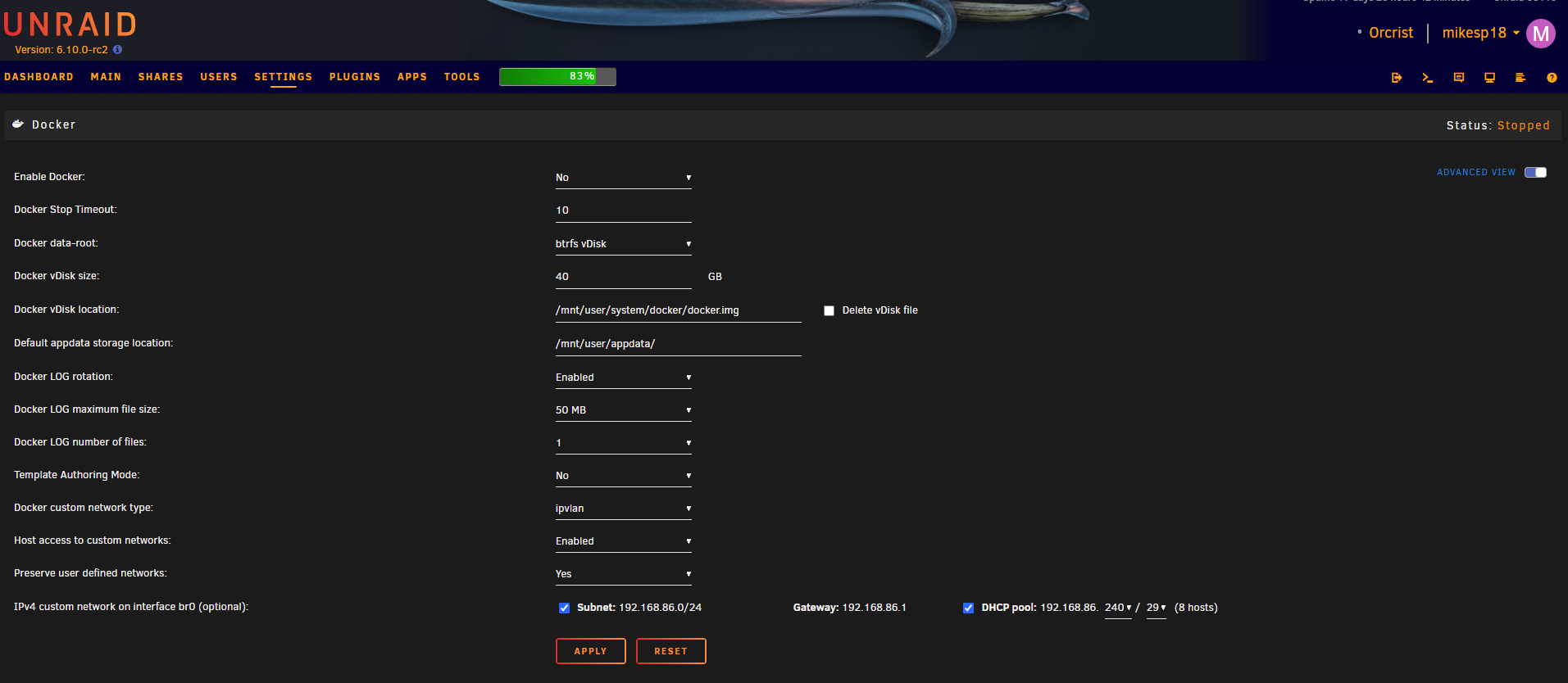

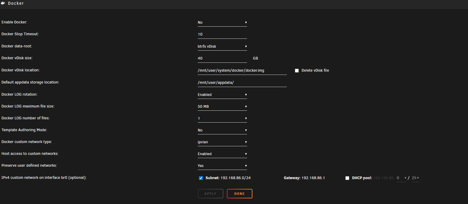

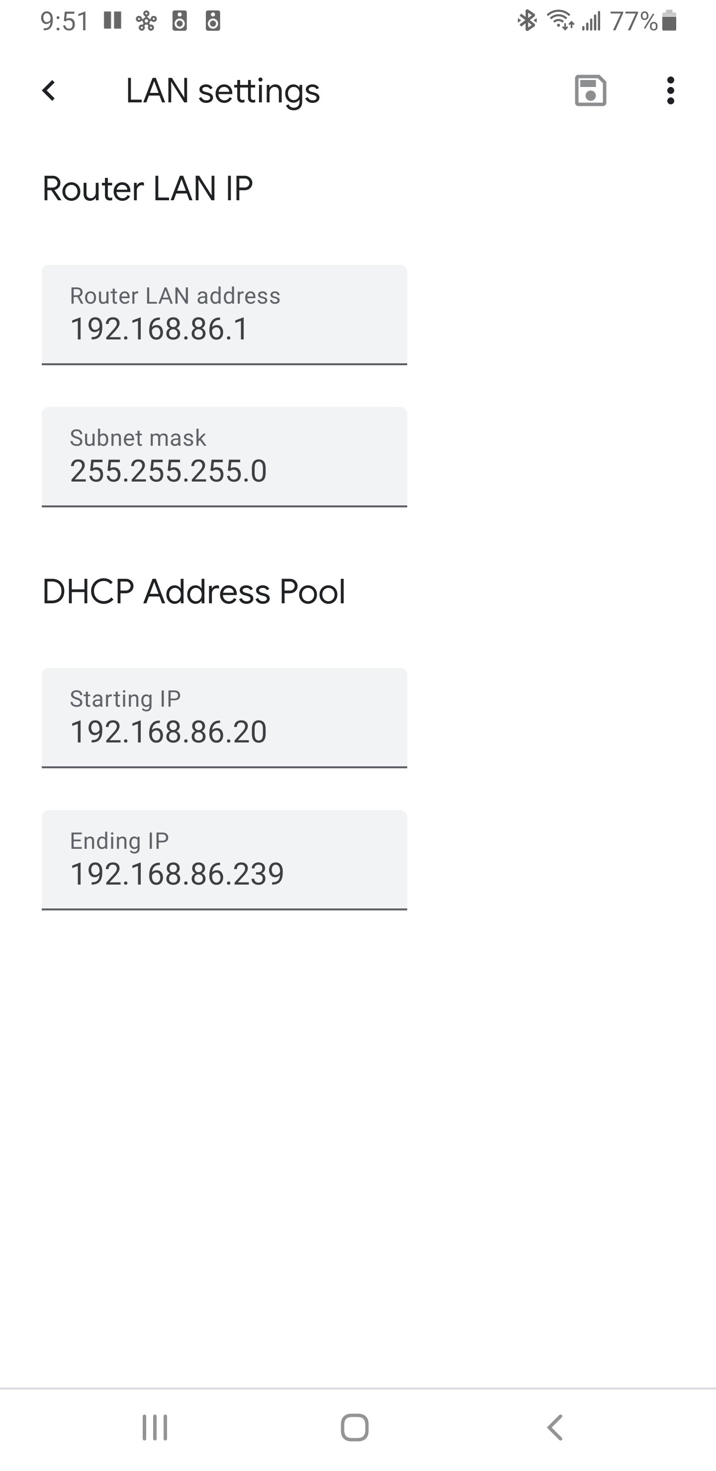

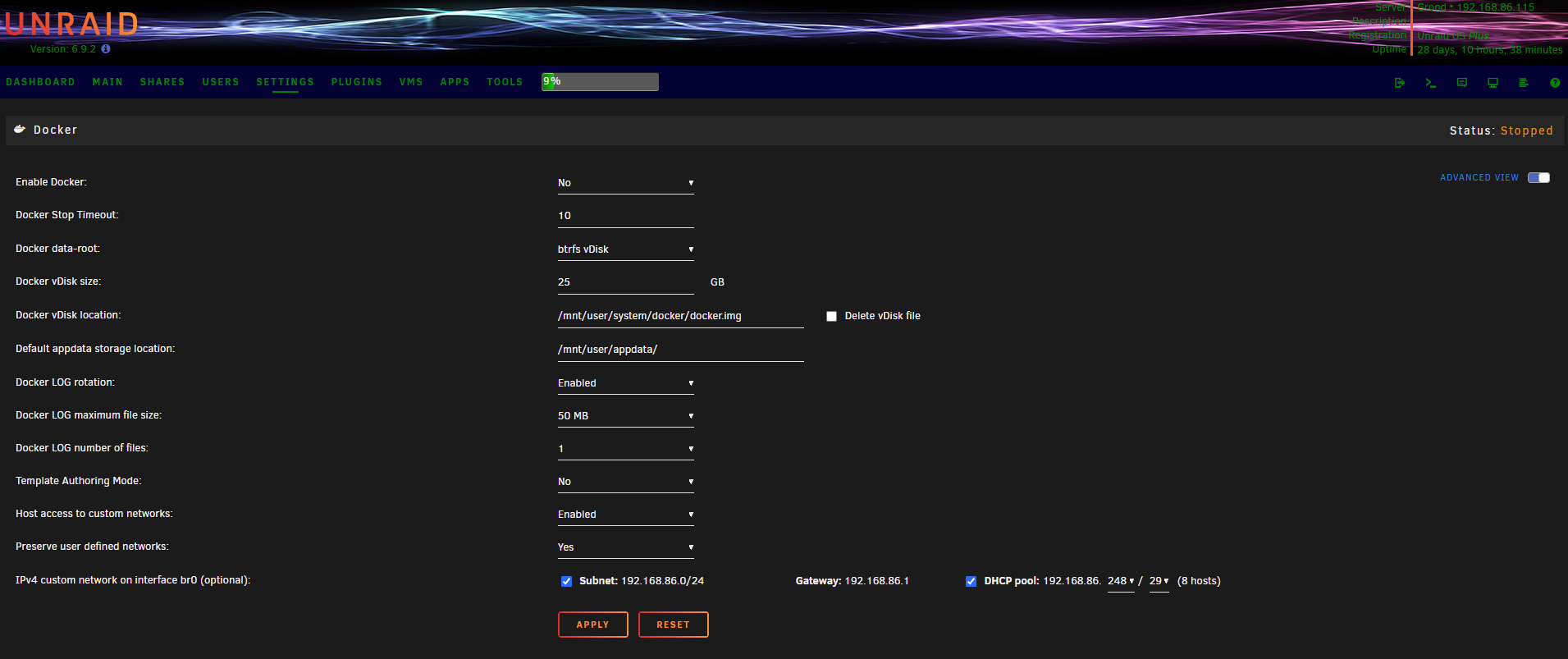

OK, I think I am following.  Forgive me as I'm typically a little out of my depth. I've screenshotted my current settings between the respective installations. I've also included the limited DHCP pool settings that my Google Nest Wifi Router will allow.  I figured that the DHCP pool of the Nest should NOT include the IPs of the DHCP pool of unraid to avoid conflicts, does this sound correct? So now the 6.10.0-rc2 (Orcrist) has 192.168.86.240-247, the 6.9.2 (Grond) has 192.168.86.248-255), and the Nest Wifi pool is 192.168.86.20-239.  I think this all sounds correct.
Yeah, this should work, the key is indeed no overlap between the different dhcp servers.

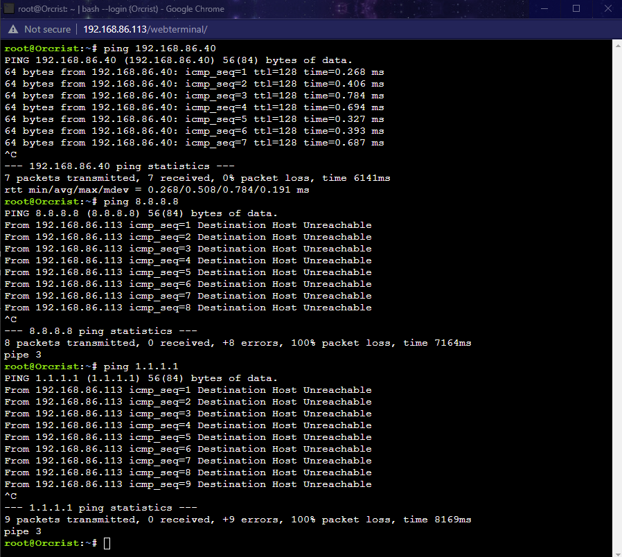

FWIW, this did not clear up the communications problem. Each time the Docker is enable, about 2 minutes later, I lose communication.  I can ping from the affect server console within the 192.168.86.x network, but I cannot ping outside. Also, I can confirm that I can ping those same IP addresses if the ENABLE DOCKER is set to NO, or if ENABLE DOCKER set to YES and the DOCKER CUSTOM NETWORK TYPE is set to MACVLAN instead of IPVLAN.
