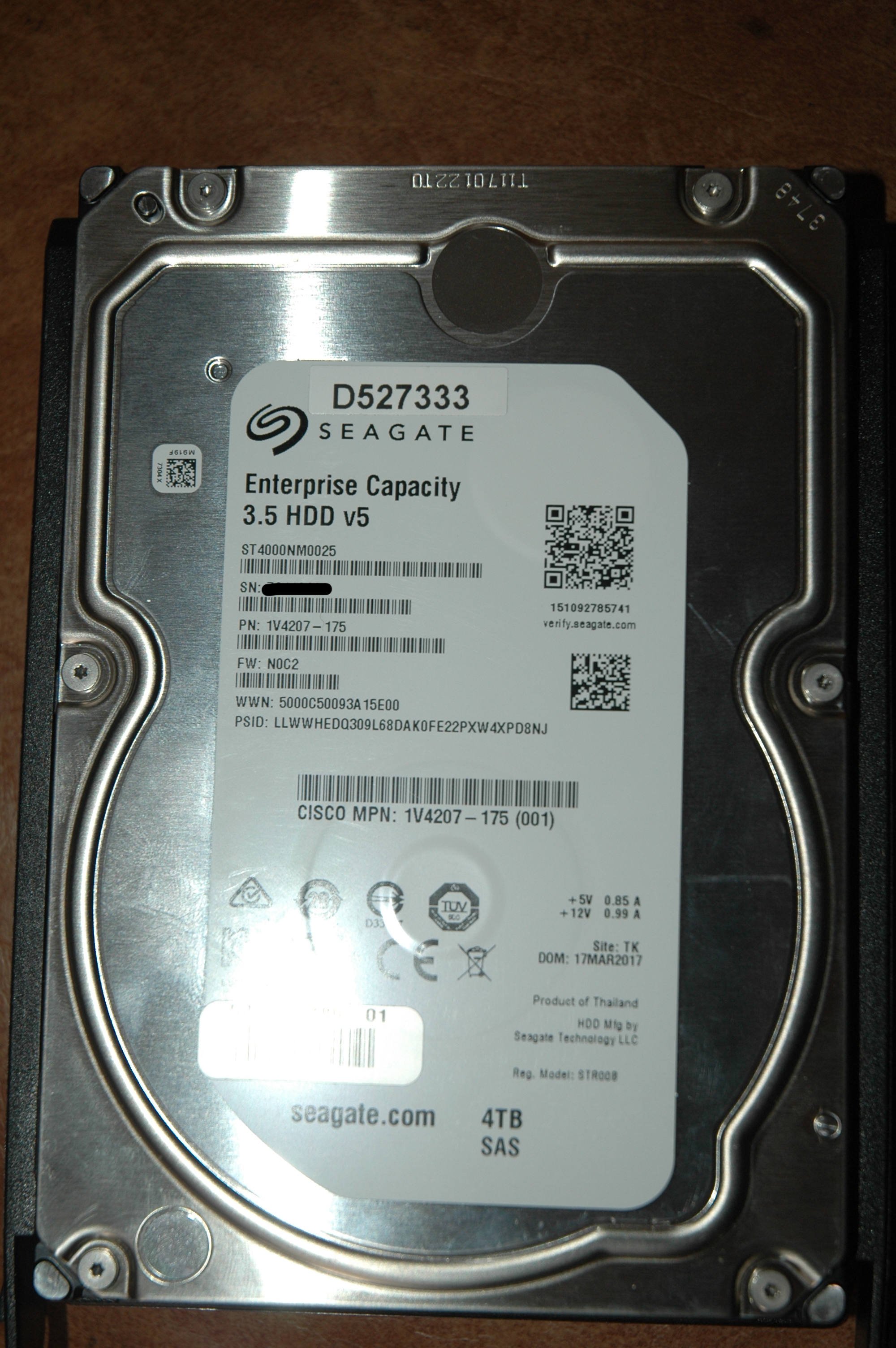

Hi all,
yesterday I flashed a LSI 9211-81 with P20 firm on IT mode.
Unraid detects the card but I can't see any hard drive, I don't know if cable is wrong or the card doesn't work with SAS hard disks of 4TB ( I have 2)
I have connected one of the hard disk sata to the card and reconizes it without problems, So I think that cable isn't correct,
Please, could you say me a cable that works with sas hard disks?
Thanks in advance.
The cable description seems OK.
Would seem weird that a SAS controller do not work with SAS drives and I do not think that the chip is old enough not to work with 4TB drives.
Silly question, but you did plug SATA power to the SAS connector ? (we had the issue lately on the forum :))

Everything looks normal with the HBA, it's being initialized correctly, but nothing being detected, so likely a device/cable problem, also make sure the disk is spinning up, some won't if there's 3.3v on the connector.

This is one of the drives and the power supply. I go to the Seagate page for information.
