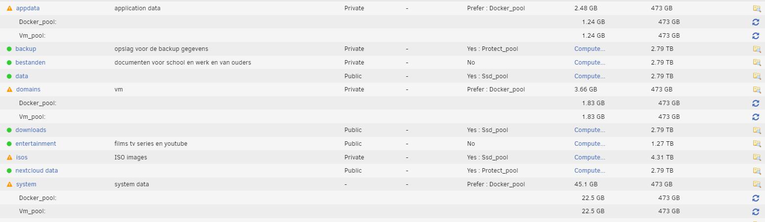

I installed a plugin today (Fix Common Problems) that said that, the share's appdata, system and domains, are located on both cache drives. that turns out to be correct and every time I remove the share from the wrong cache, unraid removes it from both.
here's how i set up my shares.
image.png.d1cb9f887126778215ec288ba7e031fe.pngimage.png.652392791413ac726186e7be99c0b2d8.pngimage.png.211579c31293ebd462788e6d7636eadb.pngimage.png.817c221a234bc46ff8ca0de299d05a4f.pngimage.png.ab9357c7173571ea0ba677067a7948a1.pngimage.png.fa9097171c2c57e712ee1fed2e398429.png
please help this is unnecessary writing to the ssds

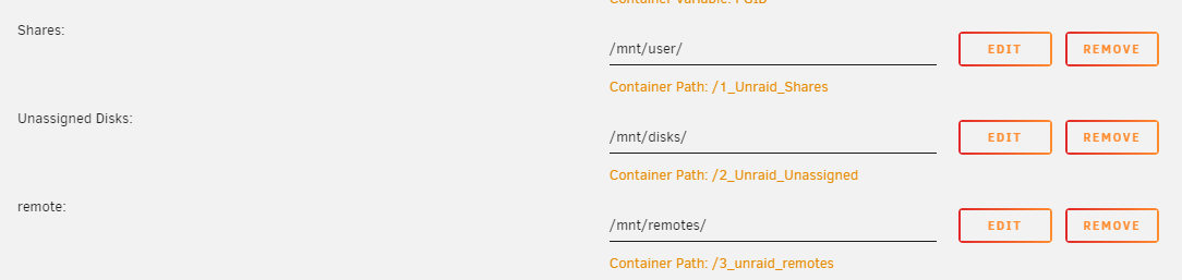

Do you have krusader configured to work with the disks or only with the user shares?
with user, disks and remotes
That doesn't give you access to the array or pool disks, only to user shares, unassigned device disks and remotes

Go to User Shares, click on Compute... for appdata, domains, system, and post a screenshot of the results.
oke. ill doe that
Since each pool has the same amount of data in each share, I suspect they are duplicates. Mover won't move duplicates so no point in trying that way.

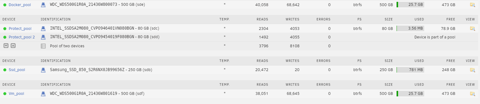

Were these disks together in the same pool?
no. they were always in seperent pools.
btrfs-usage.txt in system folder of your diagnostics indicates both disks are in both pools, so you must have done something at some point to make it think they were in the same pool.
