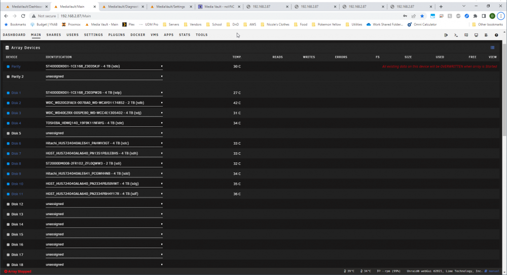

What's next? Unmount and add back into array?

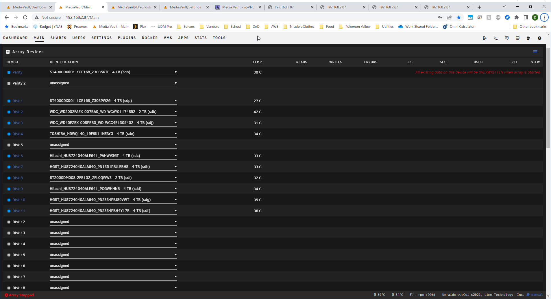

Just to make sure there is no misunderstanding, post a screenshot of Main - Array Devices.
Sure, no problem. Would rather be safe than sorry. Here is what the main - array screen is showing right now. The old disk 5 is currently in UD and mounted.

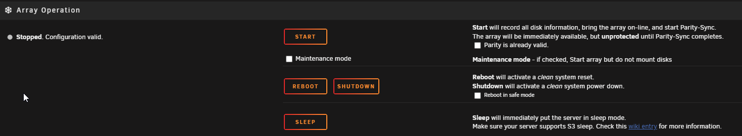

Unmount, assign as disk5. When you go to start the array, there should be a checkbox for rebuilding parity. You must rebuild parity.
Disk is unmounted and assigned to the disk 5 slot. Array is not started yet.
Earlier you mentioned backing up the contents of disk 5. Is that something we need to do before we start the array?
Is the checkbox for rebuilding parity the "Parity is already valid" one? Which should be unchecked as we want to rebuild parity. Just wanted to confirm.
What about disk 4? Will we handle that afterwords?
Edited by Arcaeus
Alright, array has been started with that box unchecked. Parity-Sync/Data-Rebuild is in progress.

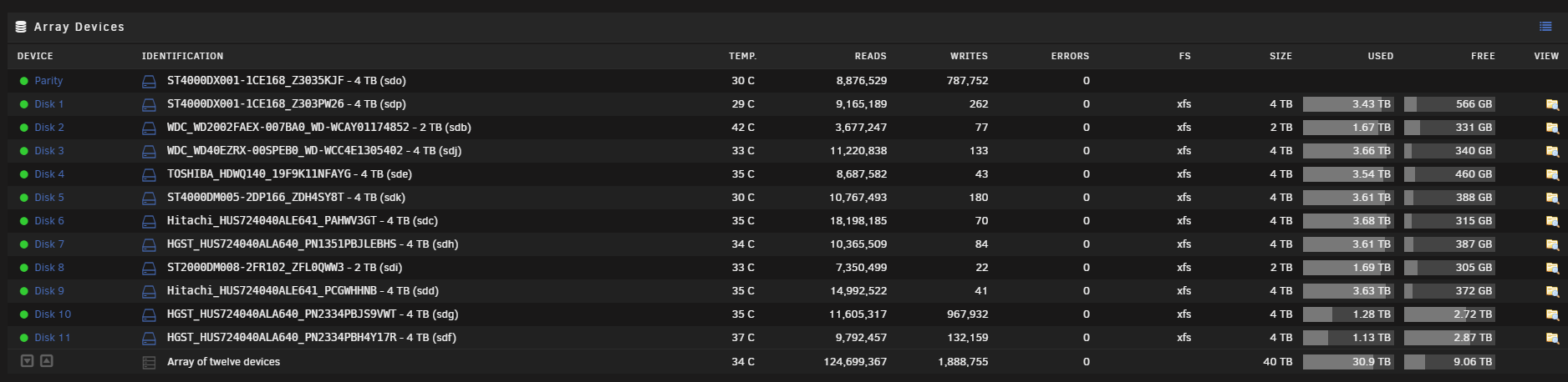

Backup would have been taken while it was still mounted in UD. You can reconsider backups after parity build completes.
During rebuild, you should see a lot of writes to the disk being rebuilt (parity), a lot of reads from all other disks in the array, and zeros in the Errors column on Main.
Understood. No CRC errors so far so seems like the firmware update did the trick. Will update this thread when the parity rebuild completes.
No CRC errors
Usually when we refer to CRC errors we are talking about the SMART attribute where the disk firmware records those. The disk firmware detects inconsistency in the data it has received.
The Errors column in Main I was referring to include all I/O errors, many would not be recorded as CRC errors because the disk never received any data to check.
Alright, Parity sync has completed. Zero IO errors and zero CRC errors.

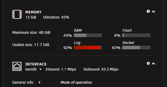

On the dashboard, the log is showing 92% full. What log is that referring to and how do I check it or clean it out?
Edited by Arcaeus
Rebooting will clear that, you might want to save the diags before doing in case they are needed, and if the log keeps growing you should post new diags.
Yep, looks like that got cleared out and so far staying at 1%.

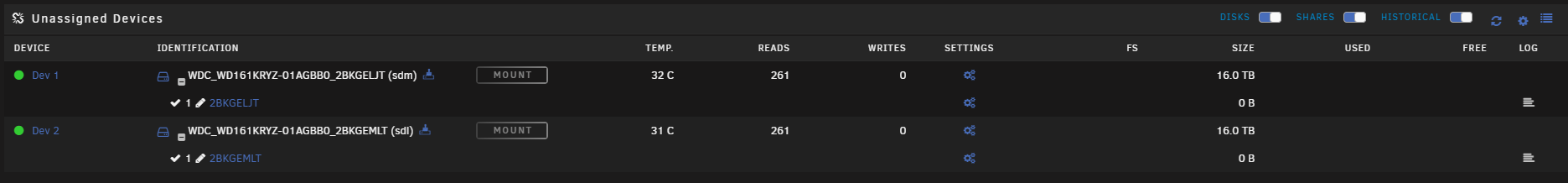

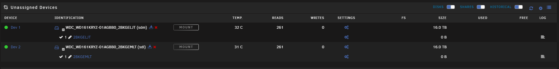

Alright, last question I have would be the process to format & mount the 2 blank 16TB drives currently sitting in UD. The idea here is that I would use these as a local backup of the data just in case something happens to the data on the array (like what almost happened here). While I wouldn't have parity in these, the plan would be to have a complete backup of everything that is kept in sync with Rclone or something similar, as well as a cloud backup offsite.
Currently I can see the disks, but the Mount button is greyed out (I'm assuming due to them being precleared but not formatted yet). Destructive mode is enabled and UD Plus plugin is installed. Where do I go to format those?
I'm assuming that I should just format them in XFS as I don't plan to remove them from my server, but does in make any sense to format them in NTFS?
I saw this link that you had posted a few years back but it looks broken: https://forums.lime-technology.com/topic/44104-unassigned-devices-managing-disk-drives-outside-of-the-unraid-array/ . Is there an updated link or what are your thoughts on this idea and a process to complete it?
Edited by Arcaeus

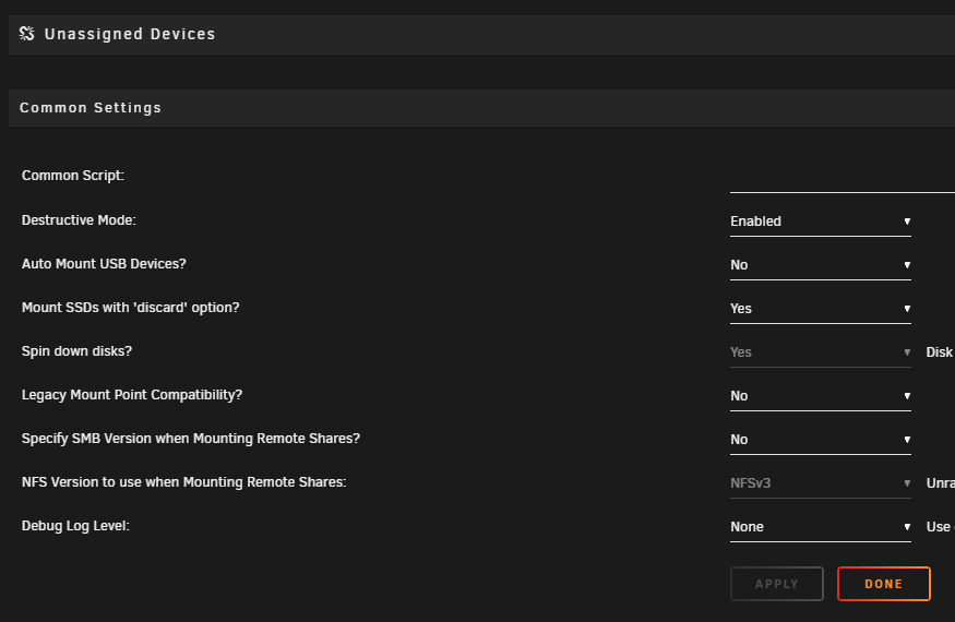

You need to enable destructive mode in the UD settings to format disks, I would just use XFS, they can always be read in any Linux computer, or by using an Unraid trial key.
Here is what I'm seeing as I must be missing something:
Remove the existing partitions by clicking on the red x then format.
So when I do that, it gives me this message saying that I would remove the preclear signature and it would have to re-clear the disk. I guess that doesn't matter as I'm not adding the disk into the array?
Correct.

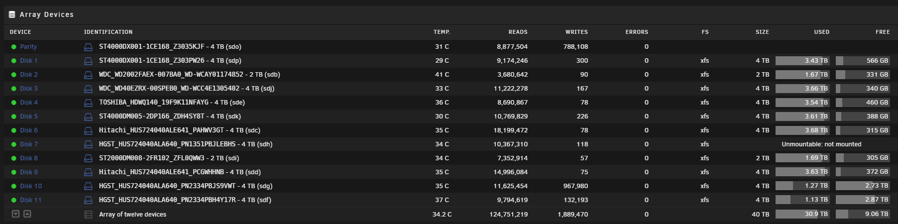

On 5/6/2022 at 12:46 PM, JorgeB said:
Correct.
Hey Jorge, I'm trying to figure out some share errors that aren't showing up now. When I ran 'ls -lah /mnt' it's showing question marks for disk 7 despite it showing ok in Main:
root@MediaVault:~# ls -lah /mnt
/bin/ls: cannot access '/mnt/disk7': Input/output error
total 16K
drwxr-xr-x 19 root   root  380 May  6 10:54 ./
drwxr-xr-x 21 root   root  480 May 10 09:58 ../
drwxrwxrwx  1 nobody users  80 May  6 11:04 cache/
drwxrwxrwx  9 nobody users 138 May  6 11:04 disk1/
drwxrwxrwx  8 nobody users 133 May  7 16:10 disk10/
drwxrwxrwx  5 nobody users  75 May  7 16:10 disk11/
drwxrwxrwx  6 nobody users  67 May  6 11:04 disk2/
drwxrwxrwx  9 nobody users 148 May  6 11:04 disk3/
drwxrwxrwx  4 nobody users  41 May  6 11:04 disk4/
drwxrwxrwx 10 nobody users 166 May  6 11:04 disk5/
drwxrwxrwx  7 nobody users 106 May  6 11:04 disk6/
d?????????  ? ?      ?       ?            ? disk7/
drwxrwxrwx  6 nobody users  73 May  7 16:10 disk8/
drwxrwxrwx  6 nobody users  67 May  6 11:04 disk9/
drwxrwxrwt  5 nobody users 100 May  6 13:41 disks/
drwxrwxrwt  2 nobody users  40 May  6 10:52 remotes/
drwxrwxrwt  2 nobody users  40 May  6 10:52 rootshare/
drwxrwxrwx  1 nobody users 138 May  6 11:04 user/
drwxrwxrwx  1 nobody users 138 May  6 11:04 user0/
I ran the file system check on disk 7 and got this output:

Is there any reason to not run the file system check without the -n flag now? After that completes would I rebuild the drive like we did before or how does that work?
New diags attached if needed.
mediavault-diagnostics-20220510-1009.zip
Edited by Arcaeus

Restarted the array regularly, and now disk 7 is showing 'Unmountable: not mounted' in Main - Array (attached).
