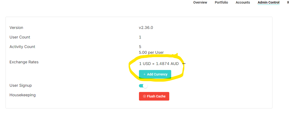

Yeh same issue. If you go into the Admin section you can add a currency there, it'll find the exchange rate and then update it. Then you will find the added currency to all the dropdown menus.
Thank you for the help! Sadly the Admin Control panel doesn't appear in my WebUI. How did you managed to get it?

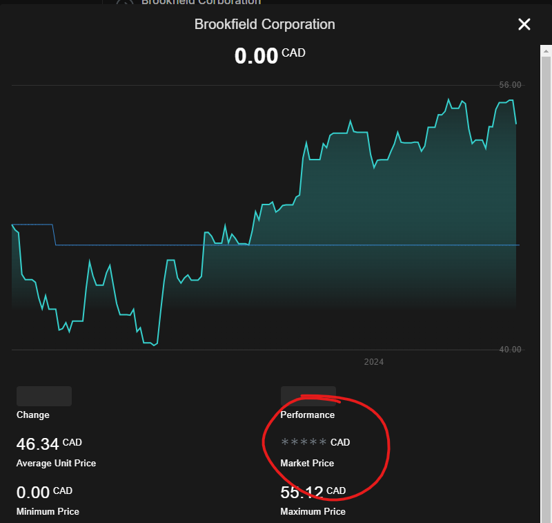

I am having a similar issue to what was previously discussed, my home page holdings show as $0, and market prices aren't loading for any assets. I have my base currency as CAD.  I have loaded all historical market data, and have all CAD rates. I have tried adding the TZ variable as null and it still did not correct it. Anyone have any ideas?
I have the same issue where I can only choose currencies USD and USX.
So, this exchange rate could be a good workaround but I don't have an exchange rate option in the admin panel.
