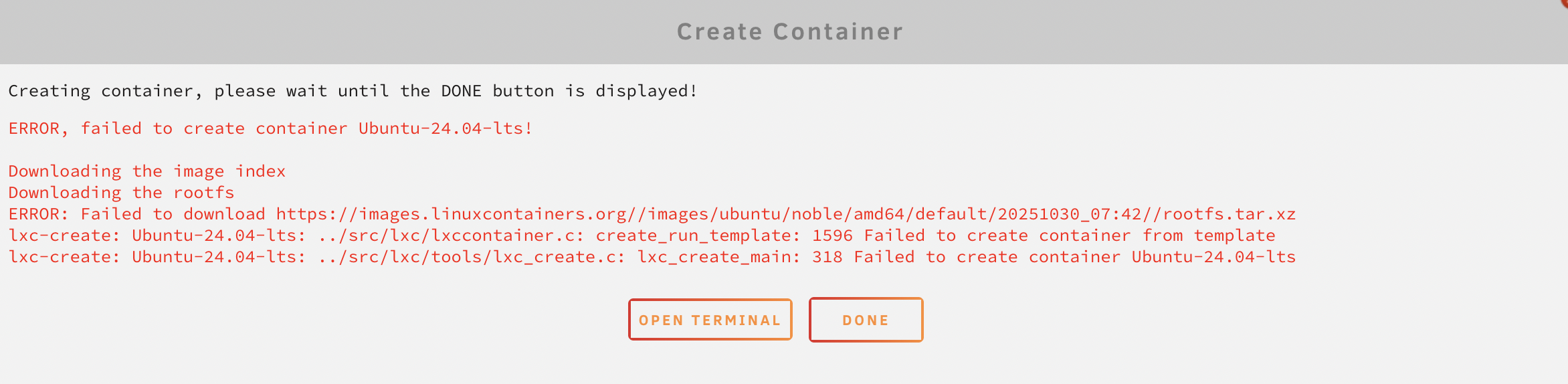

Am on Unraid 7.1.4. and having installed the plugin, I attempted to deploy Ubuntu 24.04-lts but was thrown this error:-
On another machine (also 7.1.4) it deploys flawlessly.
Permissions and ownership of the lxc folder appear the same.
I do not recall making any changes on the 2nd machine. Both compute have different mounts/shares but are configured to the folders directly. Would appreciate some help from the experts here on where to look....
Edited by patcsy88
I had the same problem, I remove the plugin and reinstalled it if that is an option

If multiple people reporting issues I suspect that the CDN or a mirror is having issues or the LXC container registry is down, may I ask where you are located in the world?
Are you sure that it isn't using the cache, LXC is designed in that way if you deploy a image it is cached for a few days and if you redeploy images then it's coming from the local cache.

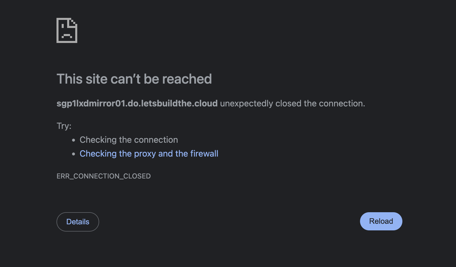

Reinstalled plugin did not work for me. I am in Malaysia. When accessing the URL, the CDN is in SG I get this
Looks like a CDN issue though I can deploy from another machine from the same LAN

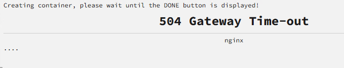

When I downloaded Ubuntu, it prompted this
The download from the container took too long and the Unraid WebUI timed out, may I ask what Internet connection do you have and where you are located in the world?

6 hours ago, Gaeroce said:
I am located in China and have already used a proxy, but it still times out
I can only imagine that the Proxy is really slow and that this causes the UI to time out.
However if you want to deploy a container manually you can always do that from the command line:
lxc-create --name CONTAINERNAME --template download -- --dist ubuntu --release RELEASE --arch amd64
You have to replace CONTAINERNAME of course with the name that the container should have and RELEASE with the release that you want have, I assume noble is what you want to have.
This should work since from the terminal it won't run into the timeout, except if the connection is that slow that it times out.
