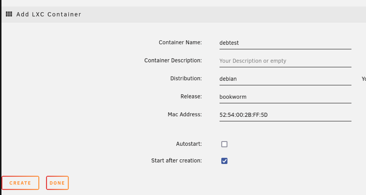

8 hours ago, ich777 said:
Can you please be a bit more precise?
Do you mean from a template or do you mean just click on Add Container and deploy it on your system?
I now tried both and it is working fine over here.
Can you please also rule out a browser issue on your side?
The first one is deployed with the Add Container button and the second one is deployed via a Template:
Yes, forgot about the distinction.
The issue was with create via the Add Container button. No template.
Also tried in incognito mode. Brave browser.

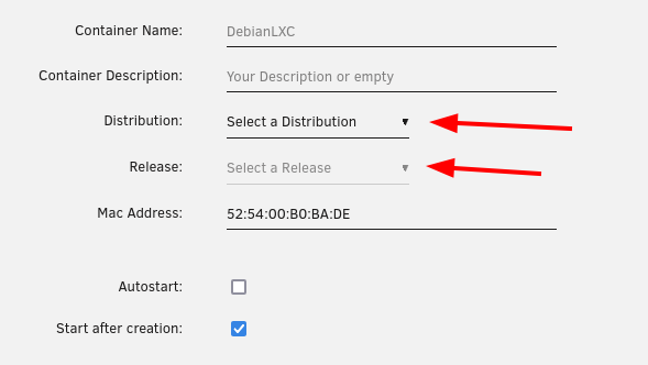

On 1/24/2025 at 12:33 PM, djismgaming said:
Weird "bug" here. I'm unable to add a new container. Just leaving the default options and adding a name. Pressing the Create button just "refreshes" the page and asks again for the new container name.
I'm hitting the same issue.
I set the name, distro and release, but after clicking "Create", it just refreshes the page. I'm on Unraid 7.0.0
13 hours ago, ich777 said:
Please also look in your syslog, it seems that a Docker container or something is constantly restarting...
Now this, is attention to detail. 😉
Thanks!
On 1/17/2025 at 2:43 AM, ich777 said:
Please go to: Tools -> Diagnostics -> click the Checkbox "Anonymize diagnostics" to anonymize your Diagnostics -> Download
@Daniel15 Do as ich777 said before to share your diagnostics. It helps them a lot on these reports of issues. ;)
But in my case, the next day all worked alright. No changes on my side. Do you use Brave browser by any chance? That's the one I use. Just to see if there's a pattern, I guess.
This is a really strange issue, however what I can see from your screenshot the Distributions and Releases can't be grabbed that's why you see no drop downs on that page, it should look like:
Maybe something went wrong while connecting to images.linuxcontainers.org and that's why it won't work but I can't tell for sure.
Can you please try again, I'm not too sure if this is an issue with the plugin or maybe on the end from LXC since @djismgaming was also reporting the same with the drop downs and now it it is working again for him it seems.
Here is a animation how it should look like (I'm also using Firefox) :
test.apng
Yeah, it is working for me. No change, apart of waking up the next day haha. All good so far.
