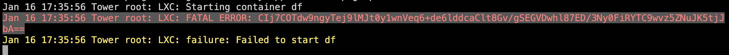

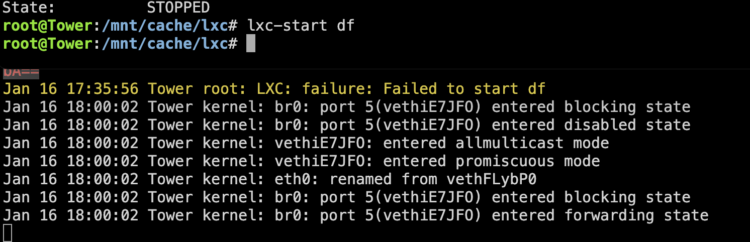

Hello, my problem is the same as the previous user. The unraid gui interface cannot start the lxc container. The command line lxc-start can start the container. Can you help me troubleshoot?
use "lxc-start df" can start-up,here are log
2 hours ago, solomon6 said:
thank you
It seems like that you are using a Pirated version from Unraid, no support from my side unless for such versions.
Please consider that these issues could also be due to using a custom pirated version. You never know what backdoors or other questionable elements might be included in such versions, disrupting the system as a whole. Your server might already be part of a botnet.
Personally, pirating a server OS would not be an option for me, as you can never be sure what is included in such a build.
