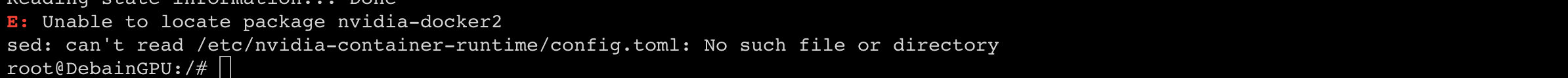

24 minutes ago, ich777 said:
I just took a look at the tutorial and it is very well written...
If you just need Nvidia GPU in the container then do:
  1. Install the Nvidia Driver plugin on your Unraid Server
  2. Set up LXC
  3. Download the zip file from the linked post and open readme.txt
  4. Create a container and but don't start it
  5. Edit the container config and follow step 6 from readme.txt what to put into the config
  6. Start the container and open up a terminal from the container
  7. Follow everything from step 8 (granted you have all necessary dependencies installed)
  8. Done
I can't help any further since I don't have a Nvidia GPU installed on my LXC system however even if you follow the readme.txt from the pinned post step by step you will eventually end up with a container with Nvidia GPU support and a Desktop environment.
Im stuck at step 7
4 minutes ago, drmetro said:
Im stuck at step 7
Sorry, but this is not the support thread on how to install Nvidia in a LXC container, this is the LXC container support thread from the plugin itself.
You have multiple issues and I assume other things failed earlier in the process, again these are all basic things and I can't guide you through everything... Sorry.

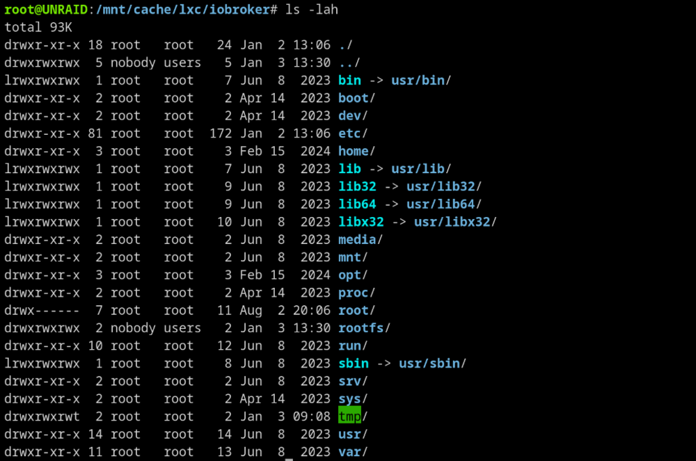

I want to move my LXC container from Proxmox to Unraid. Using the command line, I executed the restore command, and it was indicated as successful. However, it is not showing up in the GUI. Am I missing something?
thx
Yes, the folder structure is not correct:
- lxc
  - iobroker
    - rootfs
      - bin
      - usr
    - config
Can you please be a bit more specific which command that you where using?
If you want to import anything from Proxmox it would be best to create a container with the same distribution and release that you where using for the container on Proxmox but don't start it, then go into the folder from that container, go into rootfs, delete everything in there and extract the contents from your container from Proxmox into there, after that the container should start fine.

Thank you very much for your tip, it worked wonderfully. I still have a small problem, I cannot start an LXC container via the GUI, and the autostart doesn't work either. I have to do it manually via the shell with 'lxc-start iobroker'.
Do you know this phenomenon? And do you have a solution?
Please post your Diagnostics.
