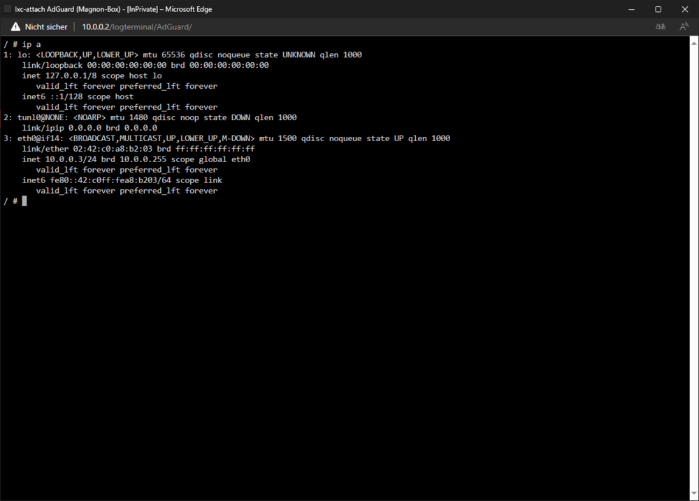

On 7/14/2024 at 9:47 AM, ich777 said:
Can you be a bit more specific what‘s not working?
Does the container not get a IPv6 or can you not reach it?
The container just start with ipv4 and the fe80:: address. They do not get a GUA or ULA Address.
Edit: i upgraded straight back to 7 and this is how it looks:
Edit: Found a fix for the issue. Change your LXC config from
lxc.net.0.type = veth
lxc.net.0.flags = up
lxc.net.0.link = br0
lxc.net.0.name = eth0
to
lxc.net.0.type = macvlan
and its working again under unraid 7.
Edit-Edit: drawback of course is that the veth enabled communication between the host and container, that doesnt work with macvlan and requires the host access enabled :/
Edit-Edit-Edit.
ip6tables -P FORWARD ACCEPT
Will resolve the issue with veth. The default policy for FORWARD changed from ACCEPT to DROP
Edited by Mainfrezzer

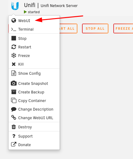

Nope, but I've created such a container archive for testing purposes, do the following:
  1. Open up a Unraid terminal and execute:
    wget -O /tmp/lxc_container_template.xml https://raw.githubusercontent.com/ich777/unraid-lxc-unifi/main/lxc_container_template.xml
  2. In your Browser navigate to: http://<YourunRAIDIP>/LXCAddTemplate
  3. Make your changes if necessary
  4. Click Apply
  5. Wait for the Done button
After that you should be greeted with that:

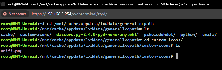

Awesome. using a custom icon per the template, install made this folder.
Thank you. Just wasn't sure of the path.

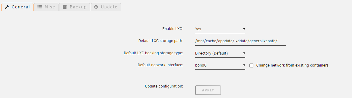

lxc.lxcpath=/mnt/cache/appdata/lxddata/generallxcpath
May I ask why you are using two folders for lxc …/lxddata/generallxcpath/…?
Something like: /mnt/cache/lxc in your case would be way simpler and I wouldn‘t recommend that you put the lxc directory in your appdata folder
No general reason.
its was how I originally setup pathing for the lxc settings, mainly for backup / general path
I my case, I want both under the same folder for custom rsync backup purposes.

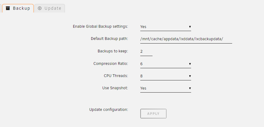

General settings:
backup settings:
That makes not much sense for me since you backup the main data path and the backup path via rsync (at least how you described it since you backup your appdata directory).
I designed the Backup function in that way so that you can place it basically anywhere so that you don‘t have to do double the backups via rsync.
This was just for explanation, however you can do whatever you want just wanted to explain why it doesn‘t makes much sense to me.
