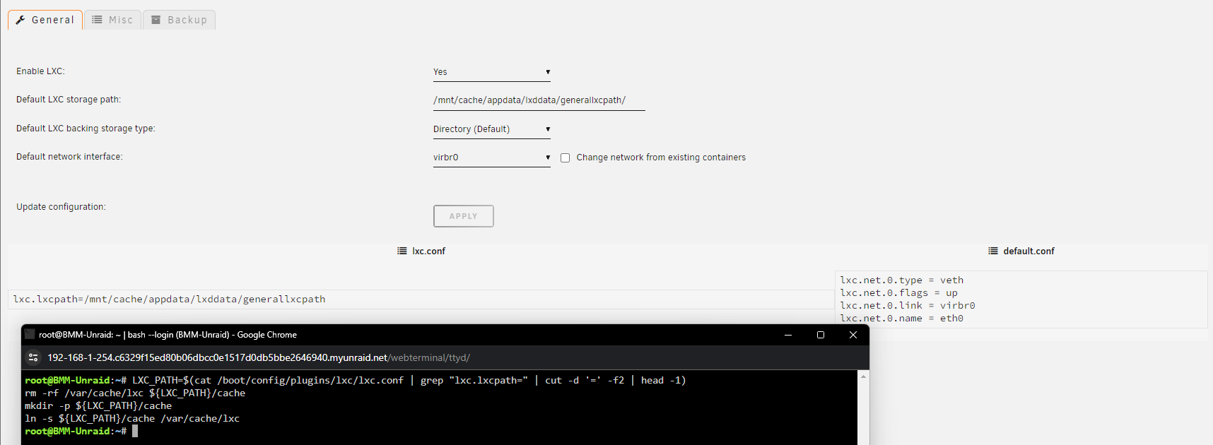

1 hour ago, bmartino1 said:
I seem to have issues setting up a lxc container and looking for guidance.
Is it in general not working or did you already set up a container?
If it is in general not working have you yet tried the fourth recommended post on top of this thread?
I see. Yep. was general running the 4th pin topic fixed the issue:
I needed to run:
LXC_PATH=$(cat /boot/config/plugins/lxc/lxc.conf | grep "lxc.lxcpath=" | cut -d '=' -f2 | head -1)
rm -rf /var/cache/lxc ${LXC_PATH}/cache
mkdir -p ${LXC_PATH}/cache
ln -s ${LXC_PATH}/cache /var/cache/lxc
Thank you for your help and assistance.
Yeah new testing to begin :)

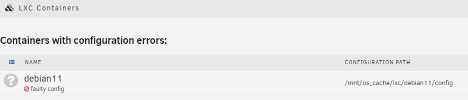

Hi ich777, I am trying to use LXC to solve my dual nic problem for plex container dedicated use and its work fine
Problem is passting through nvidia card.
I follow the instruction as this thread posted above and update my container config as my ls /dev/nvidia* -l result is as follow
root@X13-Unraid:~# ls /dev/nvidia* -l
crw-rw-rw- 1 root root 195, 254 Mar 13 00:32 /dev/nvidia-modeset
crw-rw-rw- 1 root root 236,   0 Mar 13 00:32 /dev/nvidia-uvm
crw-rw-rw- 1 root root 236,   1 Mar 13 00:32 /dev/nvidia-uvm-tools
crw-rw-rw- 1 root root 195,   0 Mar 13 00:32 /dev/nvidia0
crw-rw-rw- 1 root root 195, 255 Mar 13 00:32 /dev/nvidiactl
/dev/nvidia-caps:
total 0
cr-------- 1 root root 241, 1 Mar 13 00:32 nvidia-cap1
cr--r--r-- 1 root root 241, 2 Mar 13 00:32 nvidia-cap2
then I update the container config as follows
# Template used to create this container: /usr/share/lxc/templates/lxc-download
# Parameters passed to the template: --dist debian --release bullseye --arch amd64
# Template script checksum (SHA-1): 78b012f582aaa2d12f0c70cc47e910e9ad9be619
# For additional config options, please look at lxc.container.conf(5)
# Uncomment the following line to support nesting containers:
#lxc.include = /usr/share/lxc/config/nesting.conf
# (Be aware this has security implications)
# Distribution configuration
lxc.include = /usr/share/lxc/config/common.conf
lxc.arch = linux64
# Container specific configuration
lxc.rootfs.path = dir:/mnt/os_cache/lxc/debian11/rootfs
lxc.uts.name = debian11
# Allow cgroup access
lxc.cgroup2.devices.allow = c 195:* rwm
lxc.cgroup2.devices.allow = c 236:* rwm
lxc.cgroup2.devices.allow = c 241:* rwm
# Pass through device files
lxc.mount.entry: /dev/nvidia0 dev/nvidia0 none bind,optional,create=file
lxc.mount.entry: /dev/nvidiactl dev/nvidiactl none bind,optional,create=file
lxc.mount.entry: /dev/nvidia-uvm dev/nvidia-uvm none bind,optional,create=file
lxc.mount.entry: /dev/nvidia-modeset dev/nvidia-modeset none bind,optional,create=file
lxc.mount.entry: /dev/nvidia-uvm-tools dev/nvidia-uvm-tools none bind,optional,create=file
# Network configuration
lxc.net.0.type = veth
lxc.net.0.flags = up
lxc.net.0.link = br0
lxc.net.0.name = eth0
lxc.net.0.hwaddr=52:54:00:04:EC:67
lxc.start.auto=0
After this, in the LXC tab the container shows faulty config error
my unraid set is 6.12.8, the container img is debian 11
These entries are wrong.
You can't use : you have to use =
: where the old format and are not supported anymore.
Yes, because of the formatting error.

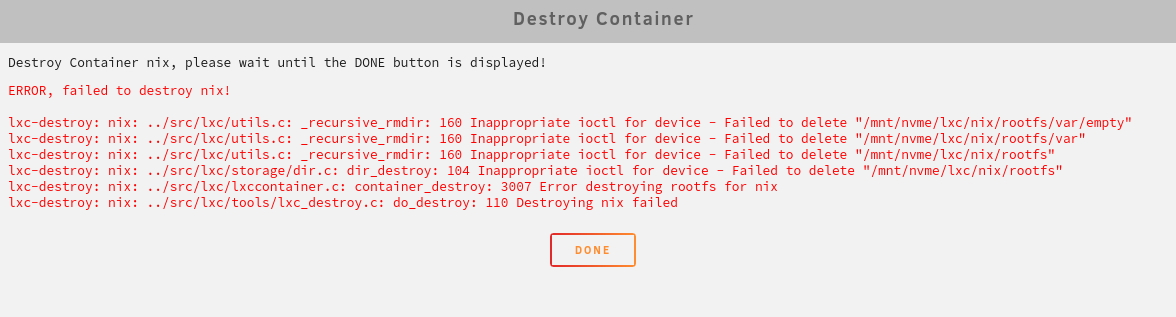

I tried your plugin on a fresh installation of Unraid 6.12.8 and LXC plugin verison 2024.03.14. ´Creating containers worked fine but destroying them always results in this error:
Destroy Container morbo, please wait until the DONE button is displayed!
ERROR, failed to destroy morbo!
lxc-destroy: morbo: ../src/lxc/utils.c: _recursive_rmdir: 160 Operation not permitted - Failed to delete "/mnt/cache/lxc/morbo/rootfs/var/empty"
lxc-destroy: morbo: ../src/lxc/utils.c: _recursive_rmdir: 160 Directory not empty - Failed to delete "/mnt/cache/lxc/morbo/rootfs/var"
lxc-destroy: morbo: ../src/lxc/utils.c: _recursive_rmdir: 160 Directory not empty - Failed to delete "/mnt/cache/lxc/morbo/rootfs"
lxc-destroy: morbo: ../src/lxc/storage/dir.c: dir_destroy: 104 Directory not empty - Failed to delete "/mnt/cache/lxc/morbo/rootfs"
lxc-destroy: morbo: ../src/lxc/lxccontainer.c: container_destroy: 3007 Error destroying rootfs for morbo
lxc-destroy: morbo: ../src/lxc/tools/lxc_destroy.c: do_destroy: 110 Destroying morbo failed
I have tried rebooting and disabling/enabling the plugin already. The folders on `/mnt/cache/lxc` are owned by `root`. Is that correct?
> stat /mnt/cache/lxc/morbo/rootfs/var/empty
May I ask why you are using LXC for Plex in the first place? A Docker container would be much easier to set up or did I get this wrong and you have a different use case for the container?
yeah I changed : to = the error status disappear

1 hour ago, buxel said:
Please find the logs attached. Before exporting, i have tried again with "test-container", which gave the same error as before.

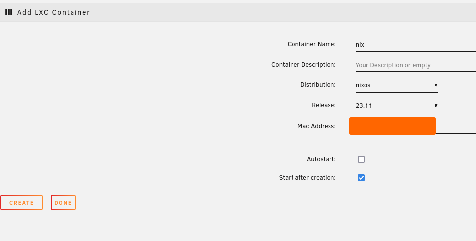

Just out of curiosity I tried also a NIX container 23.11:
...let it run for a bit:
...and then deleted it:
Seems to work fine here...

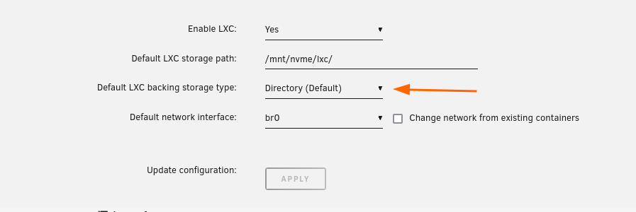

I then changed the plugin to Directory as Backing Storage type:
...and there it is when I delete the container:
However it seems to be related specific to NIXOS since it is not happening with a Debian container.
I just noticed that there the immutable bit is set. You have to remove that first and then delete it.
To remove that bit open up a Unraid terminal and type in:
chattr -i <PATHTOCONTAINER>/rootfs/var/empty
(you have to replace the path to container with the absolute path to /rootfs/var/empty like in my screenshot /mnt/nvme/lxc/nix/rootfs/var/empty)
After that you can delete the folder for the container from the lxc directory and it will disappear (refresh the LXC page once) or you could also go to the LXC page and delete the container since after that the removal will work as intended.
Hope that helps for now and I will look into if I can work around that in the plugin.
