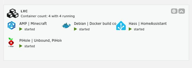

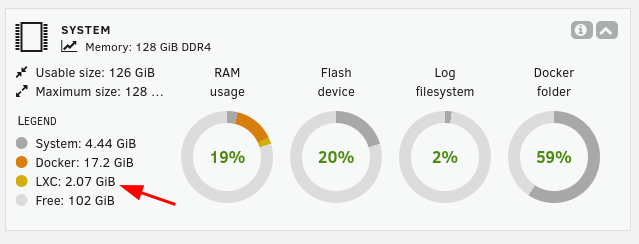

Unraid 7.0 doesn't have LXC on the dashboard :(
On what plugin version are you?
Are you sure you are on the latest LXC plugin version?
What do you referring to? The RAM usage or the Containers themself?
I see the containers on the Dashboard alongside with the RAM usage.
It should have its own column like these, shouldn't it?
LXC Version: LXC Version: 6.0.1
Plugin version, not LXC version...
It sure does:
Updating it to the latest plugin worked.
