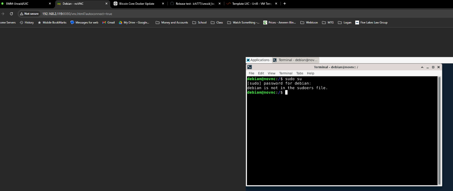

15 minutes ago, bmartino1 said:
I was able to install your test template version. My only issues i was locked out of sudo/root to install any applicaitons.
What are you doing here in the screenshot? Please type in `su` and not sudo su
The root password is set here and it's Unraid.

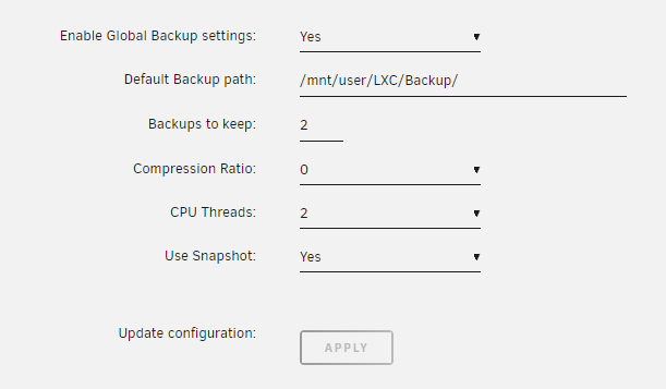

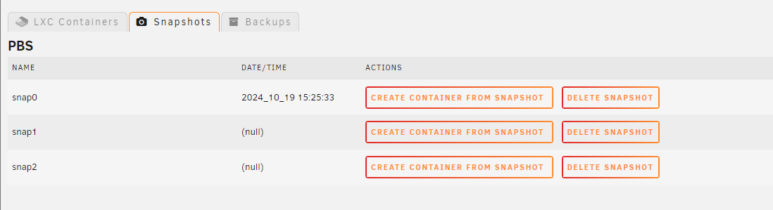

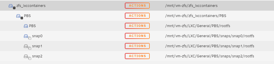

looks like unraid 7 beta 4 has a broken backup for lxc:
snapshots work, backup does not..
weird the backup trie dto make a zfs snapshot?
root@BMM-Unraid:~# zfs destroy vm-zfs/zfs_lxccontainers/PBS/snap2
cannot unmount '/mnt/vm-zfs/LXC/General/PBS/snaps/snap2/rootfs': pool or dataset is busy
root@BMM-Unraid:~#

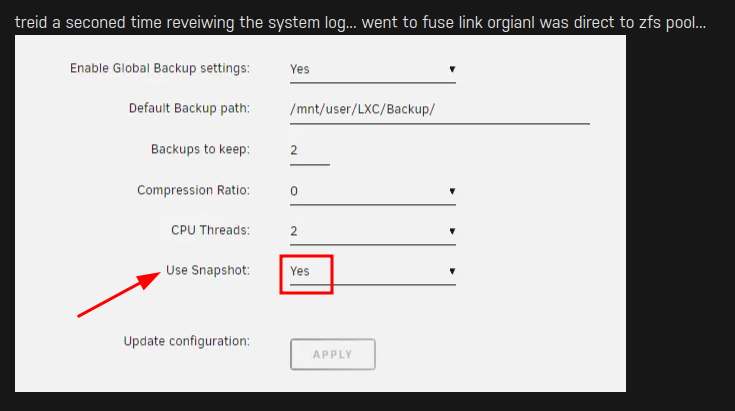

treid a seconed time reveiwing the system log... went to fuse link orgianl was direct to zfs pool...
vm-zfs/zfs_lxccontainers/PBS/PBS    vm-zfs/zfs_lxccontainers/PBS/snap0  vm-zfs/zfs_lxccontainers/PBS/snap1  vm-zfs/zfs_lxccontainers/PBS/snap2
cant seem to delete broken backup and 2 weird snapshots exist..

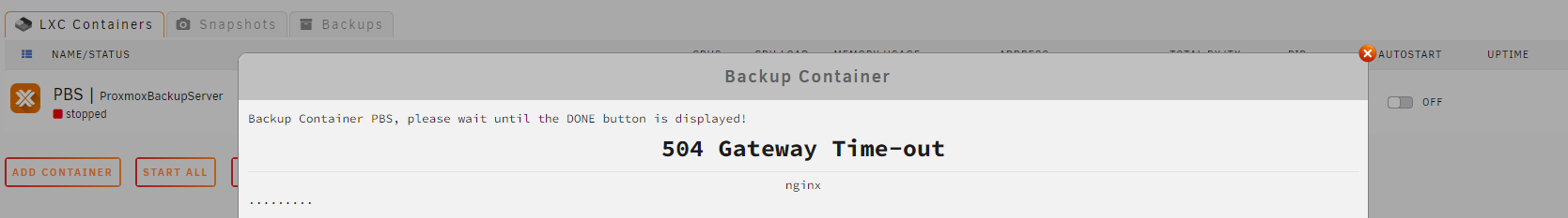

Nope, what browser are you using?
Your LXC container is simply to big so that your browser times out while creating the backup, please use lxc-autobackup from the command line.

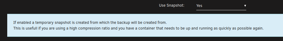

I really don't understand you even configured it to create a snapshot...
When you click on the little question mark in the top right corner when you are on that page: grafik.png.c8ce33bf00ea81ee0c3469f4cefdda08.png you would actually see what this means:
Can you please format such things as code, it is really hard to read...
You first have to destroy snap2 then snap1 and then snap0
However are you sure the backup process isn't running in the background any more?

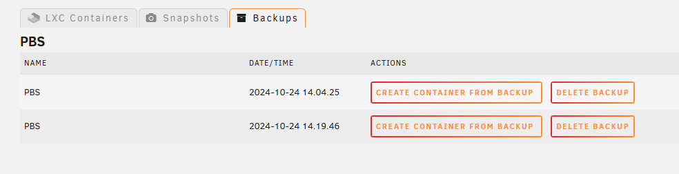

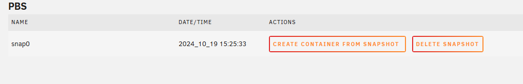

yes, as I rebooted the unraid system... after adding the aditional data and remoted unraid... I will use terminal comand next time. Ironically after the reboot I have 2 backups...
the nul snapshots are gone as well... not sure I trust them, though. image.thumb.png.e960d9ffb17a79f95a80c14c5b40f189.png
What do you mean with that?
Before reboot when gateway times out.
Snapshot had a null date data picture in diag post.
After reboot, snapshot data gone, but ?backup data exists?
a drastic change with no ability to verify if the backup was successful or not.
So I don't trust the backup file/files...
so I delete them, and used the terminal command to certify a good backup.
