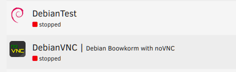

The first one is deployed with the Add Container button and the second one is deployed via a Template:
7 hours ago, MediaDactyl said:
Not sure where to find or change the root password. I tried to install from a template but when I try to su root and enter the password Unraid I get Authentication failure.
Depends about which container are we talking if you deployed it from a template, most of the times it is enough to type in exit once.
