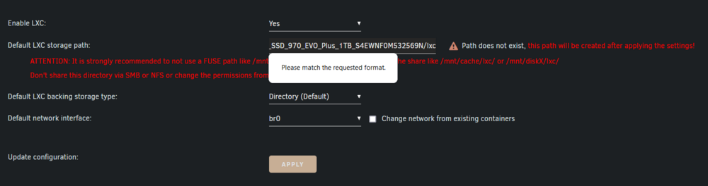

Is it possible to have the lxc path set to something else than the cache or the array?
I am trying to put it on a separate nvme that I use for all my docker containers and it doesn't accept the path.
/mnt/disks/Samsung_SSD_970_EVO_Plus_1TB_S4EWNF0M532569N/lxc
Sure, look at the example, you are missing the trailing /

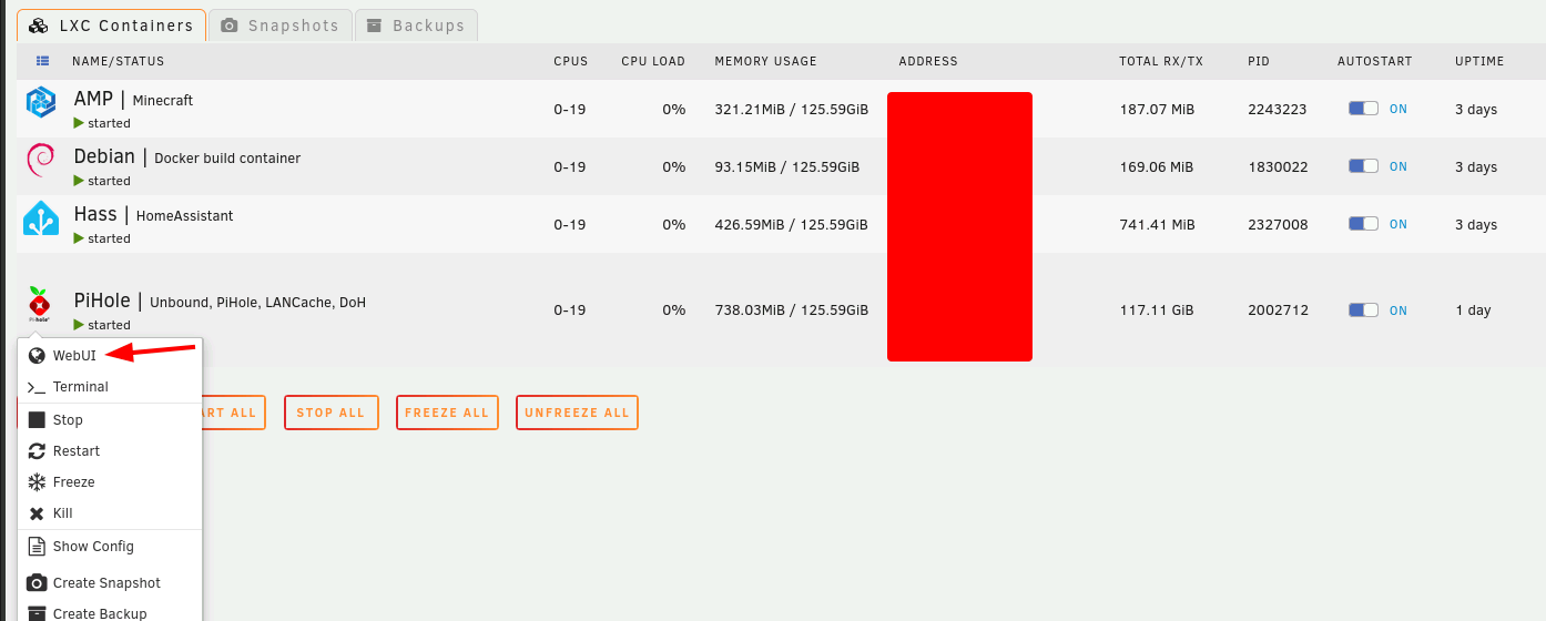

If the feature is no longer a simple button, does anyone happen to have a copy+paste of the commands to install the necessary packages before I try to figure it out on my own?
Please give me a bit and I will present a solution that is easy to install. :)
@mournful-hive3872 please make sure to update the plugin before doing the following because I pushed a bugfix to the plugin:
  1. Open up a Unraid terminal and execute this command:
    wget -O /tmp/lxc_container_template.xml https://raw.githubusercontent.com/ich777/unraid_lxc_debian_novnc/master/lxc_container_template.xml
  2. In your Browser navigate to: http://YOURSERVERIP/LXCAddTemplate
  3. Click "Apply"
  4. Wait for the Done button to appear (this can take a bit depending on your Internet connection)
After that you have a fully Debian Bookworm container as before, you even can click the container icon and select WebUI which will take you to the WebUI from the container:
Hope that helps.
2 hours ago, ich777 said:
Hope that helps.
Thank you so much, I'm back up and running! You are an invaluable member of this community, sir, and I hope you know how much you are appreciated!
