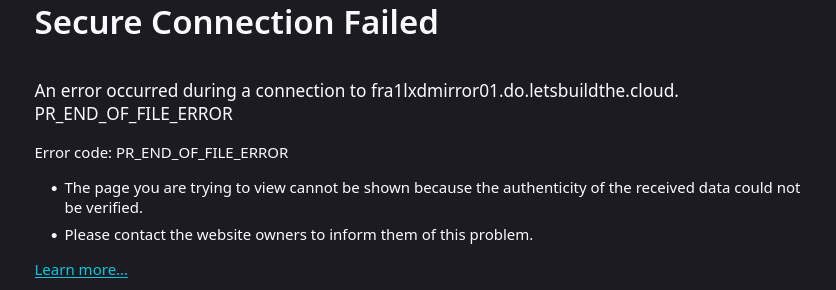

The actual URL to the download has a single forward slash before rootfs.tar.xz: https://images.linuxcontainers.org//images/debian/trixie/amd64/default/20251230_05%3A24/rootfs.tar.xz
This is definitely not the issue since I can download debian trixie just fine.
Have you yet tried to download the image with the double slashes? this works just fine, you are also missed that there are two slashes between org and images.
I suspect some other issue, do you have any Diagnostics for me or something to further troubleshoot?
The plugin wouldn't work for all the other users who have the plugin installed including me.
However LXC has at times issues with their CDNs and incomplete downloads, downloads not working or aborting downloads.

You're right. It IS a mirror problem. More specifically my OPNsense firewall (ZenArmor) was blocking the domain.
Once I unblocked the domain, the LXC installed correctly.
Thanks!

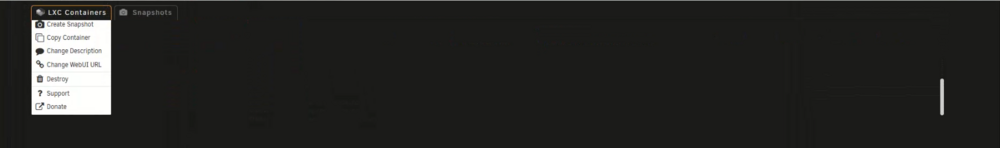

I am using Unraid version 7.2.3. I've encountered an issue where the container management menu is not displaying fully.
As shown in the attached screenshot, when I click to open the menu for a container, the bottom part of the menu is cut off/truncated, making it impossible to see or select all the available options.
I have tried adjusting the browser zoom level, but the menu remains cut off regardless of the zoom setting.
Edited by LuHua
Please try another browser or at least a Private window, this looks really strange and I really can't tell you what is causing that.

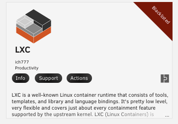

Attention:
This application template has been blacklisted.
This message showed up today.
Has it been replaced, or is this an error?
I didn't do anything.

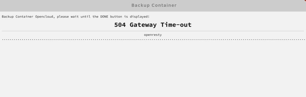

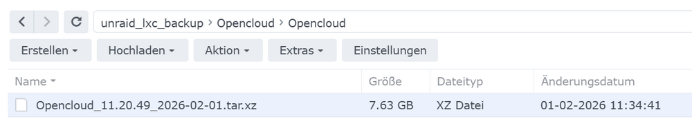

With unraid v7.2.3 the backup with lxc plugin gets 504 gateway time-out. None "DONE-button" is displayed
Backup path is "/mnt/remotes/192.168.23.2_unraid_lxc_backup/Opencloud/" on a Synology which is online and available via ping from unraid host.
A backup file has been created on Synology:
How can I check if backup has been finished successfully and backup file can be used for restore?
Nothing to worry about, the backup will be running in the background when the gateway times out, this is usually the case when backing up really big containers.
I would recommend that you might trigger it from the an Unraid Terminal or via a User Script by using: lxc-autobackup
The backup should be finished just fine.

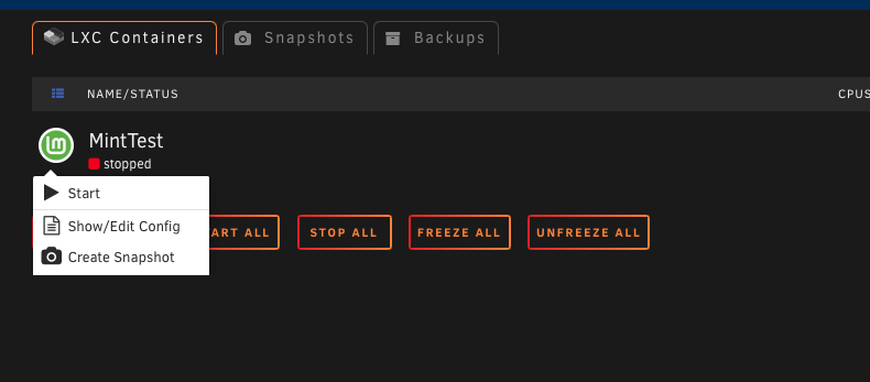

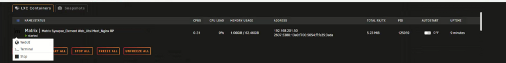

If I only have one container, there is no backup or any other option. I can't delete it either.
What am I missing here?
edit: Ok, never mind, I have to scroll down, because the viewport is so small hiding the options.
Looks really weird.

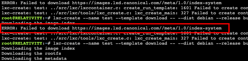

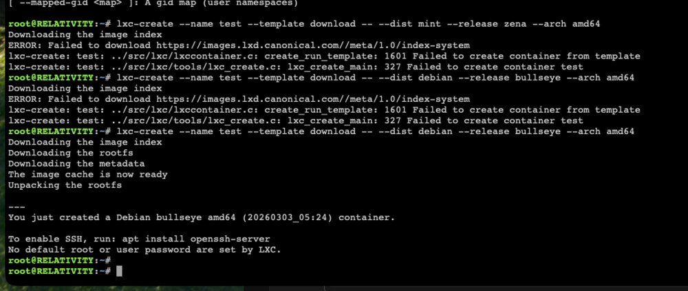

I messed up something.
I changed the LXC Container URL to images.lxd.canonical.com.
Then tried to create new container but the UI changed and no drop-down select any more. Tried to create with the default debian/bullseye clicking Create button then the site reloads with different URL but nothing happens.
I changed back to the original images.linuxcontainers.org.
Still not working and the drop-down menu still missing.
No anything in the Unraid logs. I tried to check the browser console, but nothing there also.
Tried to reinstall plugin. Same as before.
I saw the CLI command and changed back to the canonical.com URL, then tried with the original linuxcontainers.org URL as well:
Canonical not working, but linuxcontainers working with CLI.
From the WebGUI still nothing happens.
Now what? How can i recover the original functionality? Also how can I use the canonical images?
Thanks,
Mark
AFAIK Cononical doesn't follow the default folder structure form lxc images and IIRC you need to have LXD installed which is here not the case as you an see in your screenshot from above:
I assume that you immediately tried it after you changed the URL back, correct?
You have to wait for at least 15 minutes after the list got updated again or you can delete the folder /tmp/lxc, this should also solve the issue.
I think that is not possible with LXC, you would need LXD for that which is not supported by this plugin.
Yes, I tried right after setting up. It is now working today again. I was not aware of this delay.
Thanks for your help.

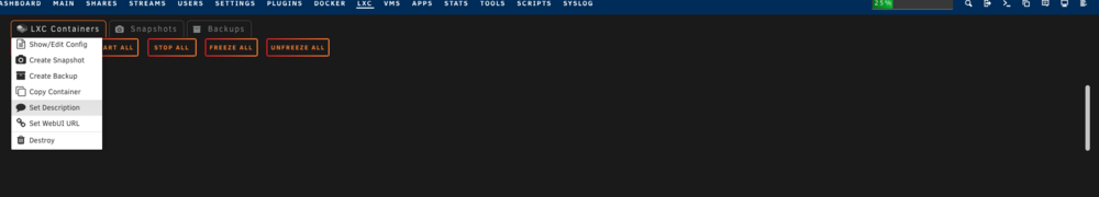

in lattest unraid 7.2.4 there is a disply bug
when opening the menu on a lxc the interal page lods a scroll wheel and requires scorll mous to access the lxc option menu
not sure if a css page with or other needs updated in plugin.
The plugin would probably need an update.
if you have time, I accept PullRequests
