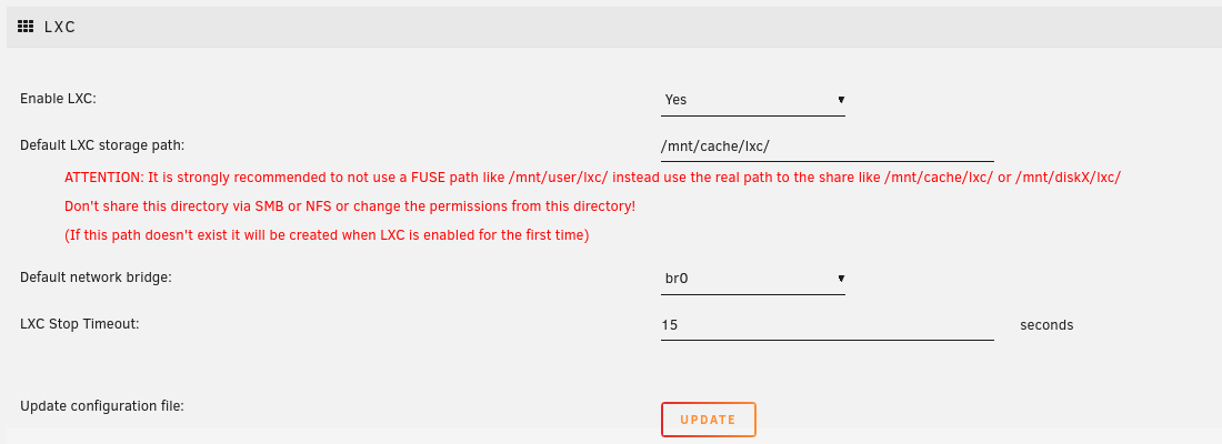

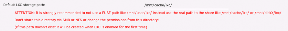

3 minutes ago, Kulisch said:
Not the default path /mnt/user/lxc/ exactly, but something in the /mnt/user/ path. Can't remember.
Have you read the red text on the LXC Settings page:
Read it? Yes. Read it correctly? No... So that was my bad. I changed the SMB Settings before, but that's all.
Why is the path /mnt/user/... not allowed to be used? Is there a feature of Unraid that breaks the functionality of LXC in this case?
Edited by ich777
change to cgroupv2
Because this can cause a lot of overhead when copying or installing many small files because it's a FUSE file system and will also cause more system load because of FUSE.
It can get even that far that the WebUI from Unraid itself can become unresponsive and hang for a short time, seen this when installing Docker container inside a LXC container with a huge Layer that has many packages to install/extract.
Don't get me wrong but I write such things for a good reason... ;)
Glad that you've worked it out! I will recommend this post on top of this thread.
Ah I see... yeah that makes sense.
Of course, I just wanted to understand. Thanks for educating and supporting. 👍
