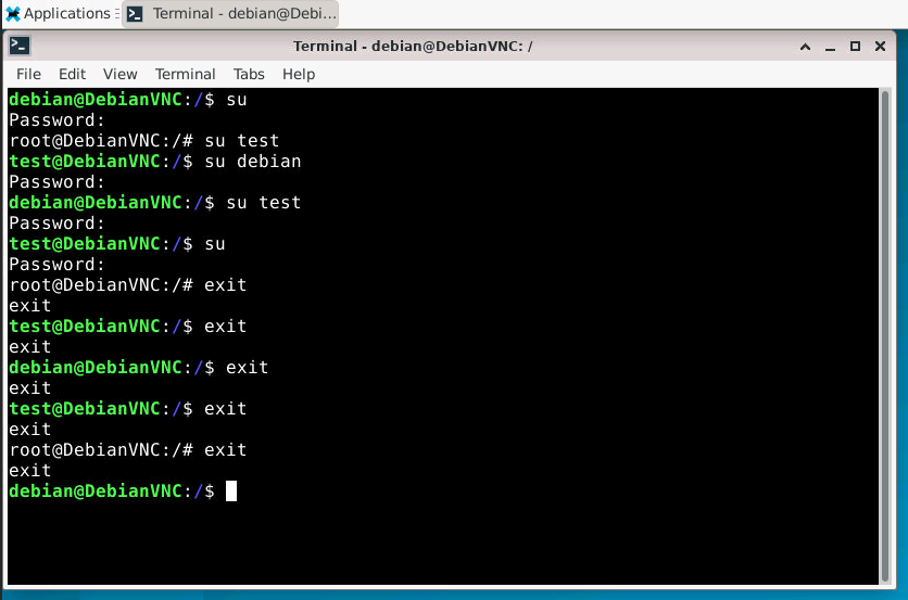

8 minutes ago, ich777 said:
Something must be wrong somehow on your end, I've did the exact same steps as you did with slightly different commands.
As you can see from my screenshots everything is working just fine...

16 minutes ago, Kulisch said:
Ok thanks, for checking that. I also tested most of the mentioned commands in the vnc container, but same result.
Try the following:
  1. Destroy the container
  2. Create a new VNC container with the name: DebianVNCTest
  3. Wait for the installation to finish
  4. Open up the browser and go to the noVNC webinterface from the container LXCContainerIP:8080/vnc.html?autoconnect=true
  5. In the taskbar click on the terminal
  6. Type in "su" and enter "Unraid" as the password
  7. Type in "passwd" enter "Unraid" and after that twice "12345"
  8. Type in "exit"
  9. Type in "su" again and "12345"
  10. When in the su shell type in "passwd debian" and twice "12345"
  11. After that you can change the shell with "su debian" but I would recommend to type in "exit" to go back to the debian shell (I never recommend to jump around the shells from a shell in a new shell and so on...)
  12. After beeing in the debian shell type in "passwd" enter "12345" once and after that type in "Unraid" twice
(all commands without double quotes)
You should end up with a passwords for the user debian "Unraid" and root "12345"

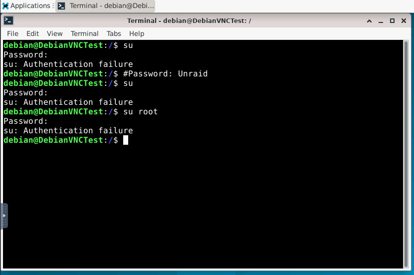

15 minutes ago, Kulisch said:
Maybe I have to clean some files/folder manually?
No, just destroy the container and create a new one, maybe try picking a different name and that should do it (even the same name is fine...).
Maybe rw permissions for the lxc path?
Please don't do this!!! This will most definitely destroy mess up all your LXC containers!
Start failing there:
In the meantime, I tried another image...
Result:
kulisch@Alpine:/$ su root
su: must be suid to work properly
Is your keyboard layout maybe wrong? Sorry I really don't know what could be wrong on your machine...
It seems like that you mistyped the password or something like that...
I can't imagine something else also it is working for everyone else from what I know...
Also what is this line with:
#Password: Unraid

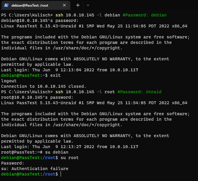

Honestly... im thinking in the same way,... I wish I could show you in plaintext what I'm typing, but I dont know how. I want to show you that this is not an layer 8 problem, because I'm starting to feel ridiculous.
#Password: Unraid
I wanted to make sure that I typed the password correctly, because like you said... maybe the Keyboard Layout is wrong. But thats not the case.
If this helps, I can change my Layout with dpkg-reconfigure, but this shouldn't effect this in any way.
That's why I don't recommend connecting to the root shell, switching to a user shell and then try to switch to a root shell again. I also don't see why this makes any sense...
Switching user multiple times to another user doesn't make much sense, that is correct but it works on every other VM, Machine,... thats only for testing purposes to troubleshoot.
kulisch -> root -> kulisch -> root (works on my testmachine too)
If there is no solution for this, I will uninstall this plugin and come back later, hoping that is problem gets solved by... I dont know some random patch or something.
Edited by Kulisch

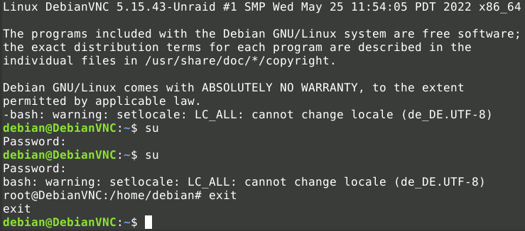

This is working in the VNC LXC container too:
Ok, ssh to the VNCContainer works but su does not... I can't explain why...
So if no one else is expiriencing this issues, than that is fine. I will try this in the future again but for now I leave that, because I dont know what exactly is the problem in this case.
But thank you very much for your time and trying find a solution.
Sorry but I have to say that something must be wrong on your side:
No issue here whatsoever over ssh...
(please ignore the one su attempt, had to change the password since I forgot it now that I changed it that many times... :D )
