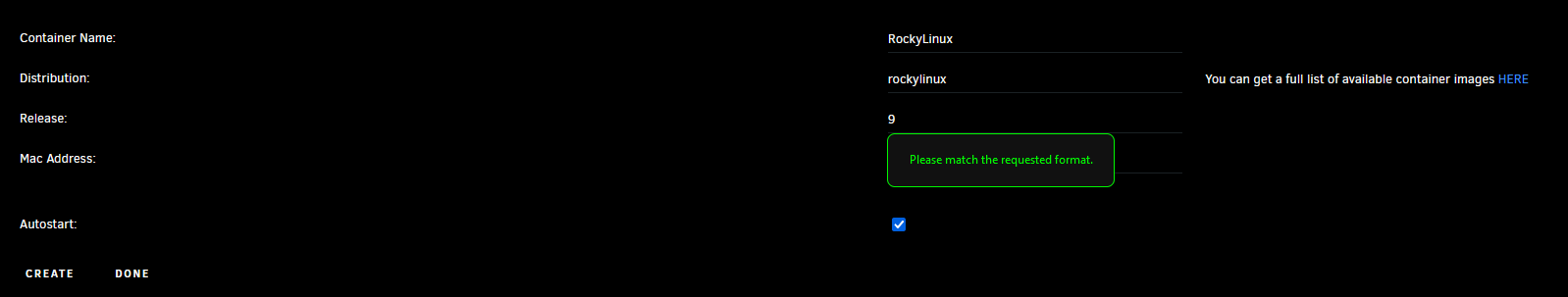

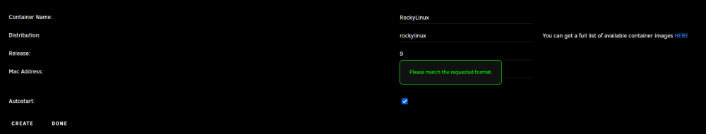

Containers that have a version with a single character give me the error "Please match the requested format"
I see this with AlmaLinux and RockyLinux.
Is there a format that I overlooked for these versions?
Thank you for the report, will look into that ASAP.
Pushed an update to the plugin: 2022.12.11 - should be fixed, thank you for the report!

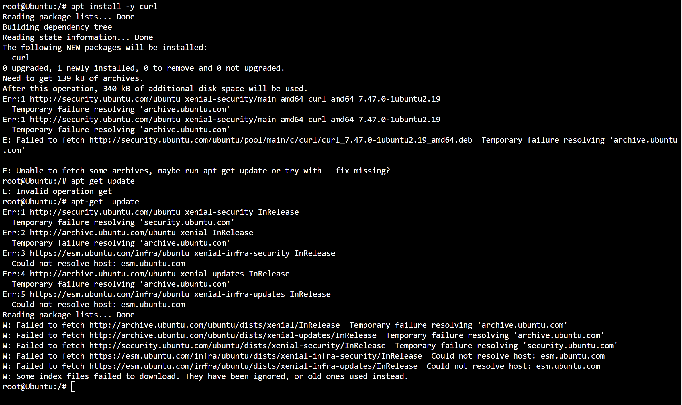

Hi
I installed LXC in Unraid.
Now I've tried to install Ubuntu, but no matter which Ubuntu I use I can't do packages like "curl" or apt get update/ upgrade because I always get errors.
Why is that?
37 minutes ago, Lucas Mietke said:
Why is that?
On what Unraid version are you?
Did you read the first post about cgroup v2?
You have to enable cgroup v2 (will be default on Unraid 6.12) for some Distributions so that they are working properly.
Thank you very much, it works fine
