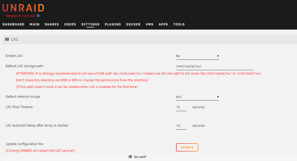

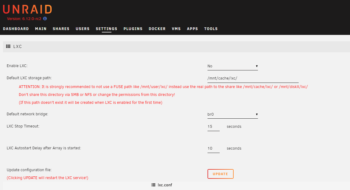

Hey, here's what I noticed:
Version: 6.12.0-rc2
- Stop LXC container
- Stop LXC service
- Switch to dashboard
- LXC containers are visible and active again
Where they not active before? Or do you mean that the service got activated again when you go to the Dashbaord?
Did you click update so that the service was disabled?
You actually don't have to stop the containers in the first place, this is done if you stop the service automatically.

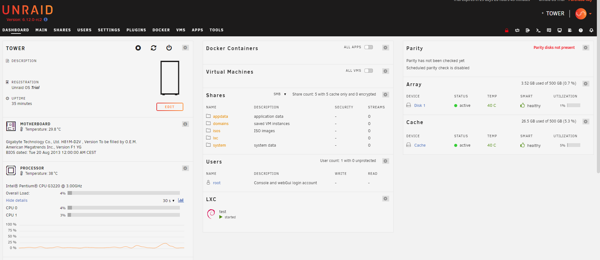

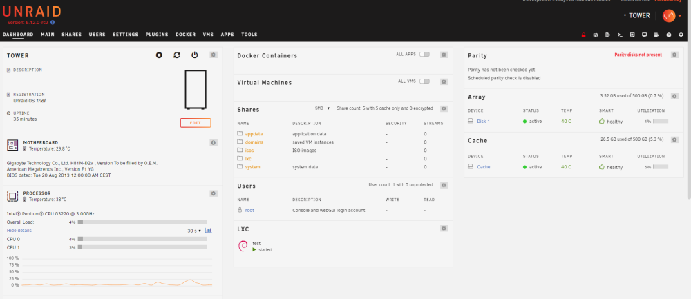

Again, a little more detail on the sequence:
  • Stop LXC container
  • Wechsel zum Dashboard - Container war beendet
  • Switch to LXC settings - Enable LXC - no
  • Click Update
  • Switch to dashboard
  • LXC containers are visible and active again
I would argue that if I disable the service, yes the containers should not start again.
Maybe even remove the display from the dashboard when the service is disabled.
I hope this is understandable so far.

I have to look into it whats the cause for that.
This seems like a bug to me that the service or better speaking the containers are started after you visit the dashboard (even if the service is disabled).
I'm assuming that the containers have Autostart enabled correct?
Please keep in mind that the Dashboard was added recently and I haven't got time to fully test everything yet, but thank you for the report, really much appreciated.
That's right.
No problem at all, I just noticed it and thought here might be the best place to report a "possible error".
