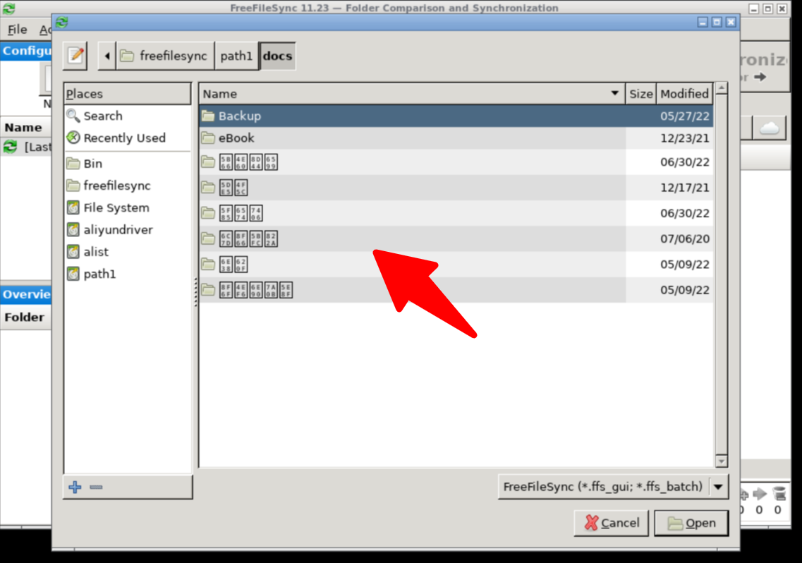

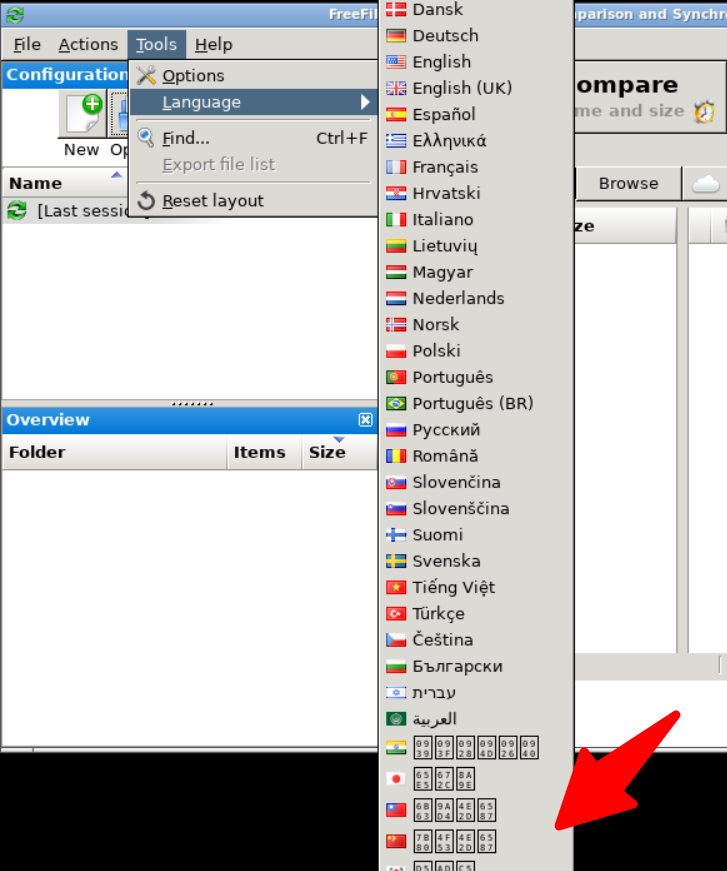

Unable to support Chinese fonts, please add Chinese font support, thank you! !
Edited by xgxxl89
Should be fixed now!

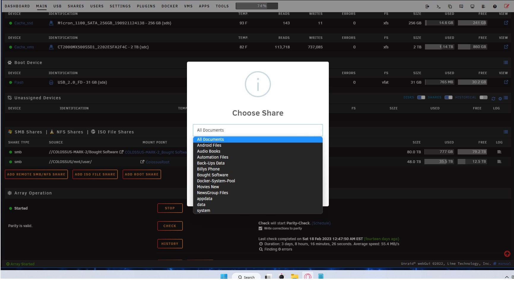

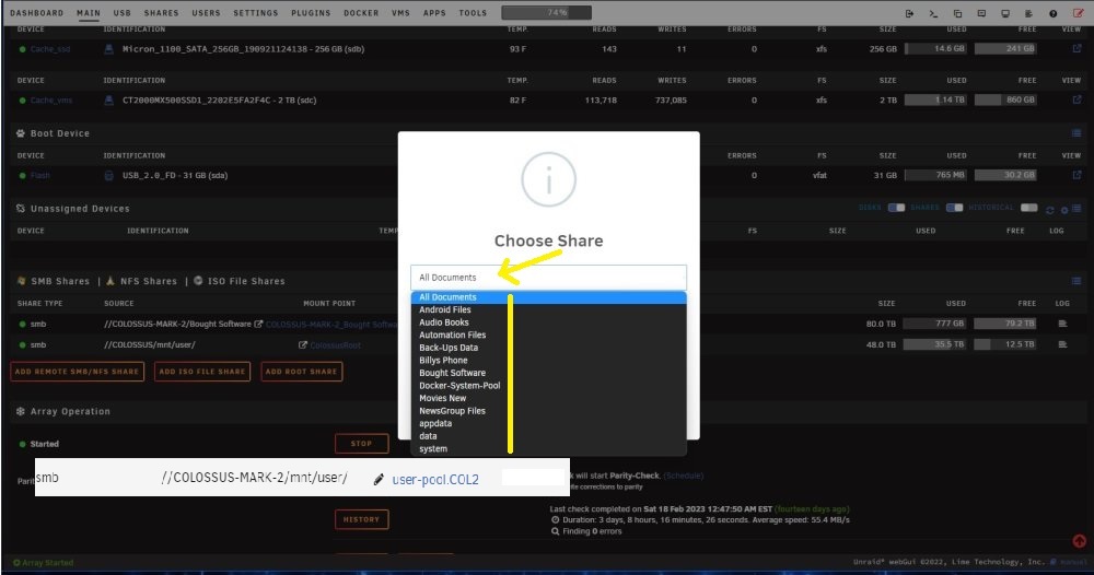

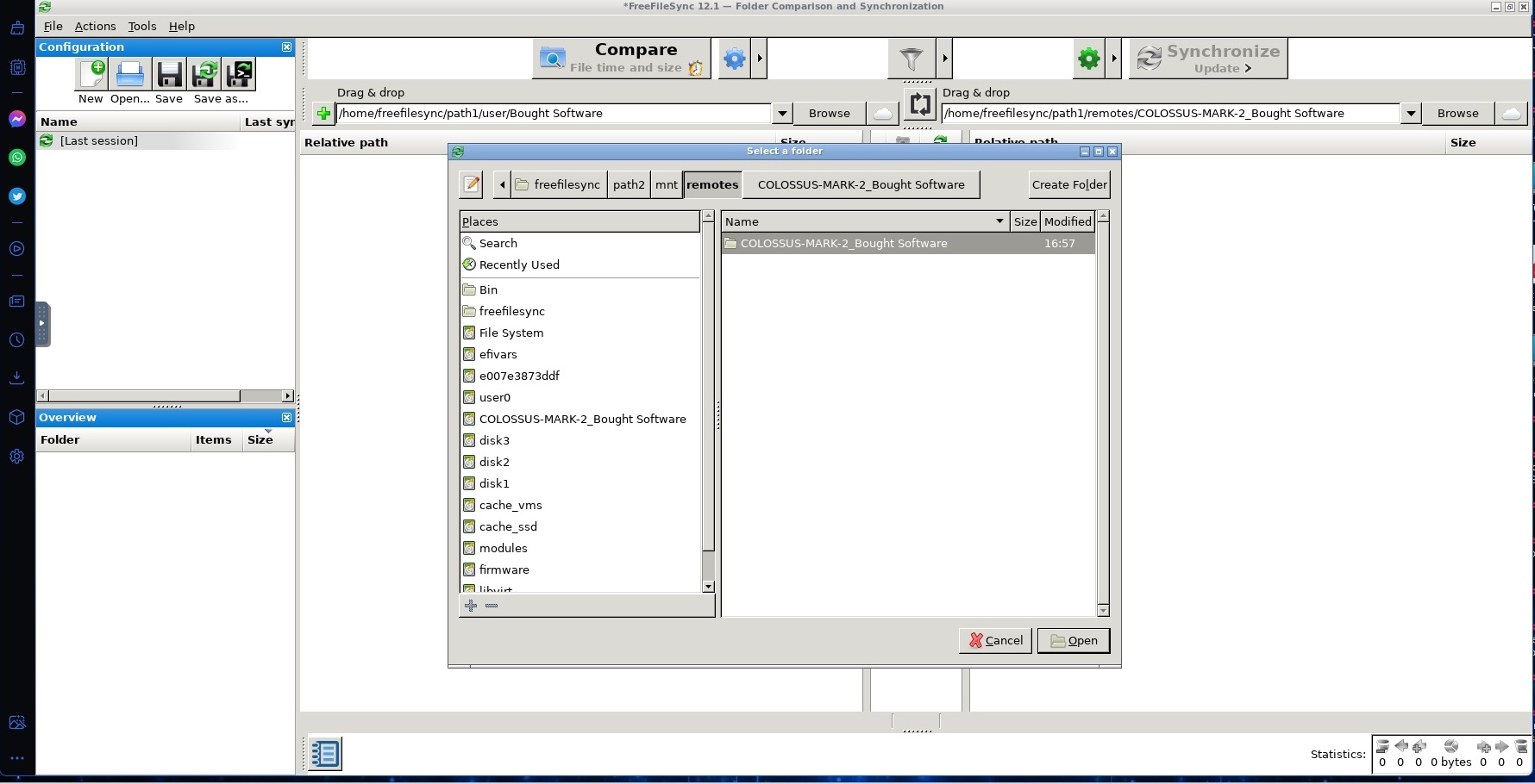

Question about filesync and using it to sync two unraid servers , before one of my servers crashed i had this working but not now, i am having to mount one folder at a time and before i could mount the root shares and use freefilesync and it would show all the folders for me at one time to sync, So i was hoping someone could let me know what im missing or doing wrong
Thanks

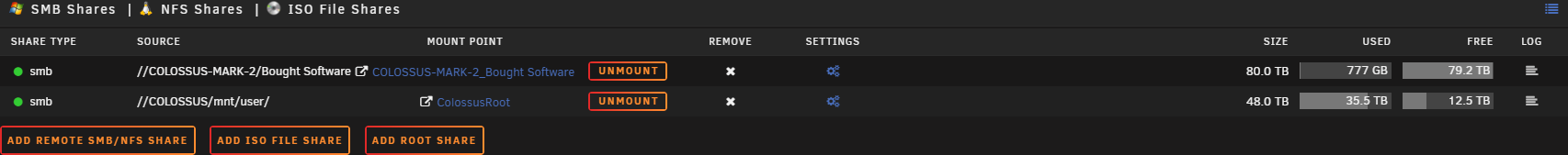

here is a screen shot of  #2- server mark-2 that i am copying files too: i have root share mounted and bought software
here is a screen shot of #1- server 1 with the source files: i can mount the share Bought Software from server 2 but only that one and not Root Share
freefilesync screenshot
unraid share list of #2 Server
What paths have you given in the freefilesync template? For remote mounts you might need to give the mounted folder instead of an upper level, and/or edit the path variable and change type to Slave mode
Also it seems you have a remote mount of itself? What would that be for?
Edited by Kilrah

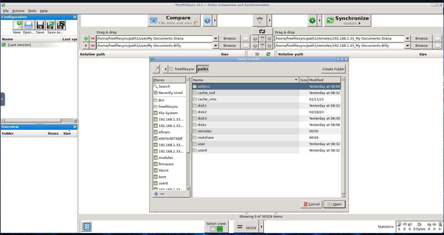

Well.. The paths you wanted i thought were listed on the pic below freefilesync screenshot above. Both are linked to /mnt:  the remote mount to itself is created when i use the add Root Share, which i assumed means it puts all your shares under one link to avoid having to do individual links to each share of that unraid server and use its Remote Root Share to get all of the shares under one link in freefilesync.   etc

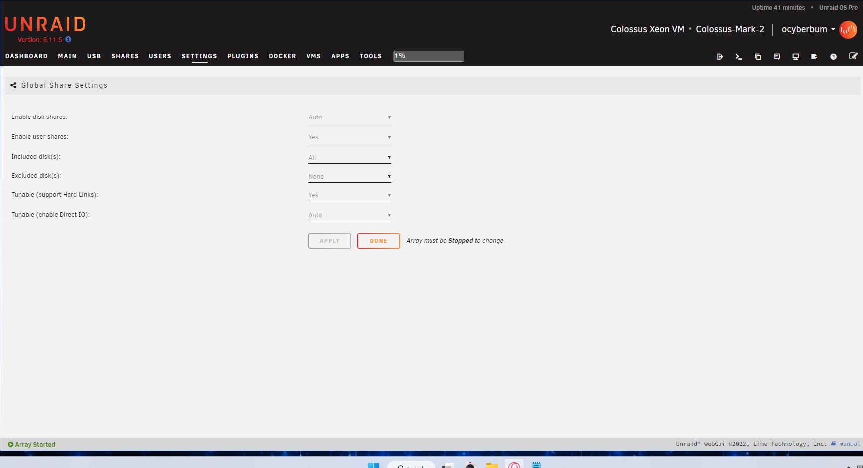

I looked at the Global Settings to see if something needed to be changed but i have never changed these before , in the FileSync Docker i have path 1 and 2 pointing to /mnt for both so last time i went to path 1 \user which list all my shares server 1 and on path 2 i goto remotes and it shows the 2 shares i added individually with "add remote shares" menu under Main Tab

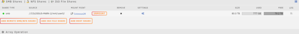

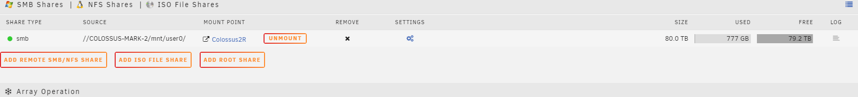

so after going over this i guess the problem im having is when i add a remote share on server #1 (the pic below) it doesn't show the Root Share user.pool.col2 for server 2, just the individual shares. if the remote share could find server 2's  user.pool.col2 in the list added below i think it would work  for sure, I am not sure why or how to get freefilesync docker itself to list all the SMB Shares by putting in a link like SMB:\\ip address or colossus-mk-2 in the box directly using the network directly

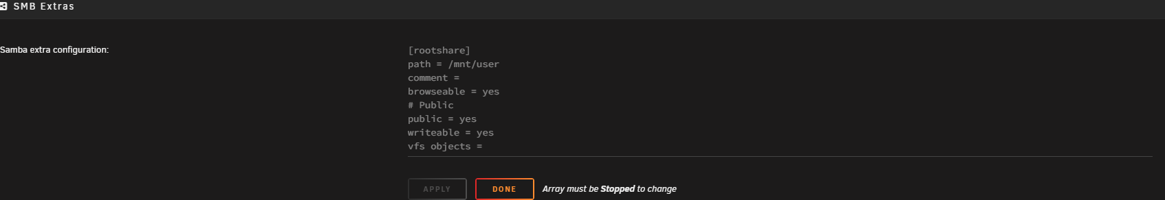

Ok after some quality google time and thinking about what Kilrah said ... i believe i found out what i did last time to get my all my shares to show in freefilesync with 2 unraid servers, This spaceinvaderone video gave me the how 2 to create the rootshare
https://www.youtube.com/watch?v=TM9pPz732Gc&t=158s&ab_channel=SpaceinvaderOne
for a public share (not advised)
[rootshare]
path = /mnt/user
comment =
browseable = yes
# Public
public = yes
writeable = yes
vfs objects =
Code used in the video.
For a share with security
[rootshare]
path = /mnt/user
comment =
browseable = yes
valid users =
write list =
vfs objects =
Thank You Kilrah and SpaceinvaderOne for the video, now i can sync all my files with ease!
