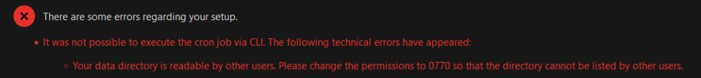

kftX Posted March 26, 2023 Share Posted March 26, 2023 (edited) I'm wondering, every time I start my server I get the "your directory is readable by other users" error. After bashing into the container and running chown -R www-data: /var/www/html the docker becomes useable normally but if I go to my admin panel I see this: And I can't get it to go away, which would be nice to get the Recognize app working. Any idea how I can solve this? Edit: For clarification's sake, I've had this error ever since I installed the docker, even though it only works with a unraid share that's limited to one hard drive only. Edited March 26, 2023 by kftX Quote Link to comment
Kilrah Posted March 27, 2023 Author Share Posted March 27, 2023 What unraid version? Should change the perms to 0770 on the share folder itself from unraid terminal, not from within the container. Quote Link to comment
kftX Posted March 27, 2023 Share Posted March 27, 2023 4 hours ago, Kilrah said: What unraid version? Should change the perms to 0770 on the share folder itself from unraid terminal, not from within the container. Unraid 6.11.5 How do I change the perms from terminal? I remember trying to do that initially and only breaking it further. Also do I do it from within the nextcloud container or just as unraid root? Thanks for your time! Quote Link to comment
Kilrah Posted March 27, 2023 Author Share Posted March 27, 2023 chmod 0770 /mnt/user/<yournextcloudshare> in unraid terminal 1 Quote Link to comment
kftX Posted March 27, 2023 Share Posted March 27, 2023 46 minutes ago, Kilrah said: chmod 0770 /mnt/user/<yournextcloudshare> in unraid terminal I did that and NextCloud still works, but the message is still there telling me to chmod the folder. I did stop the docker, run the command and then start the docker again to make sure it'd work. Quote Link to comment
Kilrah Posted March 27, 2023 Author Share Posted March 27, 2023 Can you show your template values? Quote Link to comment
