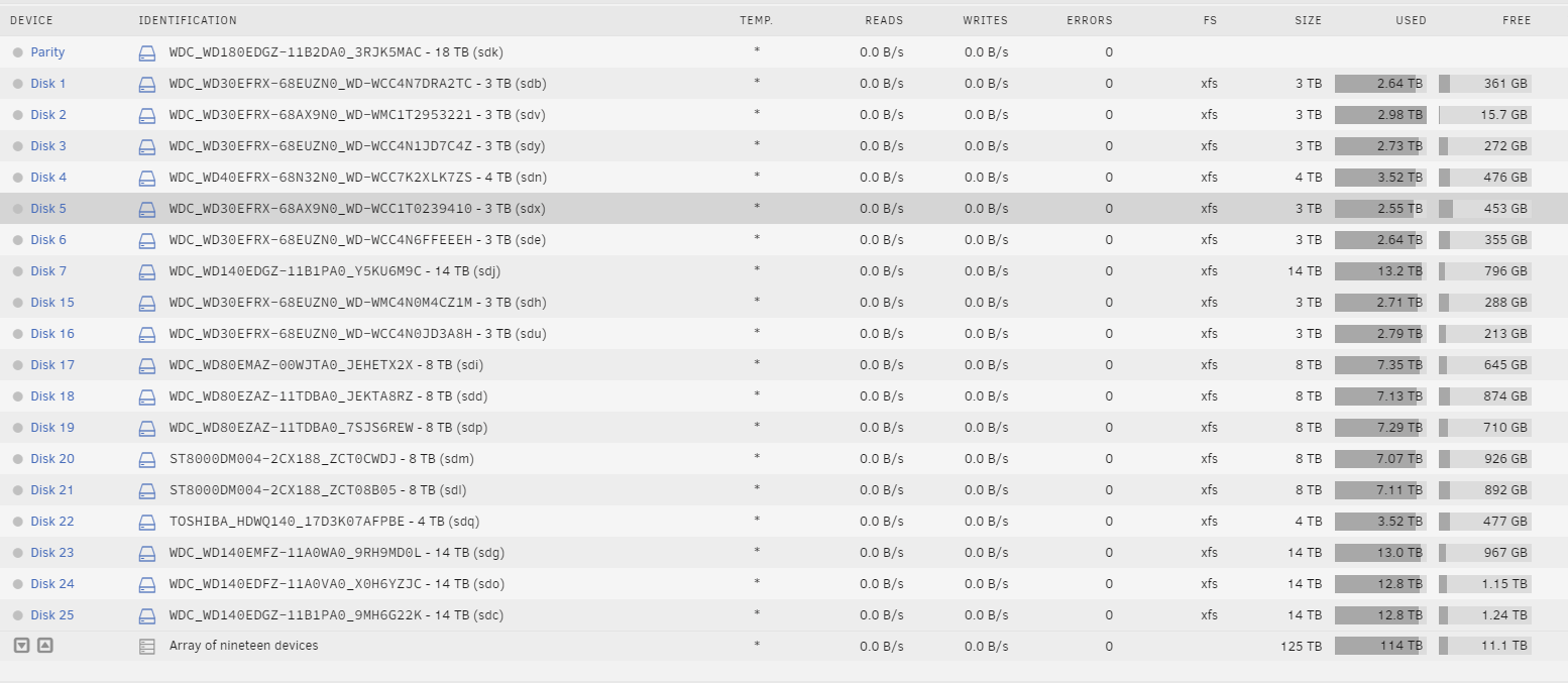

Post a screenshot of Array Devices
I am trying to reduce my number of disks down to 8 in total so I do not need to power up the diskshelf. So the 3 , 4Tb  and some of the 8Tb drives will be going. I have a 14Tb and another 18Tb to add.

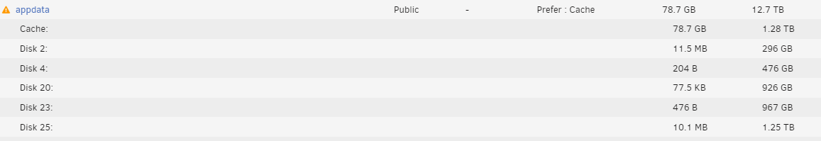

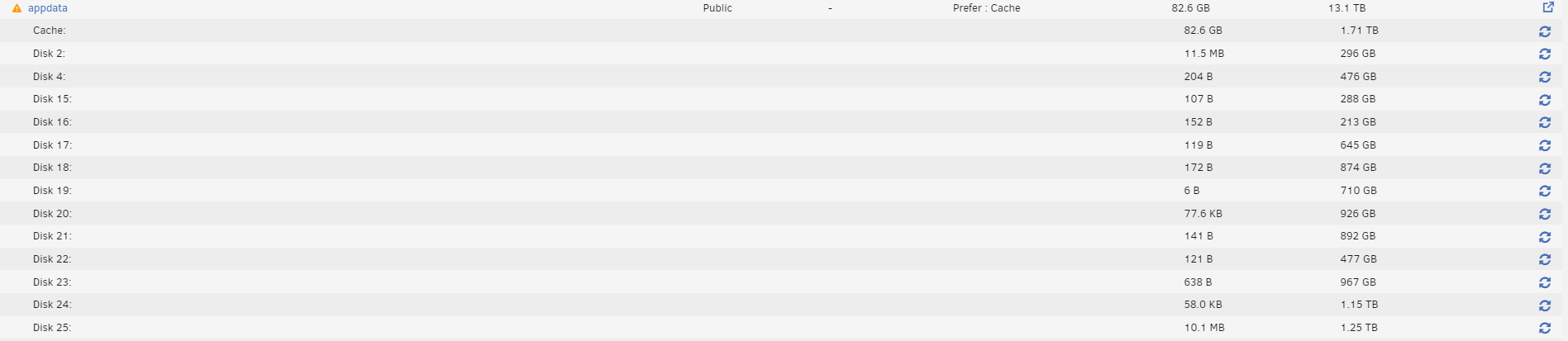

Post a screenshot of Compute... for appdata.

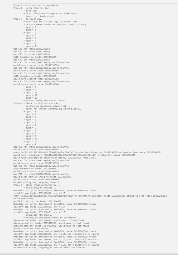

Then check filesystem on disk24
Appdata Compute, checked file system on 24 but it has errors

I have repaired the file structure on disk25 and re run the mover and this is what I get,

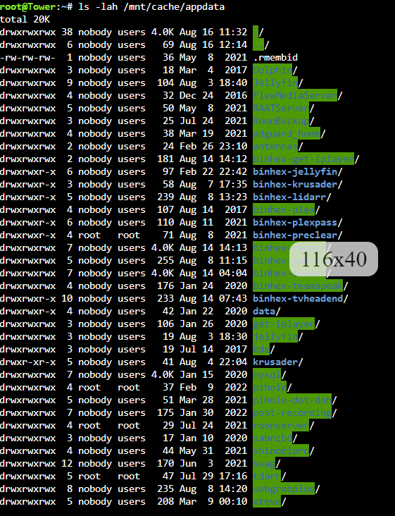

And what do you get from command line with this?
ls -lah /mnt/cache/appdata
There you go
As you can see, the appdata folders on the array are also appdata folders on cache.
