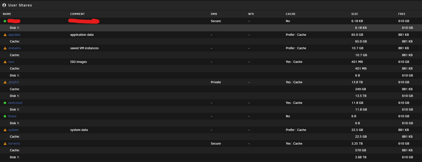

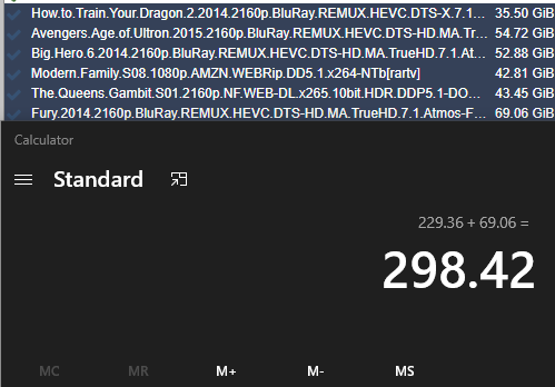

So first off here are the files that I am deleting. I am deleting them straight from the application (qbittorent) Note: I also tried deleting them directly using "rm" inside the console to the same effect so I don't think qbittorent is the culprit/hanging on to ghost files since restarting the should in theory clean them.
Note this is in Gibibyte (GiB)

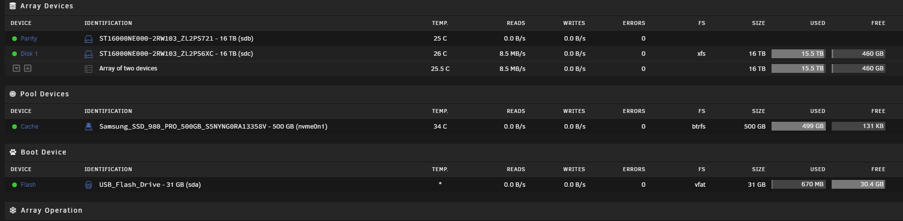

Now, here is the before space available (note the FREE space for disk1)
Also With the Shares just to be sure (Note the SIZE for the torrents share) (I included everything here just to be sure that I am not overlooking something)

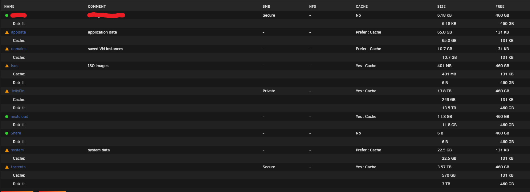

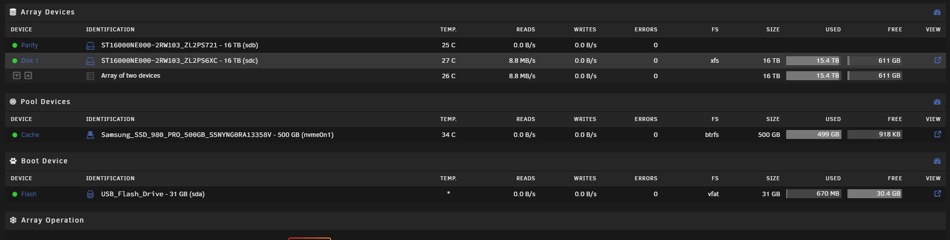

Then I deleted the file, and went and watch the FREE size inside the MAIN tab increase. But, the increase fell short of what I expected to gain (~320GB)555904908_Screenshot2022-10-19003833.png.2340c34ed96c31411620e9e451488563.png
So now here are the after pictures
Only an increase of ~151GB reported from the Main Tab
1637347751_Screenshot2022-10-19003628_AFTER.thumb.png.49bce88a649a2917d0b8dba06cf368b3.png
But what I find interesting is that the Share "torrents" SIZE decreased by ~320GB (the expected value)
Normally I wouldn't really mind but the mover seems to use the value from the Main Tab and that leaves me with less space than I actually have.

Filesystem      Size  Used Avail Use% Mounted on
/dev/md1         15T   15T  429G  98% /mnt/disk1
/dev/md1         15T   14T  569G  97% /mnt/disk1
Looks to me like it's a XFS problem with how it's reporting the used space, IIRC there have been a couple of users complaining of something similar recently, if you look at the df output from both diags they agree with the GUI (note that df uses GiB so you need to convert to GB), on the other hand share usage calculation actuality calculates the used space by all the files in a share, it doesn't not look at the free space, so that's why that's correct, my best guess is that you will need to wait for XFS to fix this in an upcoming kernel.
