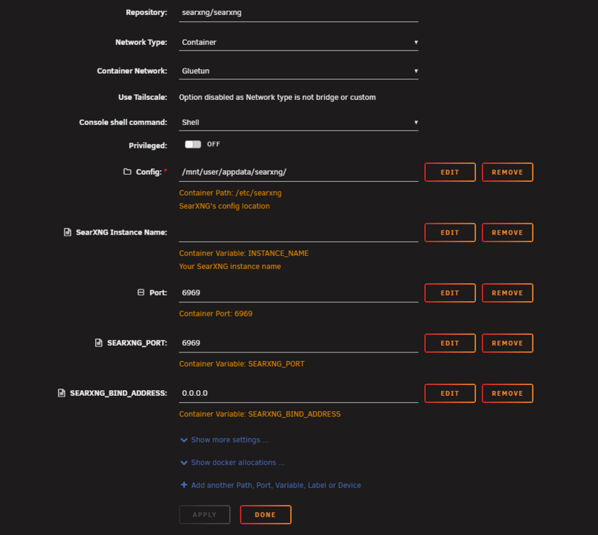

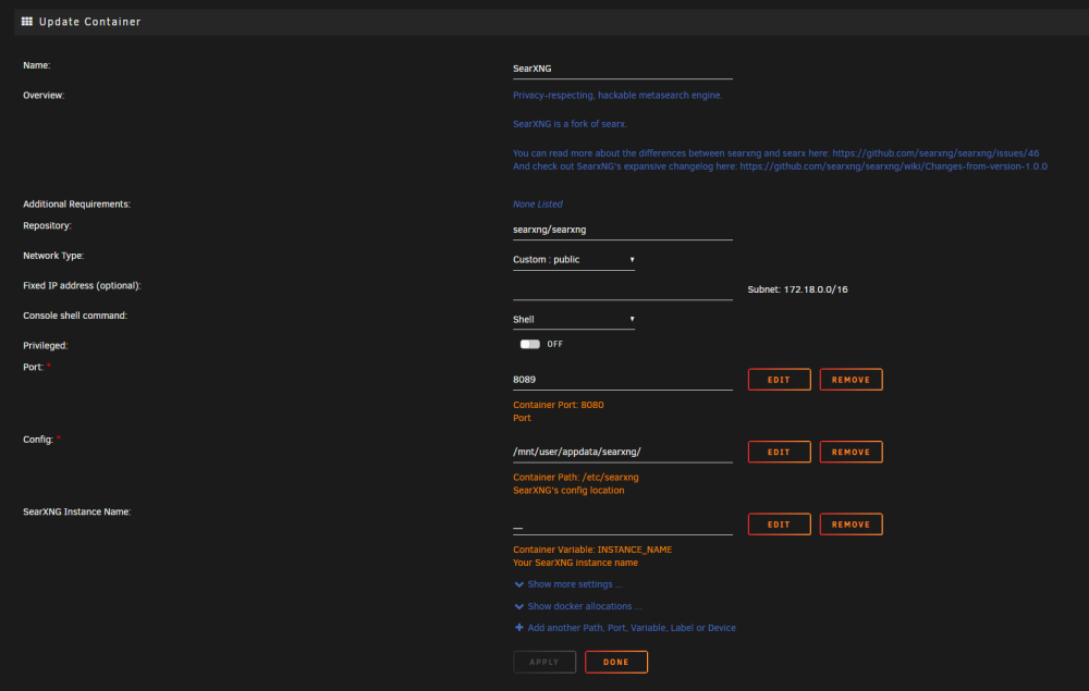

Hi, just installed SearXNG yesterday and having a bit of difficulty routing traffic from SearXNG through my Gluetun container. Has anyone been able to do this? I have no issues running my *arr stack as well as Overseerr and qBittorrent through Gluetun and have been successfully for quite some time. When setting the SearXNG container "Extra parameters" to --network=container:GluetunVPN and "Network type" to "None", the SearXNG container will not start. Running without routing through Gluetun works fine. Any help would be great!
  • Unraid: 6.12.15
  • SearXNG: 2025.6.12+a6d0333
Here are the logs that I'm getting:
[uWSGI] getting INI configuration from /etc/searxng/uwsgi.ini
[uwsgi-static] added mapping for /static => /usr/local/searxng/searx/static
*** Starting uWSGI 2.0.30 (64bit) on [Fri Jun 13 16:20:13 2025] ***
compiled with version: 14.3.0 on 03 June 2025 19:30:19
os: Linux-6.1.126-Unraid #1 SMP PREEMPT_DYNAMIC Sun Jan 19 15:51:34 PST 2025
nodename: f42734efbf89
machine: x86_64
clock source: unix
detected number of CPU cores: 8
current working directory: /usr/local/searxng
detected binary path: /usr/local/searxng/venv/bin/uwsgi
!!! no internal routing support, rebuild with pcre support !!!
setgid() to 977
setuid() to 977
chdir() to /usr/local/searxng/searx/
your processes number limit is 126890
your memory page size is 4096 bytes
detected max file descriptor number: 40960
building mime-types dictionary from file /etc/mime.types...1390 entry found
lock engine: pthread robust mutexes
thunder lock: disabled (you can enable it with --thunder-lock)
probably another instance of uWSGI is running on the same address ([::]:8080).
bind(): Address in use [core/socket.c line 769]
SearXNG 2025.6.12+0b877f1
... INFORMATION
... Update available for "/etc/searxng/uwsgi.ini"
... It is recommended to update the configuration file to ensure proper functionality
... New version placed at "/etc/searxng/uwsgi.ini.new"
... Please review and merge changes
... INFORMATION
... Update available for "/etc/searxng/settings.yml"
... New version placed at "/etc/searxng/settings.yml.new"
** Press ANY KEY to close this window **
On Unraid 7 you should be able to select the container directly in the dropdown, but no idea if it'll help.

For people struggling with Gluetun its pretty straight forward to modify the container without ripping it apart.
Set network mode to "bridge" delete the old port. Add a new port w/ a new container port while in bridge mode. Switch the networking mode back to Container, select your gluetun container. Add the two environment variables that control the searxng server binding.
Bob's your uncle.
