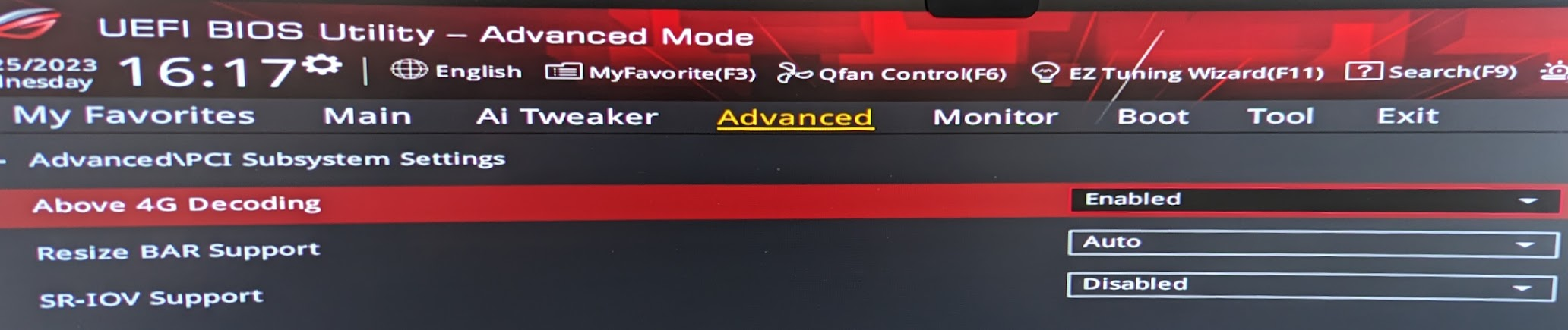

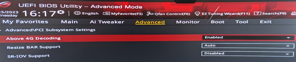

Do you have Above 4G Decoding enabled in your bios?
Yes.
Above 4G Decoding: Enabled
Resize BAR Support: Auto (other option is Disabled)

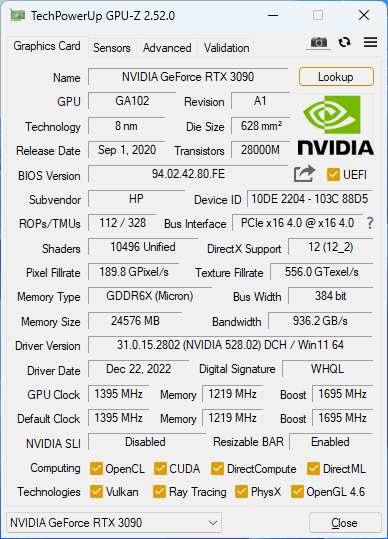

Great find, this worked for me after I was getting a blank screen and VM won't boot as soon as I turn on Resizable BAR in the BIOS. It worked fine bare metal, so I knew it was something to do with KVM but didn't know what.
I have an HP RTX 3090, motherboard is an ASRock ROMED8-2T (with beta BIOS that has ReBAR support and is not public yet).
Here's the GPUZ info from the VM:
Here's my lspci dump for the card:

Looks like I figured it out, I had left out the steps to add the extra lines to my Win11 VM, which enabled 64GB ReBAR support.
So looks like the checklist to enable this:
- Host BIOS Enable ReBAR support
- Host BIOS Enable 4G Decoding
- Enable & Boot Custom Kernel syslinux configuration (near beginning of this thread)
- Boot Unraid in UEFI Mode
- VM must use UEFI BIOS
- VM must have the top line of XML from <domain type='kvm'> to:
<domain type='kvm' xmlns:qemu='http://libvirt.org/schemas/domain/qemu/1.0'>
- VM must have added the following (after the </device> line, before the </domain> line):
  <qemu:commandline>
    <qemu:arg value='-fw_cfg'/>
    <qemu:arg value='opt/ovmf/X-PciMmio64Mb,string=65536'/>
  </qemu:commandline>
After that, looks like everything worked for me as well.

Just a heads up, the custom kernel wasn't necessary for me with my RTX 3090, just adding the additional xml to my VM config was enough.
