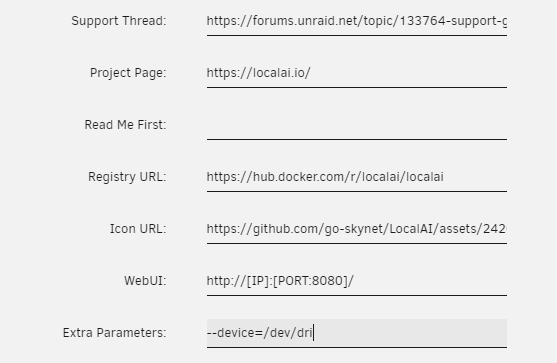

Krakout Posted August 10 Share Posted August 10 Can someone help me install LocalAI with AMD support? I don't understand the instructions about adding devices and variables... " For AMD GPU support, add "/dev/kfd" and "/dev/dri" each as a Device and add the required Variables: https://localai.io/features/gpu-acceleration/#setup-example-dockercontainerd" Thanks! Quote Link to comment
bmartino1 Posted August 10 Share Posted August 10 (edited) 10 hours ago, Krakout said: Can someone help me install LocalAI with AMD support? I don't understand the instructions about adding devices and variables... " For AMD GPU support, add "/dev/kfd" and "/dev/dri" each as a Device and add the required Variables: https://localai.io/features/gpu-acceleration/#setup-example-dockercontainerd" Thanks! not possible. the models won't use the amd gpu. I recommend using the AIO gpu hib version: localai/localai:latest-aio-cpu to add the gpu if any for amd to a docker. --device=/dev/dri --device=/dev/kfd add the above to the extra parameter option: I see they finaly updateed and fixed it. Edited August 10 by bmartino1 redaction. 1 Quote Link to comment

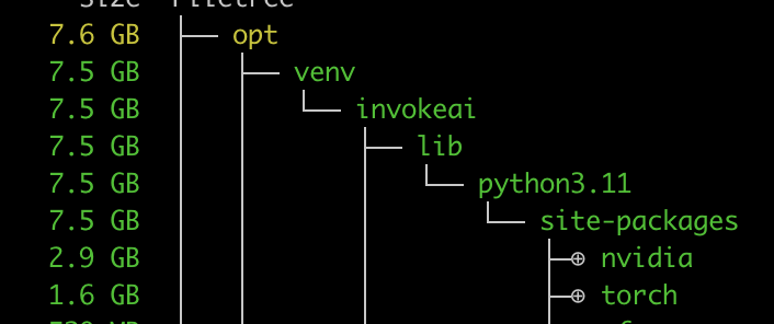

disco4000 Posted September 8 Share Posted September 8 Hi, the Invoke-AI container is pulling 4,5GB with every update almost every next day. Do all these big files really change everytime there is an update or ist this a misconfiguration in the docker build file? Cheers, d. Quote Link to comment
grtgbln Posted September 8 Author Share Posted September 8 (edited) 3 hours ago, disco4000 said: Hi, the Invoke-AI container is pulling 4,5GB with every update almost every next day. Do all these big files really change everytime there is an update or ist this a misconfiguration in the docker build file? Cheers, d. I doubt the underlying dependencies are actually changing, but part of the Dockerfile build file is importing things like NVIDIA SMI and PyTorch on every build, without caching these layers, which unfortunately leads to having to redownload these base layers every time the image updates. https://github.com/invoke-ai/InvokeAI/blob/5eb919f6020118764b8b5ece4f7660bd31f52472/docker/Dockerfile#L36 Edited September 8 by grtgbln Quote Link to comment
