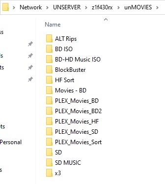

I've put the disk we reiserfsck(ed) back in, as an unassigned device...and mounted it. Now...if I browse it through Windows; I see a lot of my file structure intact
My shares...and my dirs in those shares

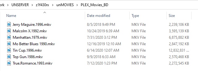

In some cases..."recovery" seems quite intuitive. Here are some movie-files (don't judge), that seem intact. Copy them back into the array; ta-da!

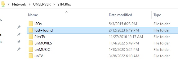

I don't seem to have access, to lost+found...through Windows (a permissions thing). But browsing it through "unRAID"...I have lots of this (as previously discussed)

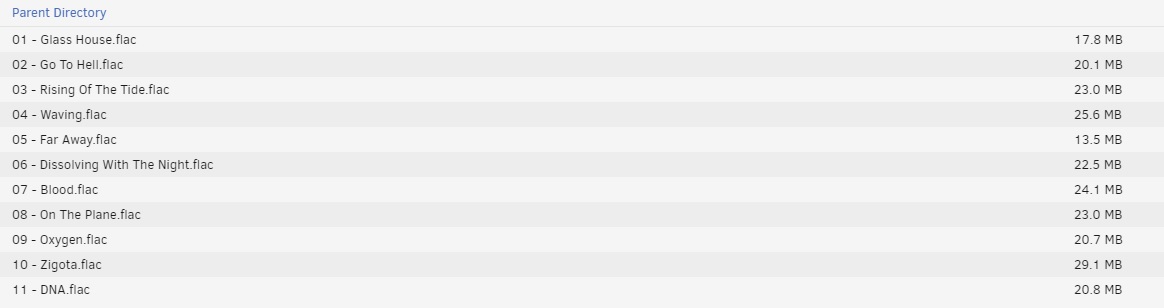

And if I go into 6_215, for example; there is Welcome to my DNA (an album rip)...seemingly intact
So...is this what it is; just scouring around, every nook and cranny of this ~3T disk...looking for intact data? Or am I missing something...much, much easier?
This almost certainly means that it was just the container folder name that was lost so if you recognise the contents you can rename that folder back to what it should be and then put it into its correct place in the disks folder structure.
The hardest things to sort out would be any files that now only have the numeric cryptic name.   As was mentioned the Linux file command can give you the file type (and thus it’s likely file extension) if you want to examine these further.
It is a user share just like all top level folders.
Go to its settings to make accessible.
Sorry, my confusion. It isn't a user share since it is on an unassigned disk.
If you have sharing turned on for that disk and you still can't see it on the network, check the Settings for Unassigned Devices. It has pretty good Help for that page, you can toggle Help on/off for the whole webUI by clicking Help (?) on the main menu bar.
^ I can see the disk...and every dir, except lost+found.
What do you get from command line with this?
ls -lah /mnt/disks/Z1F430RX
chmod -R 777 /mnt/disks/Z1F430RX
chown -R nobody:users /mnt/disks/Z1F430RX
then
