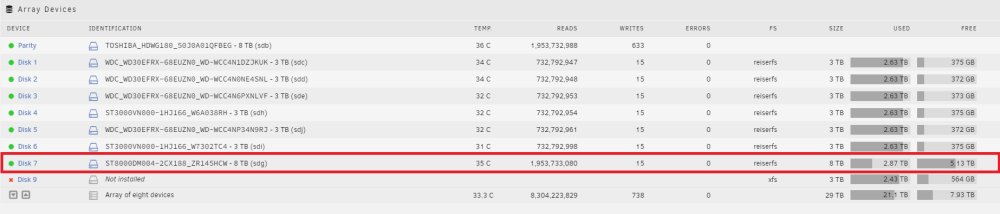

Yeah; I didn't even look closely enough, at a simple indicator. This is the new 8T...and it should have more like 5+T used; the almost 3T, from the drive it replaced...and like 2.5 that I was trying to copy.
So...to-be-copied drive back in, and try unBALANCE again?

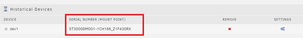

I also just noticed this...
I was thinking, 430RX...was the to-be-copied drive; but it's actually the drive, the new 8T (45HCW) replaced.
Just FYI.

45HCW (8T), replaced 430RX (3T). 55926 (3T) is the drive, I wanted to copy to 45HCW...after it replaced 430RX (with the procedure, documented above).

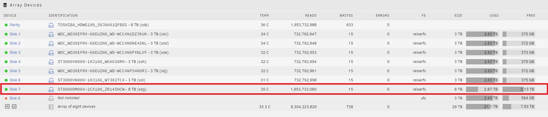

Just noticed from your screenshot your drives are reiserfs. You need to work on getting away from that completely.
We should have been working on that instead of rebuilding that filesystem onto new disks.

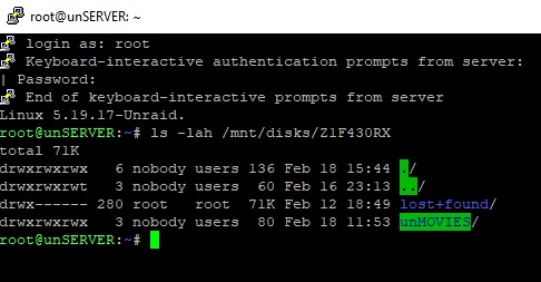

Yes; and let me elaborate...
430RX was removed from the array, and replaced with 45HCW (and I still have 430RX, untouched since it was pulled).
I also have 55926...which I thought I had copied to 45HCW; but which obviously didn't take (and I too, have that...and did not do a move data from it; but a copy. Point being, even though it didn't work; as opposed to a failed move...it was failed copy. Therefore...55926, should be exactly as I pulled it.
TY,

Just zoomed in on your screenshot and I see the missing disk is actually disk9, not disk8.
Why is there a missing disk?
