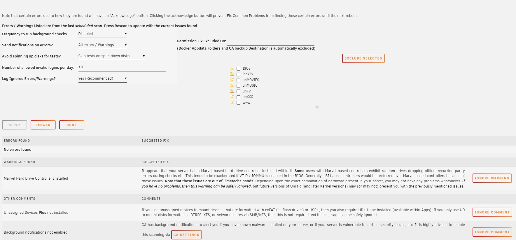

^ So...I started the array (w/o Parity), to get a "full" Fix Common Problems scan. Here are the results (after ignoring the ReiserFS warnings, because we're fixing those anyway)...
Is there anything to do? Can't really help, my old board and/or "Marvel controller" (perhaps of the case, and/or backplane).
Fix Unassigned Devices PLUS? Turn on Background Notifications? Fine; but don't seem like "show-stoppers"?
FTR...I don't know how, to run a Docker Safe New Permissions command. Sorry.
Edited by CDLehner
You don't need to worry about any of that FCP right now.

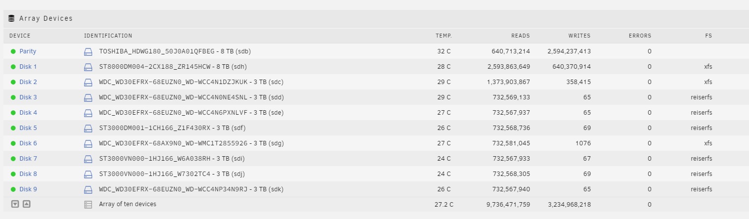

On 1/28/2023 at 11:32 PM, trurl said:
That looks good. Before we build parity, let's take a look at the data disks with the array started.
Unassign parity, start the array in normal (not maintenance) mode, then post new diagnostics
Sorry brother; I thought we were still reverting back to this...until we were ALL done.

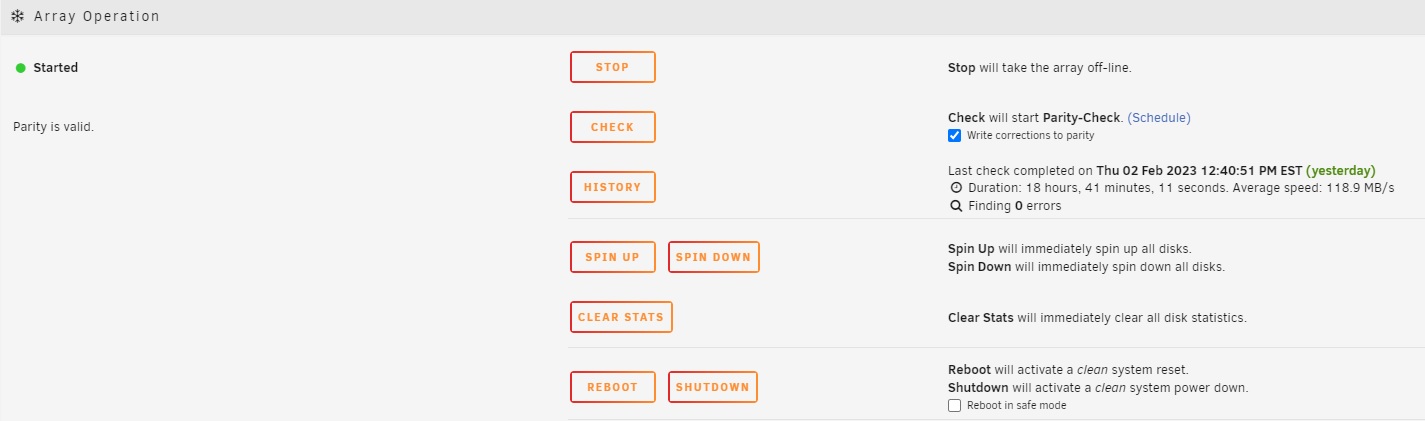

I've put the Parity disk back in, and it's re-building (~18 hours). And...we'll take it from there, starting kinda fresh (already having chopped some of the wood).

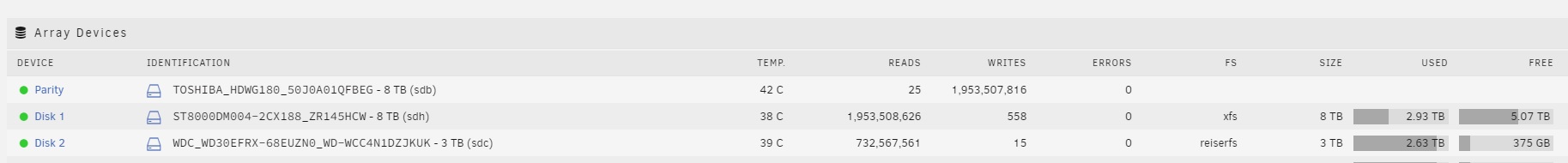

Copy finished, from disk2 to disk1. I stopped the array...changed file type to XFS; started array...gave permission to format, disk2. And then I expected hours, to format...a 3T drive. Just looks like this (after a quick acknowledgement, that it was formatting disk2)
My next step, was going to be...to copy disk3 to disk2?
Edited by CDLehner
Format doesn't write the whole disk. It only writes enough to represent an empty filesystem. Basically just an empty top level folder ready to receive folders and files. Should take minutes or less.
I suspect Windows and other GUI OS is the reason people have a very foggy idea of what format does, since it lumps together partitioning, formatting (so-called "quick format") and whatever else it does when it "formats the whole disk". The "quick format" part of that is the only thing that is really formatting.
Disk2 is xfs in your screenshot, but it is clipped on the right. I assume it is showing a mostly empty drive now.
Sounds like everything is normal. Post diagnostics if you want me to take a closer look.

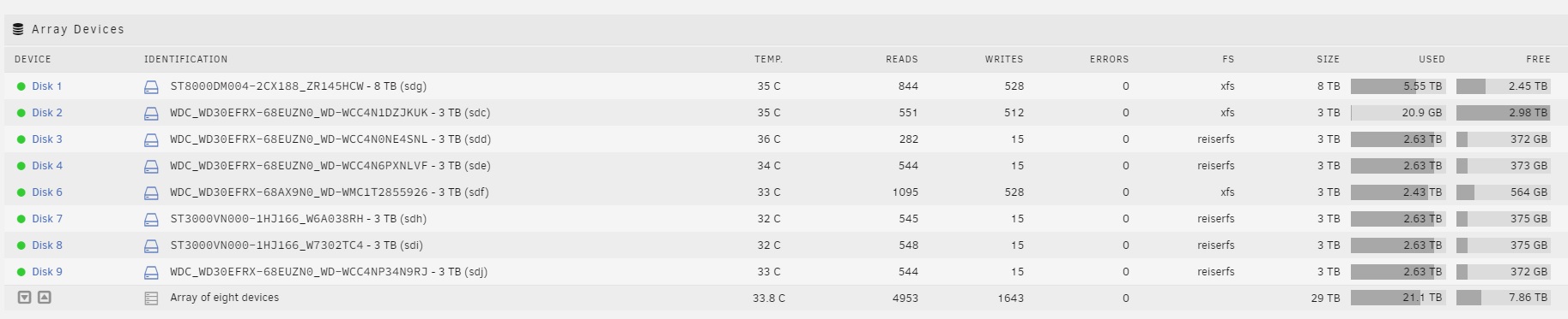

Actually...I looked back, and I'm going to do this. Unassign parity (now that disk5 is removed, and New Config has been run)...start the array in normal/not maintenance mode; and post that diagnostic.
Awaiting further instruction. Thanks
unserver-diagnostics-20230203-1827.zip
Don't understand where you are going with that. I assume you want to run with parity.
If you want to "close the gap" between disk4 and disk6, you could reassign disk9 as disk5. Or rearrange however you want with New Config, reassign parity, and let it rebuild.
Unless you have something else in mind. If so, what?
^ No, I wanted disk5…out the array. Last time I unassigned a disk…you had me start array, w/o the parity; and post a diagnostic. So that’s what I did.
I just want to get the array down to 1 + 7 (drives); but we’re also reformatting to XFS.
So…put Parity back, and do I need to re-build before I do the next copy? (disk3 to disk2)
I wanted to look at it without parity before because we hadn't built parity yet. And I guess we are in a similar situation now since parity needs to be rebuilt.
I'm not sure you understood my point about reordering the disks. Of course you want that old disk5 out, but do you want to go through the rest of your life with disks 1,2,3,4,6,7,8,9? Why not 1,2,3,4,5,6,7,8?
When you New Config you can put any disk in any slot you want. The simplest would be to take the disk currently assigned as disk 9 and reassign it as disk5, and leave all others assigned as they are. But you can change any of them you want to as long as you don't assign any data disk to any parity slot. Then assign parity and start the array to rebuild parity.
If you don't want to change any assignments, then you can just reassign parity without doing New Config and let parity rebuild.
