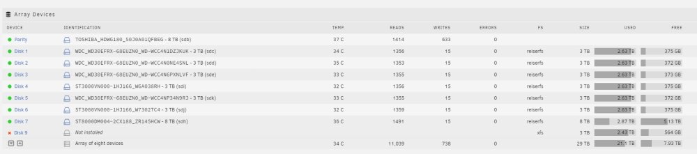

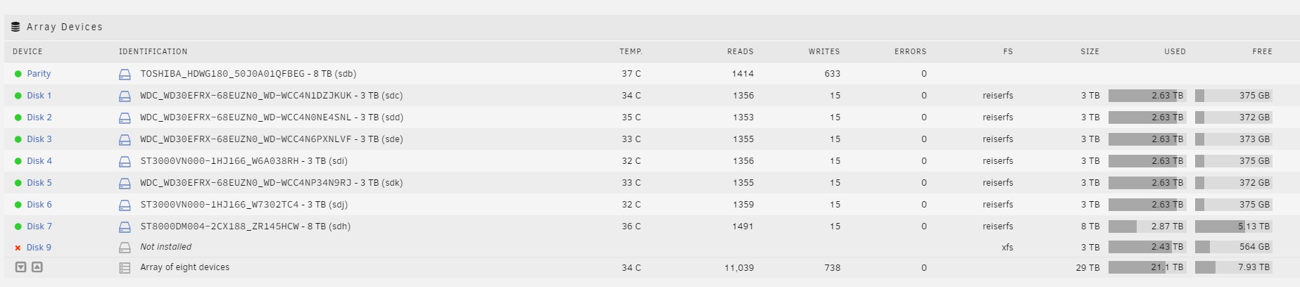

  • Just noticed from your screenshot your drives are reiserfs. You need to work on getting away from that completely.     We should have been working on that instead of rebuilding that fi
2 minutes ago, trurl said:

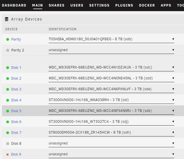

Just zoomed in on your screenshot and I see the missing disk is actually disk9, not disk8.
Why is there a missing disk?
My best recollection, is when I put the new drive in...430RX was on 9?
16 minutes ago, trurl said:
Do you have enough ports to attach all the new and old disks? I'd like to see diagnostics with all of the disks involved.
Is pulling my Cache SSD an option (for that 10th spot)?
Unless you have more larger disks you plan to install, I would forget about removing any disks until you get all disks converted to XFS.
Why is disk9 missing? It is the only XFS disk you have.

Did you unassign disk9?
I think "drive9"...is the one, not running in the bays (on break-out cables).

Did disk9 disconnect on its own and now it is an unassigned disk?
Why isn't there a disk8?
Or
You thought you had copied disk9 to the new disk7, so you removed it? Is that what happened?

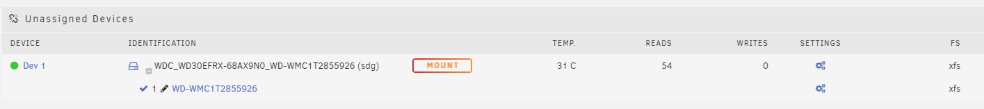

Is unassigned dev1 the disk that was disk9?
anonymized is OK.
Yes; I'm pretty sure.
