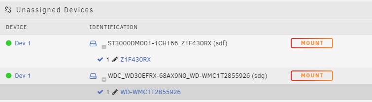

^To be CRYSTAL clear: I started off, with 7 drives…plus 430RX and 55926.
I think I’ve REPLACED 430RX, and did a failed copy of 55926.
55926, is the XFS drive. Do you want 55926 ALONE (and then that would be with the new 8T drive. In the array that is); or do you want 55926 AND 430RX BOTH back in (and therefore the new 8T OUT)…and just kind of “start over”??

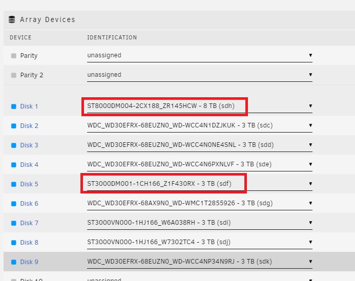

Then remove cache, install all the HDDs, New Config to assign as you wish. Don't start the array. Post a screenshot of Main - Array Devices and new diagnostics and wait for further advice.
Do I want to 'preserve current assignments'?

Did you say, I could go ahead and change assignments...right? (not that it really matters)

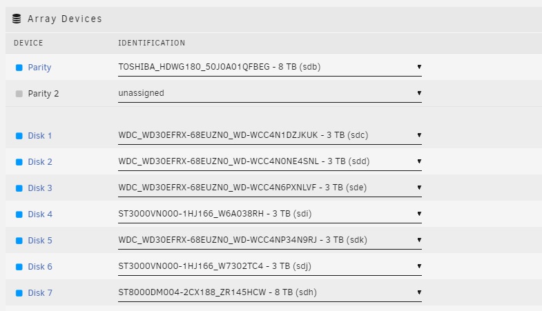

12 hours ago, trurl said:
You can rearrange disks as you want as long as you keep parity in the parity slot.
That looks good. Before we build parity, let's take a look at the data disks with the array started.
Unassign parity, start the array in normal (not maintenance) mode, then post new diagnostics

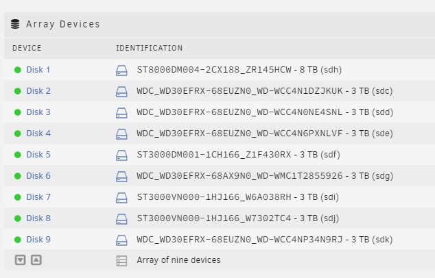

Are you sure I still want 430RX in this array? I ask because I'm fairly confident, 430RX was replaced by 45HCW; it's just that 55926 wasn't copied to 45HCW.
Looks like you unassigned parity as I asked, now
Yes, because we are going to do that all over. That large new disk contains the files from the drive it was rebuilt from, but unfortunately, those files are all still reiser filesystem. We need that large new disk to be empty xfs so we can copy files from reiser disks to it, including that disk you had already replaced.
OK. those 9 data disks mount and have plenty of contents. Looks like disk1 has the same amount of files as disk5, which it had replaced in the earlier configuration.
Stop the array, assign parity, and let parity build. Wait for that to complete and post new diagnostics.
Or if it seems to be having problems building parity, post new diagnostics. You don't seem to have the connection problems many do, probably because of backplane, so I expect parity build will go smoothly.
^ ~19 hours

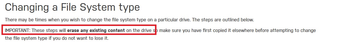

In your current configuration, instead of emptying a drive so we can reformat it, we are just going to start with a new empty disk1 (as mentioned in that wiki), formatted as xfs, since all your data is on the other disks.
Now, what we want to do is reformat that new 8TB disk1 as xfs.
https://wiki.unraid.net/Manual/Storage_Management#Changing_a_File_System_type
Only change the format of disk1, we can't reformat any others until we copy their data.
Pay very close attention to step 5. Don't format unless disk1 is the only one listed for formatting.
