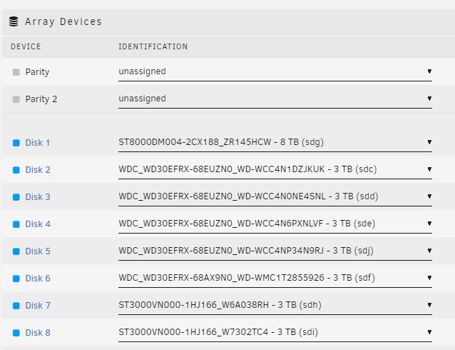

9 minutes ago, trurl said:
do you want to go through the rest of your life with disks 1,2,3,4,6,7,8,9?
No sir; I'm pretty OCD.
So, now...Parity back and re-start array; before I copy disk3 to 2?
If I put Parity back in...will I have to wait for a re-build before the copy?

You don't have valid parity now. If it were me I would want valid parity before I did anything with my data.
OK; I think we're back on track now...
After the re-build, I'll post a diagnostic; and if all looks good...I assume I can go back to copy, re-format, copy?

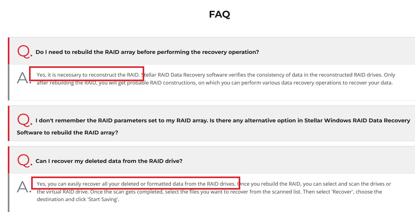

Someone lent me a copy, of Stellar Data Recovery Technician 10.2
I'm just a little confused, about how to go about the recovery. And while I know those here, aren't neccesssarily here to give advice about Stellar per se; I'm looking at their FAQ...
...and I'm wondering: if this is something that needs to be done, "inside" the array; or can I do something as simple, as drop that drive...into a SATA/USB dock, and recover it?

Didn't watch the video, but nothing I see on the Stellar website makes me think it will work with reiserfs
Probably the safest thing is to clone the disk, then run that reiserfsck command on the clone (as already suggested by JonathanM).
I did find this on Stellar website:
Stellar Data Recovery supports NTFS, FAT, FAT16, FAT32 and exFAT file systems.
So basically just those supported by Windows.

A few confused things in this post, mostly around filesystems. Rather than quote the confusion I will just see if I can explain things.
From what I read on Stellar, it might be able to restore a partition table whatever the filesystem. But that isn't going to mean it works with the filesystem itself. The filesystems it specifically mentions are all Windows filesystems. And we don't need it to restore a partition table since that is already there, it's just that the partition contains an empty (formatted) filesystem.
Cloning a disk is kind of like rebuilding. It will produce a bit-for-bit copy of the disk, and so, it will have the same filesystem as the original, since all those bits ARE the filesystem with all its files.
