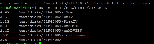

57 minutes ago, CDLehner said:
how big these dirs
du -h -d 1 /mnt/disks/Z1F430RX

Here's where I think I'm at: I'm ready to move forward, thinking this is about the best we're going to do.
1.68G looks to be lost; 2.4 of my 2.6T is in my MOVIES share.

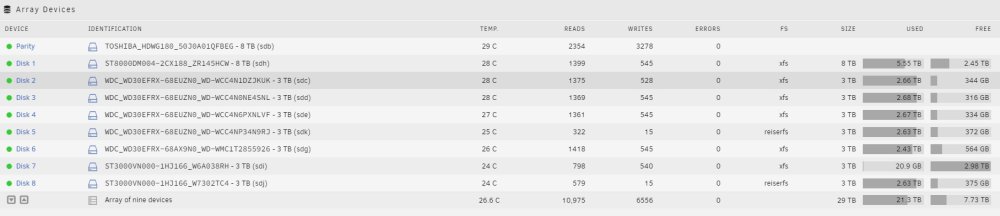

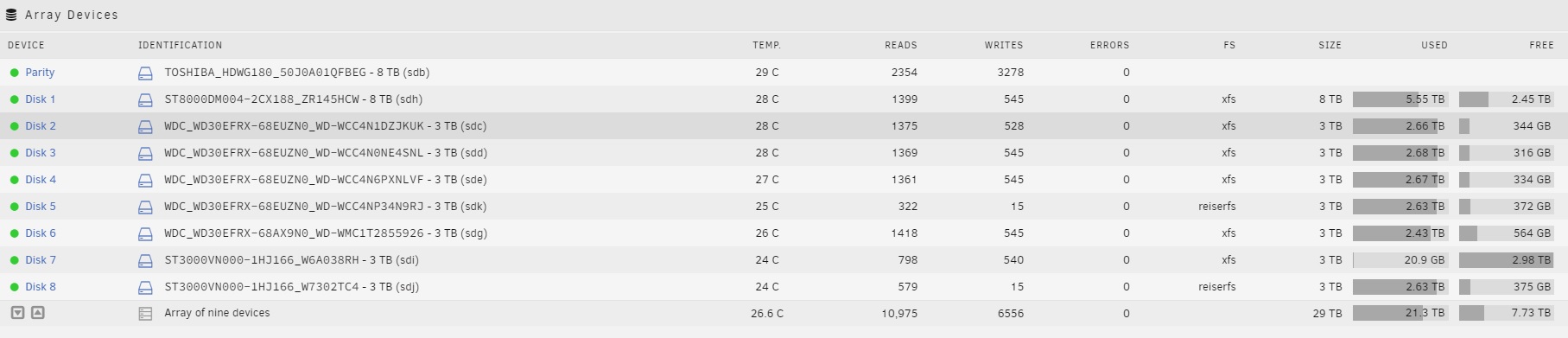

disk7 (38RH) is formatted xfs, and "blank"/disk7 (30RX) is reiserfs and is ck-recovered.
disk5 is getting formatted to xfs; and I will copy disk8 to disk5

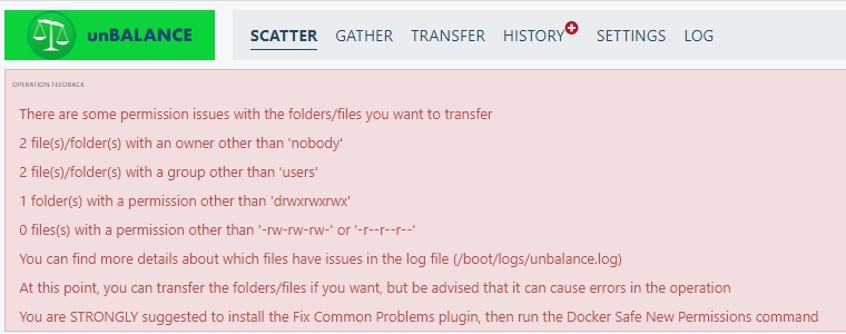

Hey trurl...I went to do my copy from disk8 to disk5, and my 'plan' threw up some of the Fix Common Problem errors I came across previously.
At that time...I think "we" decided, it was the least of our problems; considering. Do you think we should address them now...or still after this last disk copy?
Do you mean these?
Edited by CDLehner
I thought you had already fixed those since I already told you to at the time.

^ I ran Docker Safe New Permission. Then PLAN ran fine.
Dry Run Copy, 2nd Plan...copying disk8 to disk5.

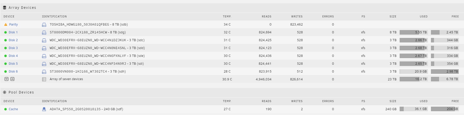

So...8 to 5 is not too far from being done. When it is...I'll format disk8 to xfs, and that'll be that; kind of.
I can run and post a diagnostic after that, if it's wanted; then I'd like to be able to...
- remove disk6 (has been copied to 1)
- remove disk7 as our accidentally formatted, and not yet "recovered" drive
- remove disk 30RX (or leave 30RX unassigned...or both 7/38RH and 30RX unassigned?)
And I'd like to get my array back up...with the 5+1 disks (the +1 being disk8, formatted, empty...but staying in the array) it consists of now.
Yes, New Config and rebuild parity with only the disks you want to keep in the array, assigned however you want. Just be sure you don't assign any data disk to any parity slot.
After that, chances are any of the recovered files that have their correct names, if their size seems reasonable, are probably OK. Try them out and you can copy them back to the array.
