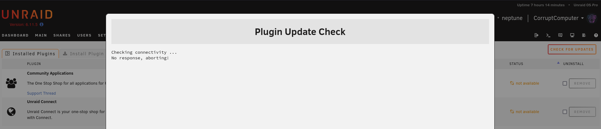

I've been dealing with this problem for a couple months now and I didn't realize that it was a more widespread issue. I have had this Unraid server deployed for a long time now without having any network related issues, but in March (with no changes on my end) it started acting up. However, when I enable IPv6 everything works without issue.
So what I have been doing for months now, is when I need to update my Plugins and Docker containers I will enable IPv6, update those, then disable IPv6 again. Currently on Unraid 6.11.5 and Unraid Connect version 2023.05.01.1138. Using NextDNS for my DNS with a fallback on Cloudflare as my third DNS server, and looking through my NextDNS logs nothing is being blocked that would be needed for Unraid to work properly.
The weirdest part of it all is that when I go to the Unraid Connect website I can see that it shows my server as online, however when I go to my server these just show as 'not available':
I've attached my servers anonymized diagnostics, if needed I can privately send an employee of Limetech the full version of it.
This area of the forum is for support with Unraid Connect specifically. As you are having general networking issues, please start a new thread under General Support where a lot more people will see it.
