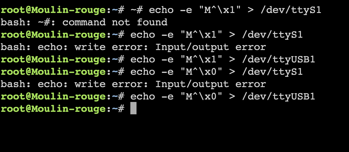

But you can run these to turn off the screen 1 = on 0 = off so you could run as a user script on a schedule.
root@QNAP:~# echo -e "M^\x1" > /dev/ttyS1
root@QNAP:~# echo -e "M^\x0" > /dev/ttyS1
Hey is there a newer version of this code to turn off the screen?
I've got a usb crystalfontz off ebay. not getting anything with the quoted code.
My device is on: /dev/ttyUSB1
1861073739_Screenshot2024-03-04at20_39_15.thumb.png.aec9daca40770cbea770260d91cde5fe.png

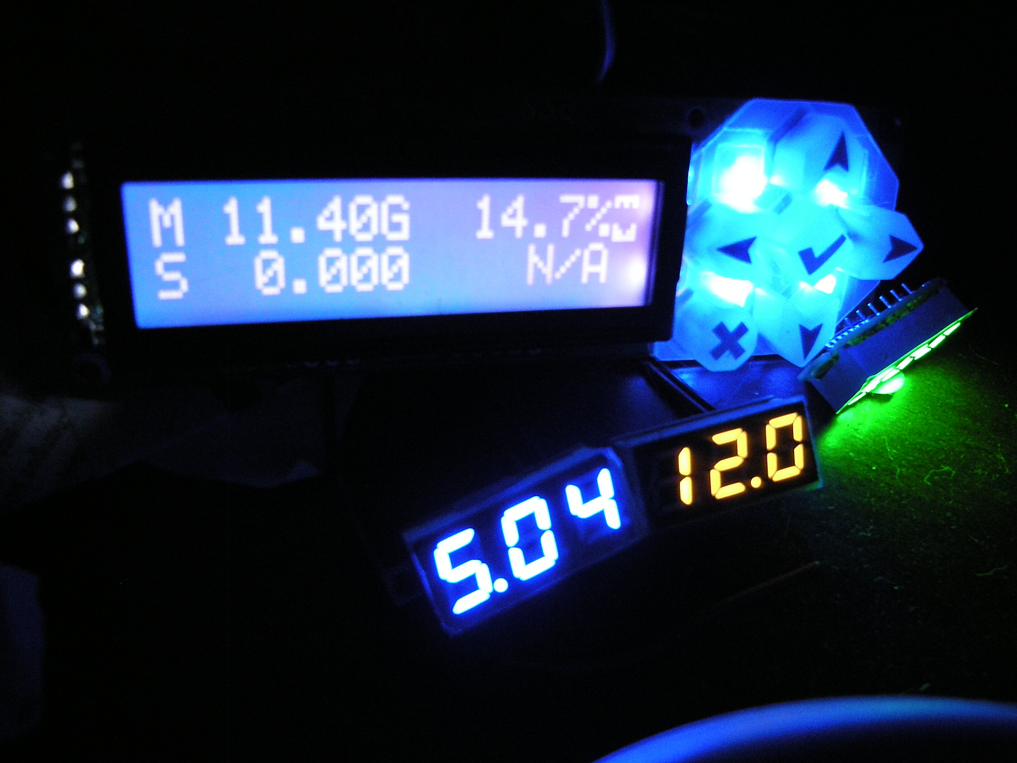

  • Oh @SimonF, look what you've made me do...     This is a HD44780 2004 display hooked up to a Arduino Nano that I had lying around connected via USB to unRAID (sorry for the poor

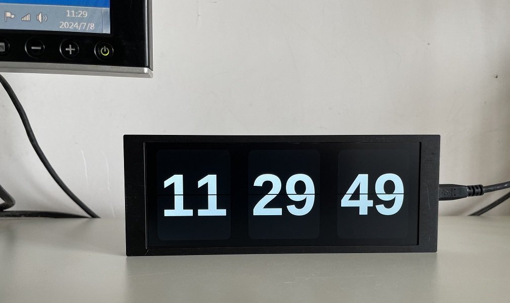

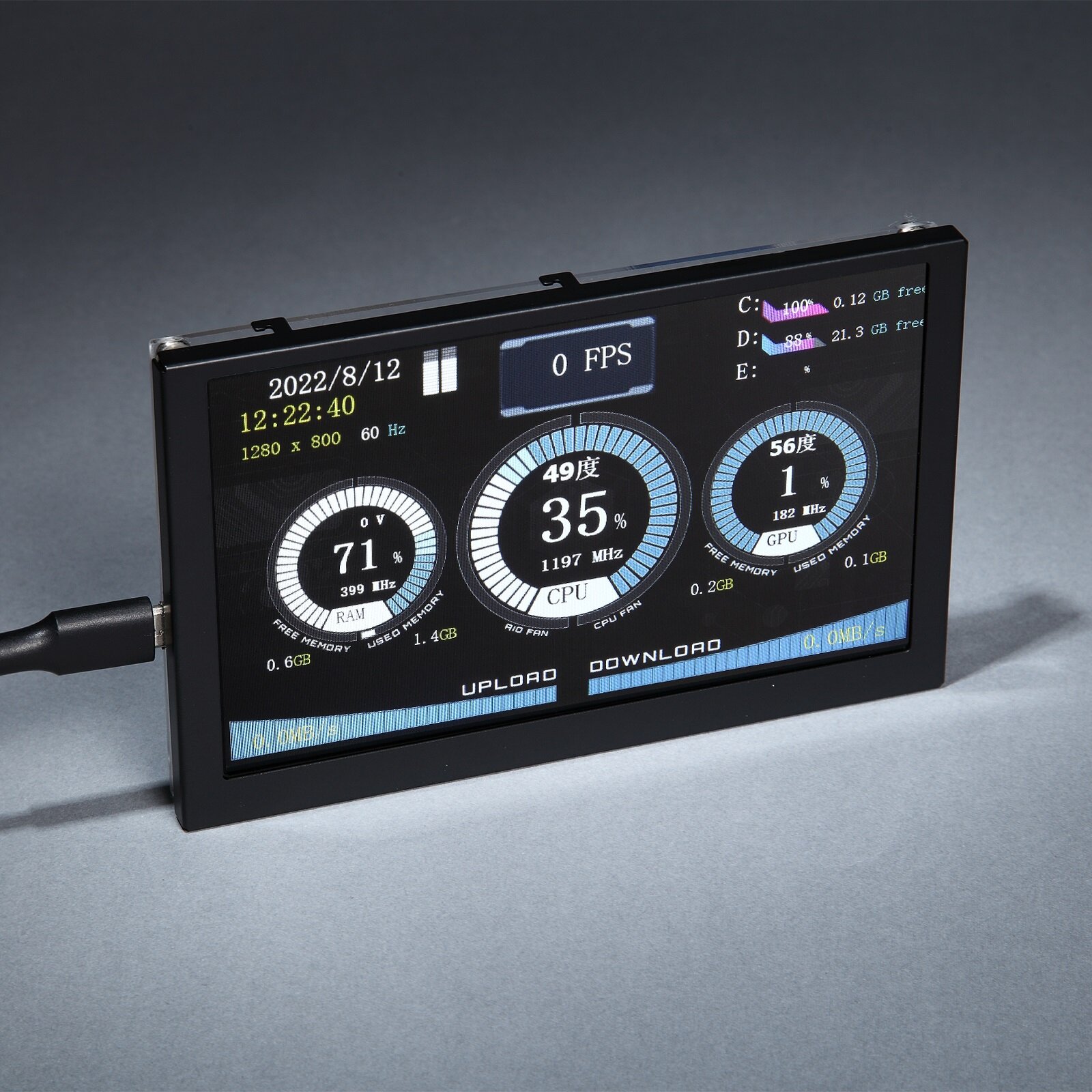

Is it possible to add support of BeadaPanel USB Display? This product has a wider range of screen sizes and form factors. Product WiKi
