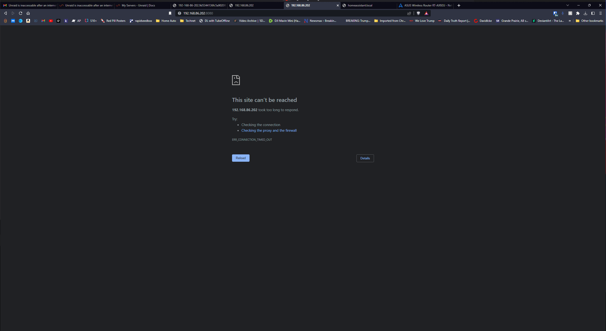

April 8, 20233 yr I'm sorry If this has already been asked, I've been searching through the forum and tried a few things but nothing seems to be working.} My ISP has been doing some upgrades overnight and in the morning the unraid sever is inaccessible. Any suggestions on how to fix this? Also, with the server being inaccessible how am i supposed to safely reboot the server?

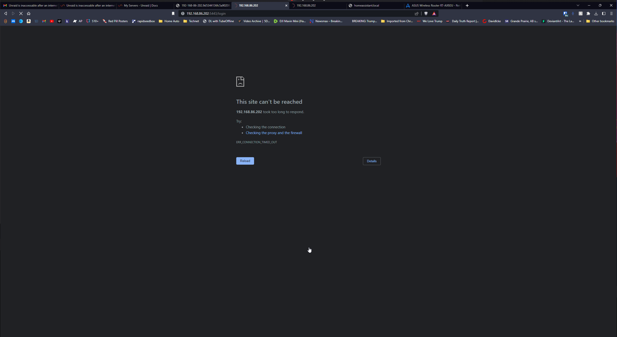

April 11, 20233 yr Author On 4/8/2023 at 12:52 PM, JonathanM said: https://wiki.unraid.net/My_Servers#How_to_access_your_server_when_DNS_is_down This didn't work, I'd like to add that my issue is AFTER an outage not during an outage Edited April 11, 20233 yr by mrclean5953
April 12, 20233 yr Author 6 hours ago, JonathanM said: What address are you using to access the server? I'm trying all the ones listed on the management access page

April 12, 20233 yr Author 9 minutes ago, ljm42 said: Sorry, it is very unclear what the problem is. Screenshots may help Now I'm really confused : ) if you can access the Management Access page, doesn't that imply you have access to the webgui? The internet has been dropping at my house, by the time I get home my internet is back up and running, but I cannot access the unraid server without rebooting it. I can't access the management access page. I copied all the listed addresses and have tried them all.

April 12, 20233 yr Author 2 hours ago, ljm42 said: BTW, back on step one... I see you tried accessing the server by IP address, are you sure the IP address didn't change? The instructions recommend using https://[servername].[localTLD] because there is a good chance that will work even if the IP address changed. The default servername is "tower" and the default Local TLD is "local". So if you are using defaults the url for step one would be: https://tower.local or https://tower.local:SSLPORT I've got a static ip set in the router. I was also trying tower.local and tower.local:sslport I had to restart the server manually as nothing was getting me in. I also checked the router and the server wasn't being seen but the router.

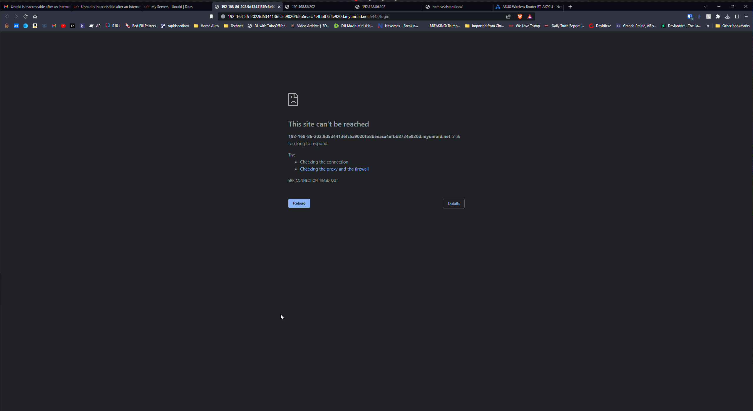

April 12, 20233 yr The usual issue when your Internet connection goes down is that your clients are unable to do a DNS lookup on 192-168-86-202.hash.myunraid.net and therefore they can't reach the server. The server itself is not broken in this case, it is just that the clients can't reach it. This fix for this is to use a url that doesn't need to do a DNS lookup. Depending on your settings, you may need to disable SSL in order to use a url that doesn't need DNS. This is the process described here https://wiki.unraid.net/My_Servers#How_to_access_your_server_when_DNS_is_down Rebooting the server would have no effect on this as it is an issue with the client not being able to do DNS lookups. The server itself is fine. I have never encountered a situation where the the server stops responding when it loses Internet access. You'll need to start disabling things to track down the culprit. I'd start by booting in safe mode, which disables all plugins. If the server doesn't have issues when the Internet goes down in safe mode then you know a plugin is responsible for the issue. Another option would be to disable the Docker service to determine if one of your Docker containers is causing the problem.
April 15, 20233 yr Author On 4/12/2023 at 12:17 PM, ljm42 said: The usual issue when your Internet connection goes down is that your clients are unable to do a DNS lookup on 192-168-86-202.hash.myunraid.net and therefore they can't reach the server. The server itself is not broken in this case, it is just that the clients can't reach it. This fix for this is to use a url that doesn't need to do a DNS lookup. Depending on your settings, you may need to disable SSL in order to use a url that doesn't need DNS. This is the process described here https://wiki.unraid.net/My_Servers#How_to_access_your_server_when_DNS_is_down Rebooting the server would have no effect on this as it is an issue with the client not being able to do DNS lookups. The server itself is fine. I have never encountered a situation where the the server stops responding when it loses Internet access. You'll need to start disabling things to track down the culprit. I'd start by booting in safe mode, which disables all plugins. If the server doesn't have issues when the Internet goes down in safe mode then you know a plugin is responsible for the issue. Another option would be to disable the Docker service to determine if one of your Docker containers is causing the problem. I disabled the docker container binhex-qbittorrentvpn and all my issues went away
