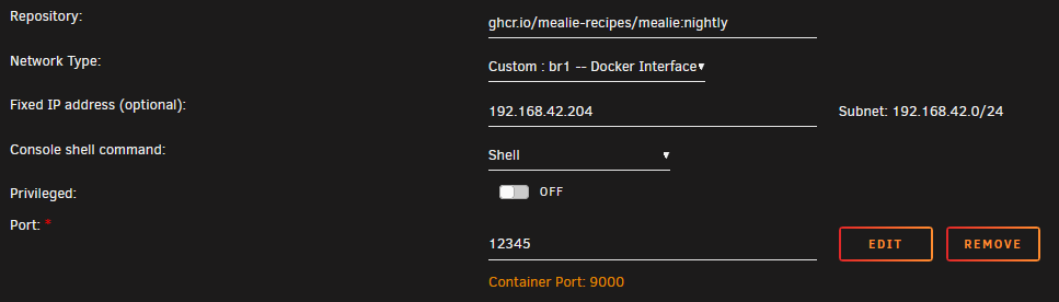

I've recently installed this docker container and also noticed it was still on the nightly tag. Can I easily change it to latest now?
I changed to latest awhile back. For some reason I had to backup and download recipe database from mealie. I had to remove the docker fully and then reinstall and remove ":nightly" from the template. Then restore from backup file. Not sure why I couldn't just drop the ":nightly" but you could try this way first.
I wonder if it is because the nightly you were on was newer than the latest. That is, maybe switching to latest actually downgraded you.
I'm thinking to wait when latest surpasses the nightly, but I'm not sure where the best place to check the versions getting pushed under each tag for the official mealie would be. This way the tag change will be like a normal update....not sure if this is correct line of thinking.
When you say backup and download the recipe database; are you referring to some internal Mealie backup feature, or a postgreSQL backup?
Yes use the internal mealie backup. Go to Settings---Admin Settings---Backups (This will appear on the side bar on top left side). Create backup and download. This is the same screen to restore the backup also.
I tried to wait for a long time till the versions lined up but it never happened. As long as you have the recipe backup file you should be good. Did you try just removing the ":nightly" from the repository?
Thank you for the reply and information! I did the backup and download, but then went digging into the tags, and I think I got lucky!
I intentionally haven't updated my nightly instance in about a week, and I saw this below (as of today Apr 18, 2026). The latest tag was pushed to 3.16.0 and was published very recently; meaning the latest tag is now newer than my non-updated nightly package.
I was able to simply stop the container > change tag to latest > spun up again successfully....doing this it was like updating the image. I think the issue exists if your nightly is newer than the latest
