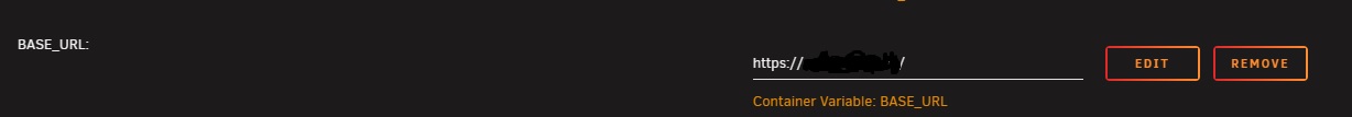

Installed Mealie and setup reverse proxy.  Going throught the site settings under configuration  and I have a red triangle that says:
Server Side Base URL
`BASE_URL` is still the default value on API Server. This will cause issues with notifications links generated on the server for emails, etc.
FYI Test email works and I did have to change the 9000 port which was already in use.  How can I fix this error?
I had to add a variable in the mealie docker settings for BASE_URL with the url used to get to my instance.
Edited by Dent_
Thanks @Dent_ this has fixed me up!
Hey guys! Sorry about that. I updated docker file to add that variable by default. So going forward others will not have that issue.
And yes, you probably need to change port 9000, but we think its best practice to let you pick which port.
@Gragorg and @Dent_, template updated today, so that should not be needed to be added anymore. I left it as an optional field. Should be good!
