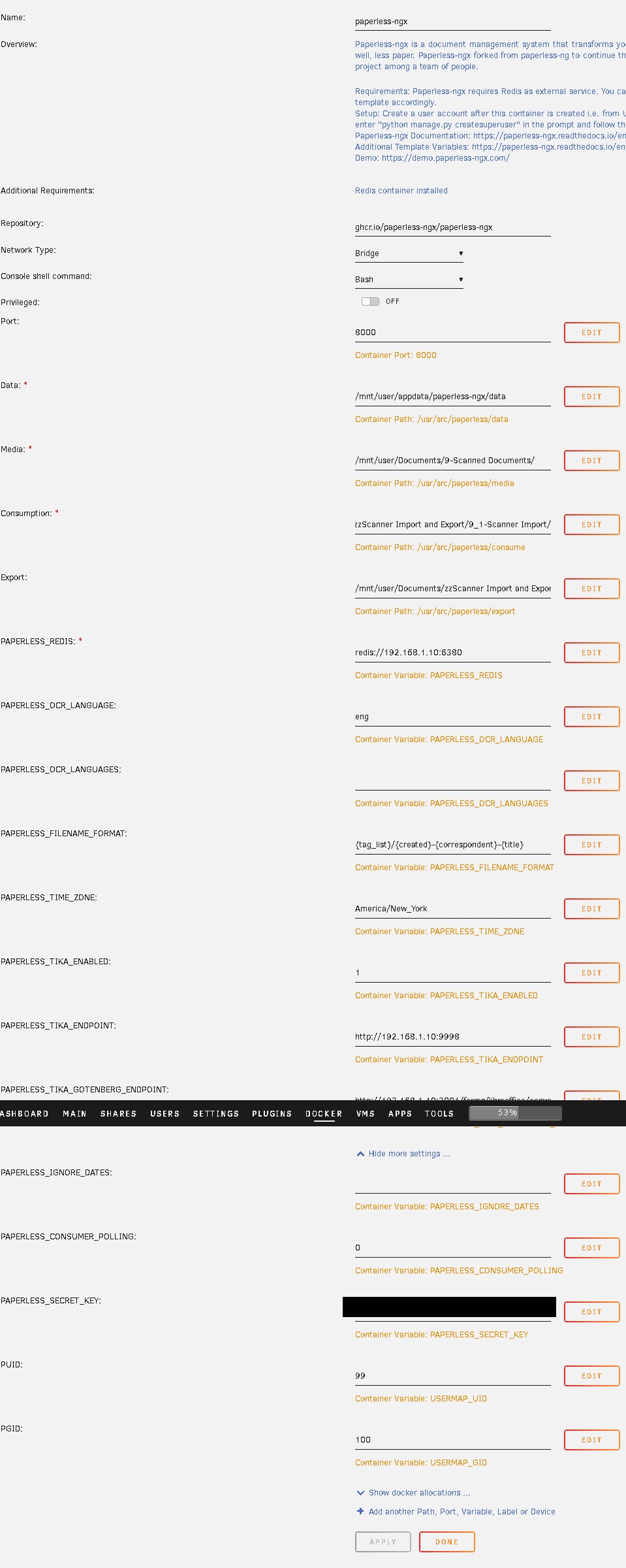

  24. Thanks for the reply. Yes, I have started using an Inbox tag as well, and I understand how this can help in the workflow. I still don't see how I can do what I ideally want, in the context of going through a substantial backlog of docs that might already be organized. As a workaround, I think I'll try: cleaning out all my inbox items to get to a baseline creating subfolders aligned to tags outside of the import folder scan directly to these staging folders manually drag each subfolder's contents in 1 by 1, and then mass tag them in the UI I think this will add some efficiency for me. I think I'll go add a feature request as well for what I really want: >1 import folder that can be assigned to tags/metadata or an alternative solution.
  25. Basic question, couldn't find answers on the project page: Is it possible to import and assign tag at the same time? This is instead of the 2 step process of 1) Import, 2) go into the UX to click and assign tags For instance, if I scan a whole big pile of docs that should have the same tag, it seems inefficient to go and manually tag them vs. assign them more automatically at time of import. ex: setup >1 import folders for each tag? Is this possible or are there other approaches I should use?
