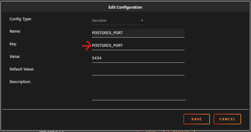

Been trying to get this docker going again and thought I would point out that the POSTGRES_PORT key has a space at the begining that causes startup to ignore port #. It does not appear to be a problem if you are using the default port but, if like me you are using a non default port number it ignores and uses default of 5432.
Thank you, I am using default port. I'll update the template. it should be fixed shortly.
5 hours ago, Dent_ said:
Been trying to get this docker going again and thought I would point out that the POSTGRES_PORT key has a space at the beginning that causes startup to ignore port #. It does not appear to be a problem if you are using the default port but, if like me you are using a non default port number it ignores and uses default of 5432.

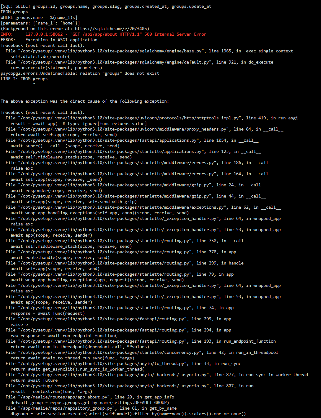

I'm just getting a blank page on my fresh install using postgres14. I see this error in the logs. Anyone know what I'm doing wrong?
@Gazeleytry not using post
Try not using postgres
