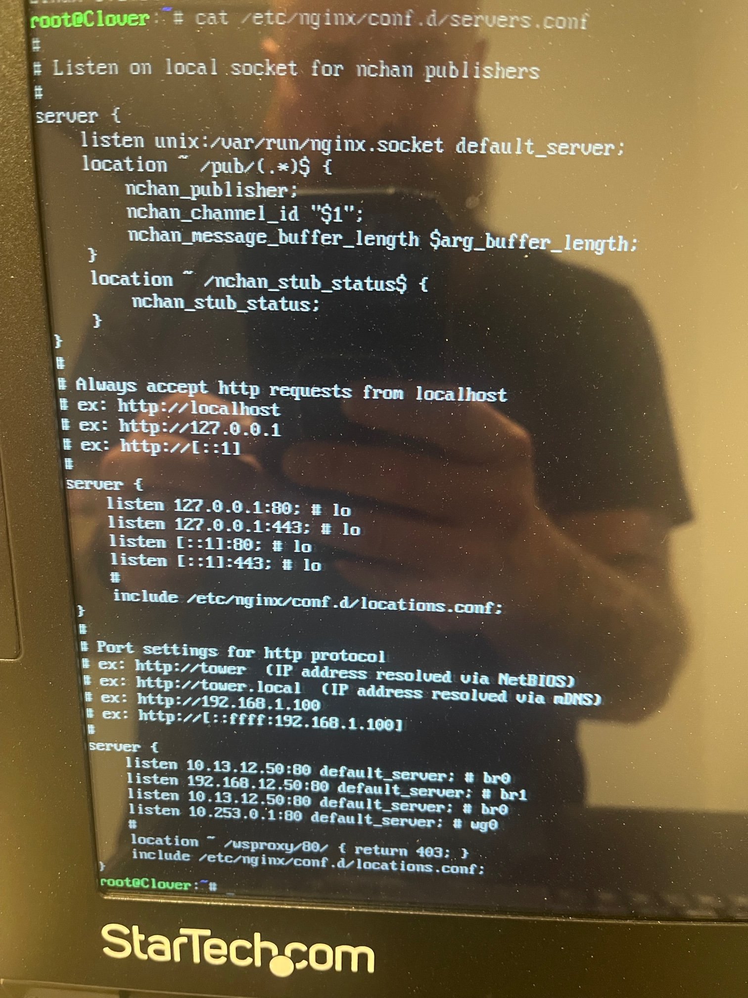

Would you mind typing:
cat /etc/nginx/conf.d/servers.conf
and copy/pasting the result back here?

My appologies, I only have a KVM hooked to this server, no SSH. Hopefully this picture of the report will work.

Your issue is a double IP assignment.
Both the "Main" interface and "NIC 2" interface have the same IP address: 10.13.12.50
You need to assign unique addresses, e.g. NIC2 = 10.13.12.51

So, I think this may have to do with a problem "Fix Common Problems" keeps telling me about. I have 2 NICs currently but, used to have 3.
eth0 - 10......
eth1 - 192.....
The removed one was 10.13.12.50, and I changed eth0 to take over the removed pcie fiber card. FCP tells me eth2 has the same IP as eth0 but, eth2 is no longer installed. Would I have to install eth2 back into the machine to fix this issue?
Edit /boot/config/network.cfg and remove this part:
IFNAME[2]="br2"
BRNAME[2]="br2"
BRNICS[2]="eth2"
BRSTP[2]="no"
BRFD[2]="0"
DESCRIPTION[2]="Clover Nic 2"
PROTOCOL[2]="ipv4"
USE_DHCP[2]="no"
IPADDR[2]="10.13.12.50"
NETMASK[2]="255.255.255.0"
Also change SYSNICS="3" to SYSNICS="2"
Then reboot.
