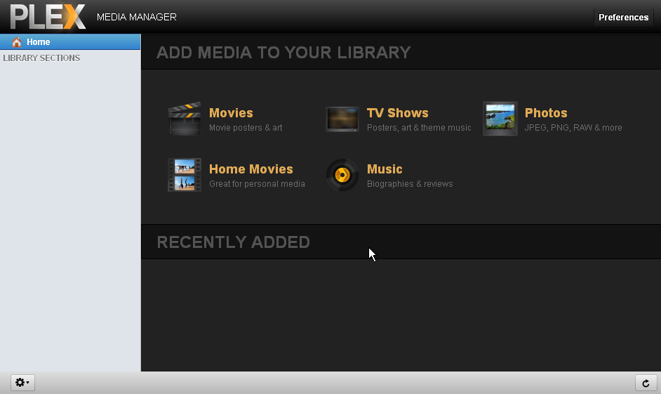

I have Plex 0.9.5.1 installed via the plugin, but when I start the Plex Media Manager, I can't configure the Library Sections to point to my media.  It's as if the page is read-only.  No "+" or "-" buttons in lower-left corner.  Any suggestions on what I might be doing wrong?
unRAID Version = 5.0-beta13
Browser = Firefox 3.6.23

have you tried those big buttons in the middle of the page?
(below the headline "add media to your library"...)

i believe, they removed those + and - buttons when adding the new "home" page.
you can only add a section from this page.
the little "gear"-button on the bottom left is only active when you are inside of a section.

The big buttons don't have any effect.  When you hover the cursor over them, the cursor changes to a finger pointer.  But as soon as you click, it turns back to an arrow pointer.

i guess it has something to do with the browser you are using or some extensions...

Try a different browser. A script or pop-up is probably being blocked. A window should come up where you can add you media folders.
