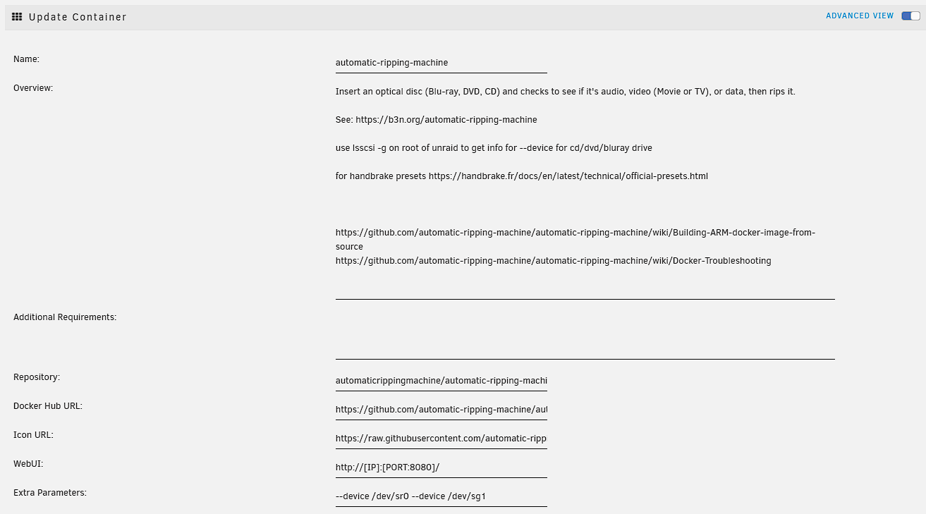

I'm trying to set this up but when I try to install it I get this error: docker: Error response from daemon: Unknown runtime specified nvidia.
Am I missing something?
Cheers
This took me a while to work out, I was about to just give up.  So, my server has an old (and I do mean old) nVidia Quadro card - something I do mean to change at some point but that's a seperate issue.
So, first thing I did was install the nVidia driver from the Apps section of Unraid - even though my card is not supported.  This allowed me to install ARM, but not run it (not a surprise that it wouldn't run - as I said the card is not supported).  Then, I went back to my docker containers and edited the installed ARM container - in the top right I enabled advanced view (clicking the basic view text to switch mode).  After this I went down to the Extra Parameters and remove the --runtime nvidia flag - see my screenshot below.  This left just two --device parameters.
And, with that done - ARM is working again!  Now I do intend to try this again after removing the nVidia driver and the ARM container - honestly I am not sure if I can enable the advanced view to remove the --runtime flag during install, so I want to check - plus I don't want a useless driver installed ;)
EDIT:
Just checked with a separate app, and when doing the install you can go into advanced mode - so the whole nVidia driver thing is not required at all.
Edited by iJacks
Added findings

Well, actually this turned out to be a pretty easy fix.  It only took somewhere around 16 hours of trial and error to find...
It seems the Music / music folder thing can cause problems during the container creation.  If there's a music folder already in the directory the scripts will halt because it cannot delete the folder...  I don't know exactly how to explain it but I was able to replicate it a whole lot with a virtual machine.  It was actually in the log I posted below from the beginning but it took me far to long to realize that was the problem.
I'm not too good at this here Linux stuff.
I cannot get this to work at all.  I left the container config at default except for removing the nvidia runtime and adjusting the cd/dvd/bd drive parameters.  Everything appears to be successful and the container will start but I cannot get to the webui no matter what ports I try and inserting a dvd doesn't do anything.
ARM log below:

The most recent updates have caused this, has happened before - no idea what causes it nor how to fix it.  Last time it was sorted in an update a few days later.
Now that I have a working ARM container, can anyone tell me how to go about adding custom Makemkv profiles to it?  I can't figure out what directory the custom xml file should be in. I was/am expecting to find the default.mmcp.xml file somewhere within the ARM container files but I cannot.   I'm not sure if I just need to create the profile and appropriately reference it via the MKV_ARGS:  option via the webui ripper settings / arm.yaml file.
Thanks in advance
Ok, not so an easy fix for me - as removing the Music folder to the sum of nothing ;)  But your response did point me in the right direction :)
However I decided to start doing some diggy diggy hole...first by removing all of the media folders, then by removing the root folder for my ARM share.  Still nothing...was about to just give up, but then I noticed that there was 1 extra mapped folder:
/home/arm/logs/ => mnt/user/Media/ARM/Logs
/home/arm/media/ => mnt/user/Media/ARM/Video
/home/arm/ => mnt/user/appdata/ARM/
/home/arm/Music/ => mnt/user/Media/ARM/Music
/etc/arm/config/ => mnt/user/Media/ARM/Config
So for anybody else that gets this issue, chances are one of your mapped folders has messed up permissions and it causes the script to fail.  Sadly, for me at least, the script did NOT tell me what folder (or file) was the cause of the problem.
With regards to MKV profiles, as far as I am aware you do indeed only need to create said file and then add it to the MKV_ARGS option in the arm.yaml config file.  The path will be relative to ARM's Docker setup and the sample they include (MKV_ARGS: "--profile=/opt/arm/default.mmcp.xml") would not be visible externally by default.
Ngl, that project in docker is a frigging mess. You fix the permissions and with the next miniscule commits they screw it all over again...
How do ppl handle this "outside setup" that is described it the manual?
Did you just run the docker-setup script?

It's permissions - the "db" directory is owned by root.
You can open a console to the ARM docker container and do a:
chown arm:users /home/arm/db
You shouldn't even need to restart the container - the web ui will now start.

Do you have the Nvidia driver installed?
On 7/27/2024 at 3:59 AM, te5s3rakt said:
This is the configuration I'd prefer also. Being to just place the disc in, and a copy of it as iso appears on my array.
Anyone know how to set this up?
Should be able to just change RIPMETHOD: in the ripper settings to backup instead of mkv
yes I have the Nvidia driver installed.
