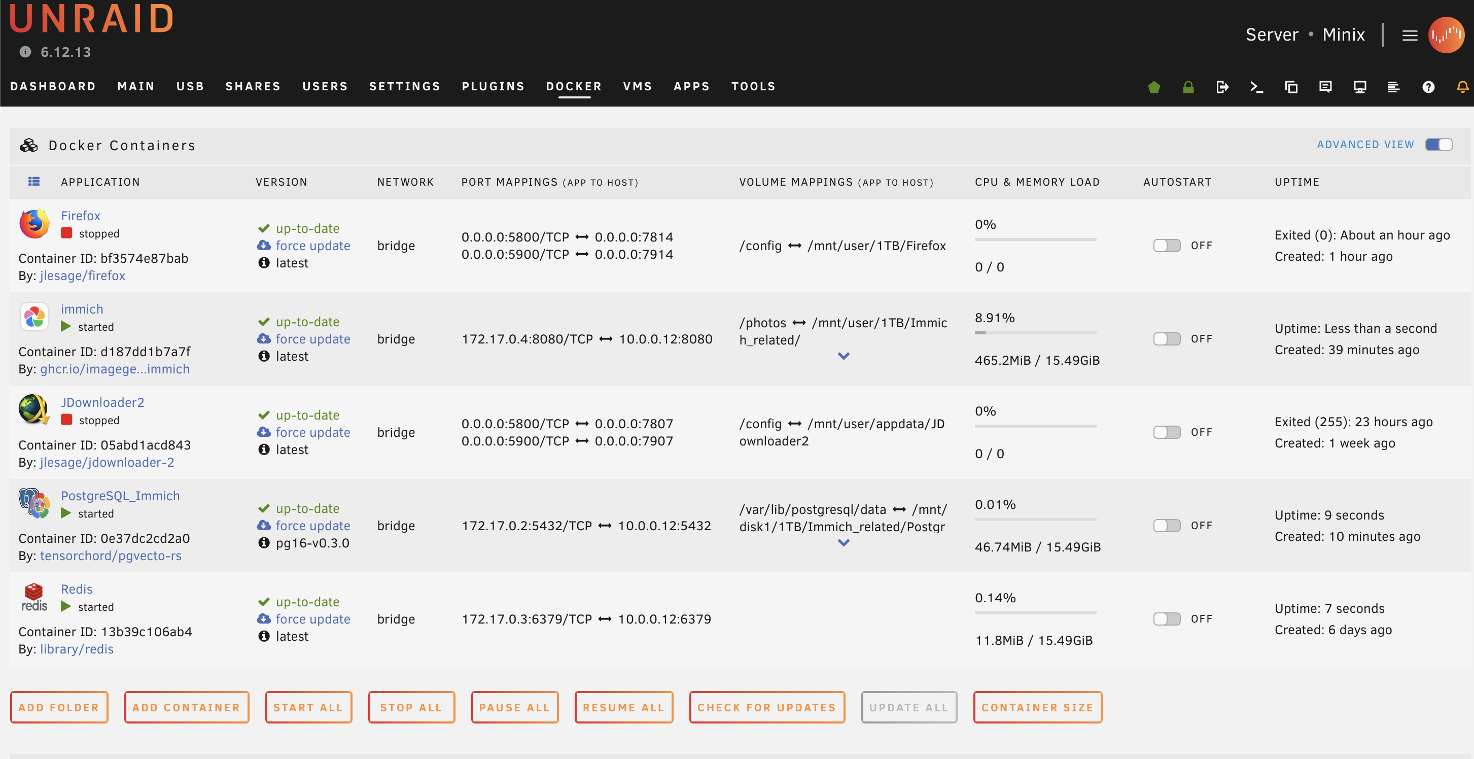

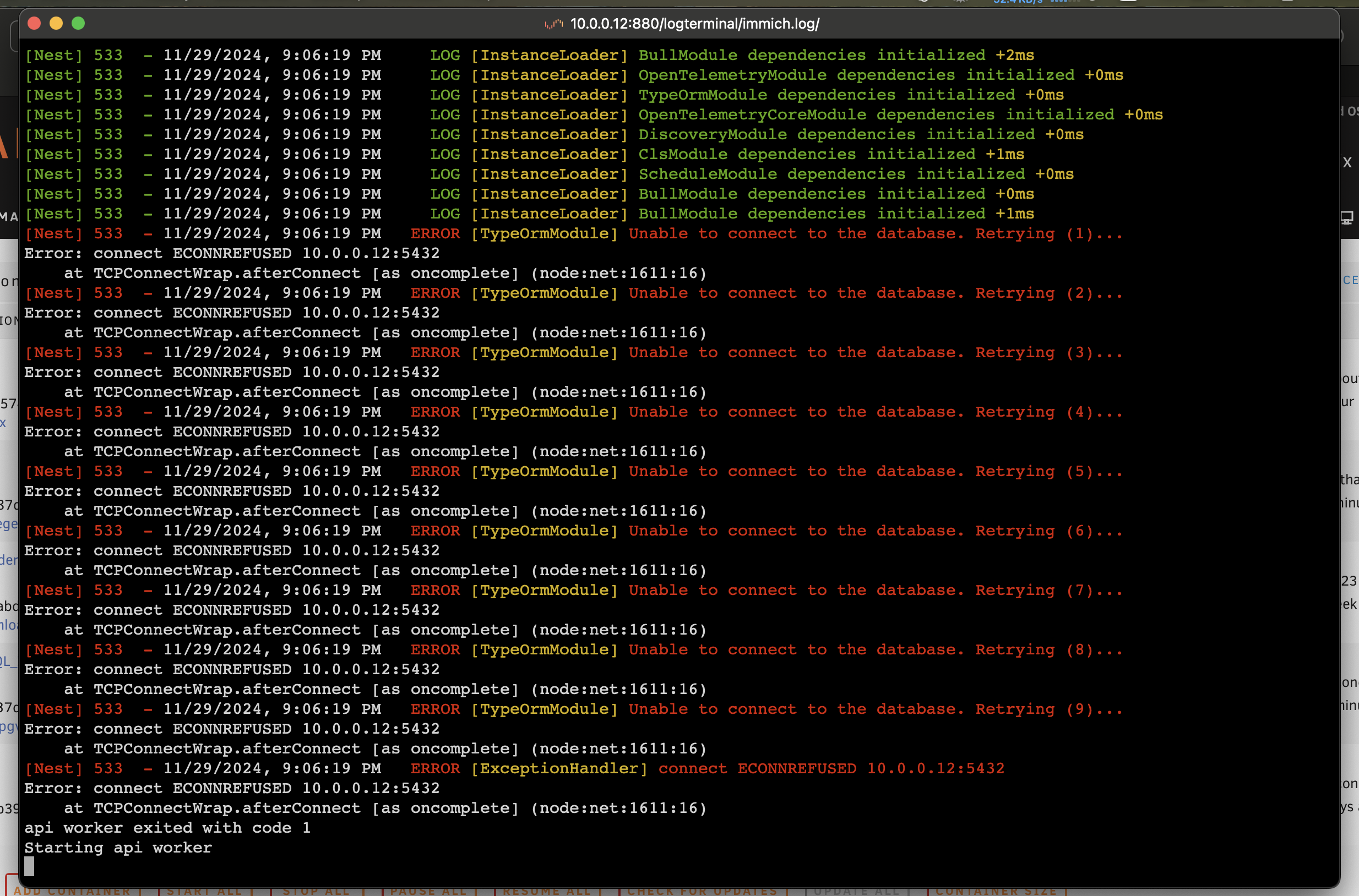

Hello everyone! Can please someone help/advise on how to resolve this issue. I have been searching on forums and on Google, without any luck. I think I have followed all instructions from Space Invador One's tutorials and other YouTube videos but can't figure out why immich is not connecting to databse.
@ahror get into the console via the Immich docker, use the command line version of sql connect and manually test out the connection. Your server should have a static internal IP. Like 10.xxxx or one of those 192.168.xxxx then there will be a port to connect to as well. If you can connect via the Immich command line, it should work via the regular docker ways.
@rutherfordThank you so much! Figured it out. Working.
@ahror you should tell folks what you did, more missed, to make it work so someone searching can find your suggestion. Glad you’re up, happy holidays.
